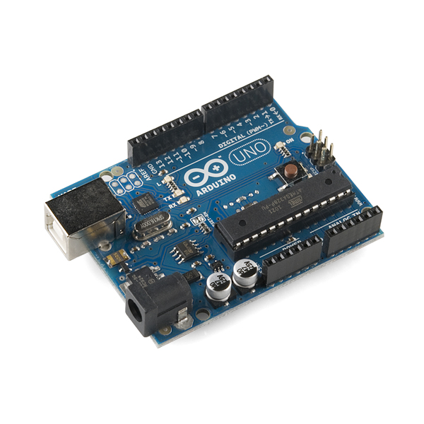

The 10 pin header pins on the left most part of the board J1 - J2. I need to connect some wires to these. What is it that I am looking for on digikey? I want to attach them to an arduino uno that has the female version of these pin headers. What would you suggest or use if you wanted to wire these two devices together. Would help if I knew what they actually called these things. Ideally I would like to have the male and female equivalent w/ crimps on the other end to attach my wires. But I don't have any idea if they even make such a thing.

thanks harald. But, what do they call the female version that would fit over top of the male breakaway connectors? I see I can use the male breakaways, solder my wire to them and then use a piece of heat shrink tubing to keep it isolated for the arduino. Still little confused on the driver board pins, I need a female connector. I am thinking about using these http://search.digikey.com/scripts/dksearch/dksus.dll that way I will have a removable connector with a wire connected to one pin and the other pin still accessible.

After hours of searching I finally found what I was looking for and in the process taught myself something about electronic suppliers and parts. When all else fails ask technical support.
These are the housings of the connectors in the picture that steve posted. On down the webpage you will find a column listed as "Associated products" This is where you will find the crimp on connectors both, pins (male) and sockets (female) , that fit into the housings. So now I can male my own wires of varying lengths with either male - male, female - female, male - female terminations. Gonna buy me a couple hundred now!!!
http://search.digikey.com/scripts/dksearch/dksus.dll?FullDetail&name=A26962-ND#matingproducts
