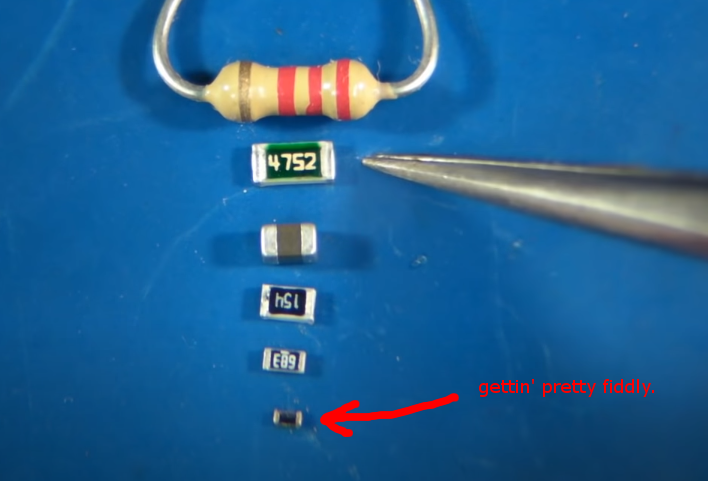

With only 3 legs on a transistor its only ABC,ACB,BAC,CBA,BCA,CAB - 6 permutations, but then you need to test all the polarities, and its fiddly as hell with all the wires going everywhere.
If you buy transistors from a real local electronic parts distributor and not fake ones from ebay then the distributor or Google has the manufacurer's datasheet that shows which pin is which. That is why I buy parts from Digikey and look on Google.
I design and plan a parts layout for a circuit then build it soldered together on a stripboard with the strips cut so that the circuit is compact and there are no intermittent "fiddly" wires all over the place.

Doesnt take many wires for it to get fiddly, programming only requires keyboard and mouse, electronics with the hands is very frustrating for everyone i'm pretty sure.
