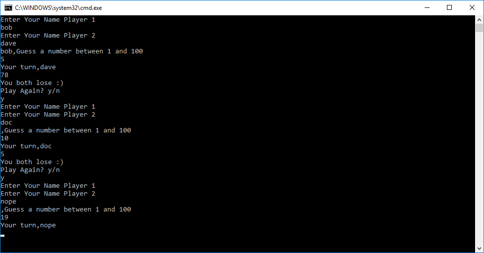

I wrote this in C++ on visual studio 2017.
Code:

Hi,
Remove the semicolon here..
while (restart == 'y');
to
Edit: Fun assignment that one, I had the exact same in the C class a couple months ago :D

Hey so i spoke too soon....its still not looping.
Uhh.. while it's abit wonky it does seem to be looping for me.

Maybe Y vs. y? Your code doesn't contain any checks for plausibility.
You could make the check case insensitive by using tolower():

Y vs y can easily be checked without altering the code: check your input: do you enter upper case or lower case letters?
For debugging it helps simply to output the received input to verify it was read corrrectly. Something like:
Code:
cout << "Play Again? y/n" << endl;
        cin >> restart;
cout << "Character received: " << restart; //for debugging only

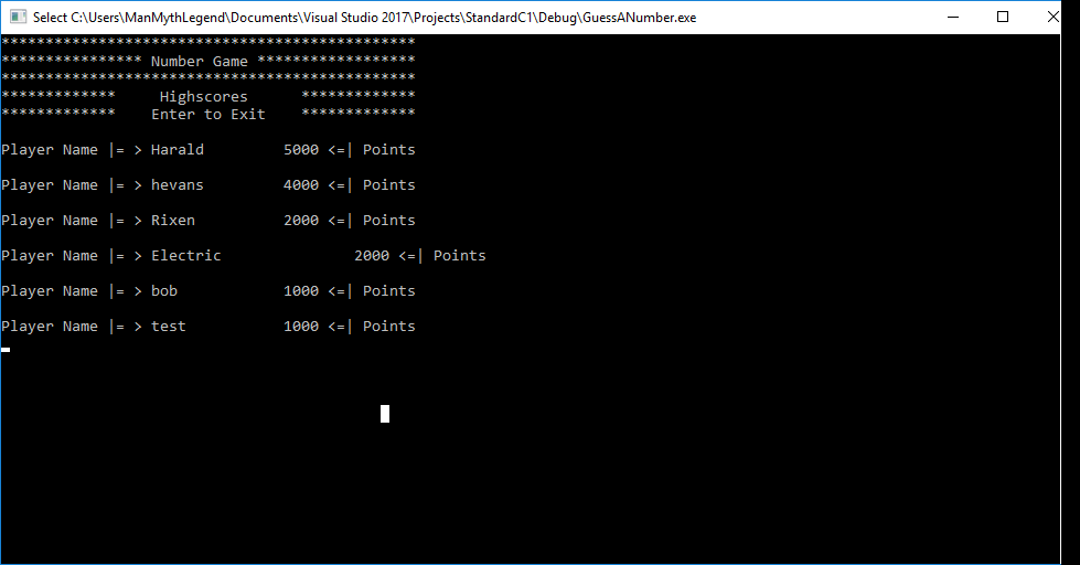

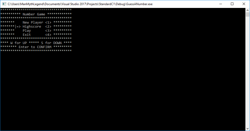

Here was my solution to that similar assignment, written in standard C, it's a really fun one once you get going, the professor jokingly said we could attempt a highscore list.. That was really tricky, with the file handling etc.
but well, I got carried away :)
Maybe you can use this for some ideas..
Edit: You can find really good explanations on srand() and rand() on tutorialspoint.. :)

It was long ago I've programmed in C++, but I remember that I had some problems in context of char/string variables input. More specially, in particular situations some values remain in application buffer and they are "automaticly" assigned to char/string variables.
Unfortunally, I'm not sure how to address that issue (C++ is not the programming language that I'm best at :/ ), but Google is your friend :)
