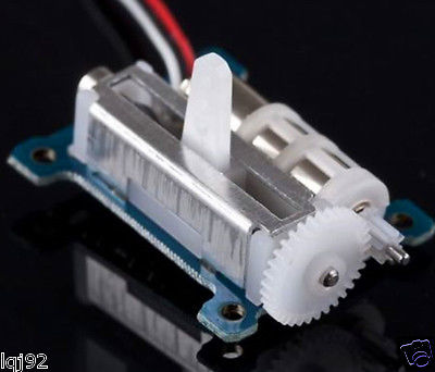

You are much better-off to use a 2gram linear actuator that consumes 30mA @ 3v and is fully reliable.
http://www.ebay.com/itm/1pcs-1-5g-s...269246?hash=item3aada362fe:g:i4YAAOSwu4BVnclM

What are the advantages in using the linear actuators? To me it seems like they wouldn't provide enough force (I can't find how big the radius is) effectively real in the shroud line(s).

As for what can control the shroud lines, my guess is that you will be pulling against some fraction of the rocket's weight. How far do you need to pull them, and how fast?
