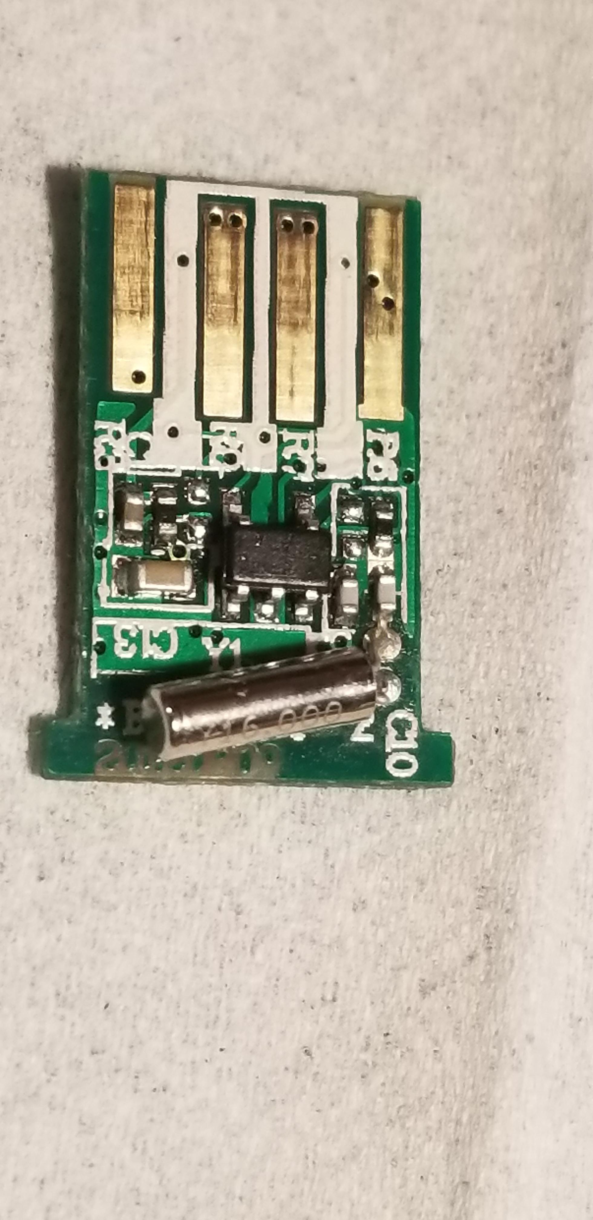

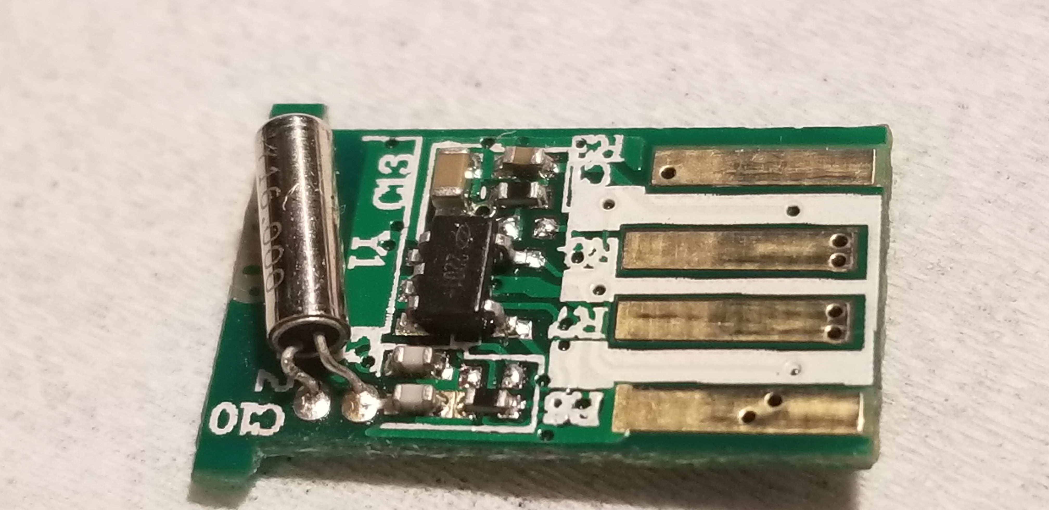

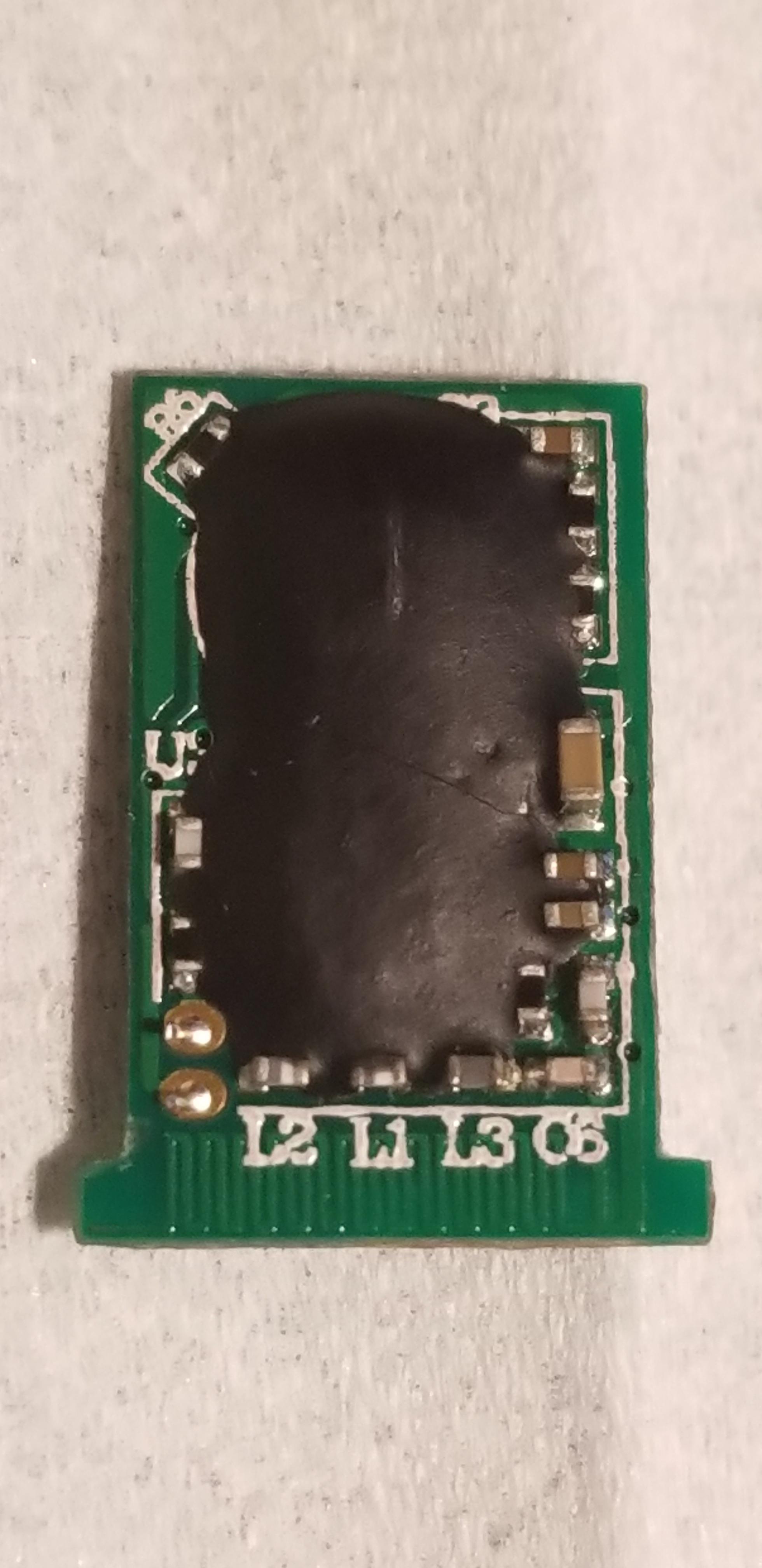

I have an old (a Chinese - not a famed) brand wireless keyboard+mouse which I was quite used to and comfortable with.
Somehow recently it stopped working. The Nano receiver (probably the more common 2.4Ghz) gets detected correctly in Windows 10 and HID Drivers get installed. Onwards the mouse and keyboard are never able to connect to it, i left it for a bit while travelling and found it be non working now. Have tried changing batteries for mouse and keyboard , pressing the connect button, however they never get connected.
Can surely buy a new one, but getting this exact model maybe is impossible. Just wanna know with the expert help around here on the forum, if something can be done to cure it. I am pretty sure its the nano receiver, however i guess each unit/brand is tuned differently and a spare nano receiver in case, wont work with my KB+Mouse.
The combo set model is "TurboX DWLC-6001" (apparenlty only a greek online stories carries them, kinda rare and strange). The nano receiver part number is "g00uf"
Some pics are here for reference
Any help would be appreciated.

Yes just noticed that myself. I couldn’t see the crack on my phone. But now on my laptop, it’s a canyon!.
Martin
So should I be worried about the crack, it could be dry weather and age of this gadget. But even with this in place, it gets detected immediately on Windows 10 and Wireless USB Hub gets detected with following devices

Well seems like i have to bid adieu to a long time trusted device of mine ....aint a good feeling though.....

A crack in the potting/resin encapsulation doesn’t mean the unit is dead. It could be a surface crack.
As you said, Windows detects it.
What about all the other questions?

Yes, sorry I didn’t notice.
Well it sure looks like it’s toast having tried everything. The crack could be stress related on the board and the potting lifted or snapped a component under it. Perhaps it’s time to upgrade to a new combo.
