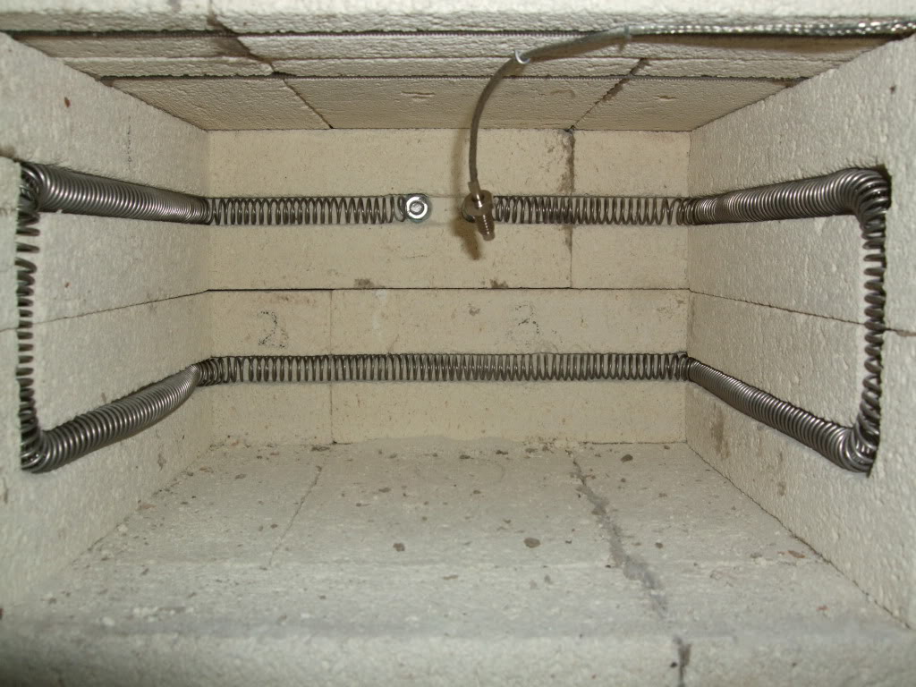

I have just tryed pluging in, in the house, 240V.
This time the output came on for about 20 seconds then power went off, didn't expect that :eek:
Here is a pic of the inside of the kiln, maybe my spirals are too tightly packed, if the spiral touched itself :p would that cause this because there are a few bits that get awfully tight together around corners ect.
Thanks for the links, it is quite a complicated issue, especially as this is my first project in electrics. I will keep trying to understand it.

What country are you in?
What power voltages do you have?
The power is determined by the resistance of the element and the voltage of the supply. If you have 110V and 230V, then run it on 110V which will give about a quarter of the power and half the current which the higher voltage will give.
You seem to have made a neat job of the construction. Quite ambitious for a first project.
In order to reduce the power, the resistance of the element needs to be increased. This can be done by lengthening it or making it of thinner wire. The odd touching turn should not make too much difference although an even spread of turns means that the temperature is uniforn and you do not get hot spots which could burn out. You should try to spread the turns a little in the corners since the heat will not be able to escape so easily from there, At low temperatures, the element may have significant temperature differences along its length but at high temperatures these tend to reduce since radiation is proportional to absolute temperature to the power of four.

Stretching the coil will not add to the length of the wire so will not affect the resistance, I would not mess up your bricks by modifying the element.
You have approx 230V in all parts of your estate, the difference between the on times could be due to the fact that you are probably going through two different breakers.
Note that to get the power that is specified, you need 14A and this is above the 13A allowed from a power plug. When I worked for an electrical power company we were only allowed to pull 8A through a normal socket, this was considered the safe limit.
You have two options:-
1. Add about 50% more wire to drop the current to more like 10A.
2. Connect it up to a dedicated circuit like a cooker supply. This will run up to 30A.

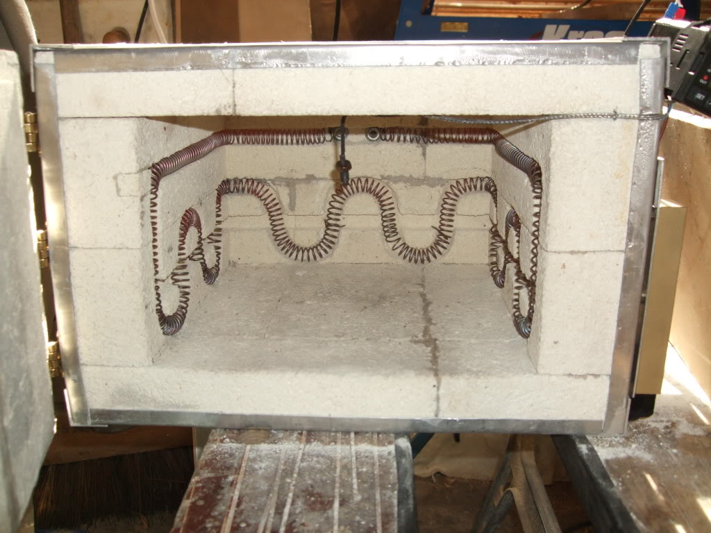

Oh ok, only seen your message now and have already stretched the coil into a longer shape, nevermind its done now and I think it will improve the heat dispersion hopefully.
Will post a pic later.
So the element was 50ft (15m) so I need another 8m(50% extra wire) of heat resistant wire? I have no more room in the kiln for more elements so I assume you are saying add the wire into the circuit on the outside, as in normal wiring.
Please clarify, even after lengthening the circuit then your saying the plug is under rated? Many thanks for your help!

I have just tested it again and its running atm and the power is still on wtf yes!
Stretching it seems to have done it?
Is the output always at 1 level (full power) or should I expect increases in amps?
Heres a pic of the kiln ON! :D
KEWL!

To get a current of 10A you need a resistance of about 25 ohms. Measure the resistance of the element you have and then work out how much extra length you need.
You must not have the extra element outside the furnace as it will get very hot and you will need to put it in an earthed box with a fan to keep it cool.
It worries me that you appear to have one end of your element outside the furnace. This looks very dodgy to me.
Use a digital meter to measure the resistance of the element and let us know what it is.

It appears this is a home-made furnace, right? If so, it looks like you wound your own heating element. You said that stretching the element fixed the problem, so it's possible what happened is that you had some of the element shorted out, reducing the resistance of the load and thus drawing too much current.
Ideally, the first thing to do before winding the heating element is to accurately measure the room temperature resistance. This lets you calculate the resistance per unit length, a useful number to know. Then, after winding the element with a known amount of wire, you'd again measure the resistance to make sure there were no shorts in it. You can make these measurements pretty accurately with two $5 Harbor Freight digital multimeters (i.e., make a Kelvin measurement with a battery).
Personally, I don't like exposed elements like that in a furnace, but sometimes it can't be helped. If you're using it for heat treating metals, then you'll probably be keeping the door closed most of the time. I would make sure there's a safety interlock switch that shuts the power off if the door is opened (use e.g. a double pole relay to shut off both legs of the power). The reason is that it's also tempting to use such a furnace as a forge, meaning you might reach in there with metal tongs to grab a piece of metal. If you touch the heating element in the right place, you might get a fatal shock. I'd also make sure it was on a circuit with a ground fault interrupter breaker or outlet. If you're unsure of some of this stuff, it would pay to have a licensed electrician come in and check things out for you. Sure, this stuff will cost extra money, but the total cost would be much less than a hospital visit or funeral costs.
I don't see a gas connector on it -- are you going to make it into an inert gas oven? That would be nice for helping to keep the scale off things.
