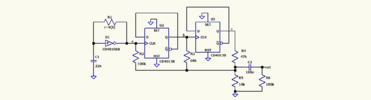

Here's a test simulation circuit for 2 stages, plus the resulting sound file.

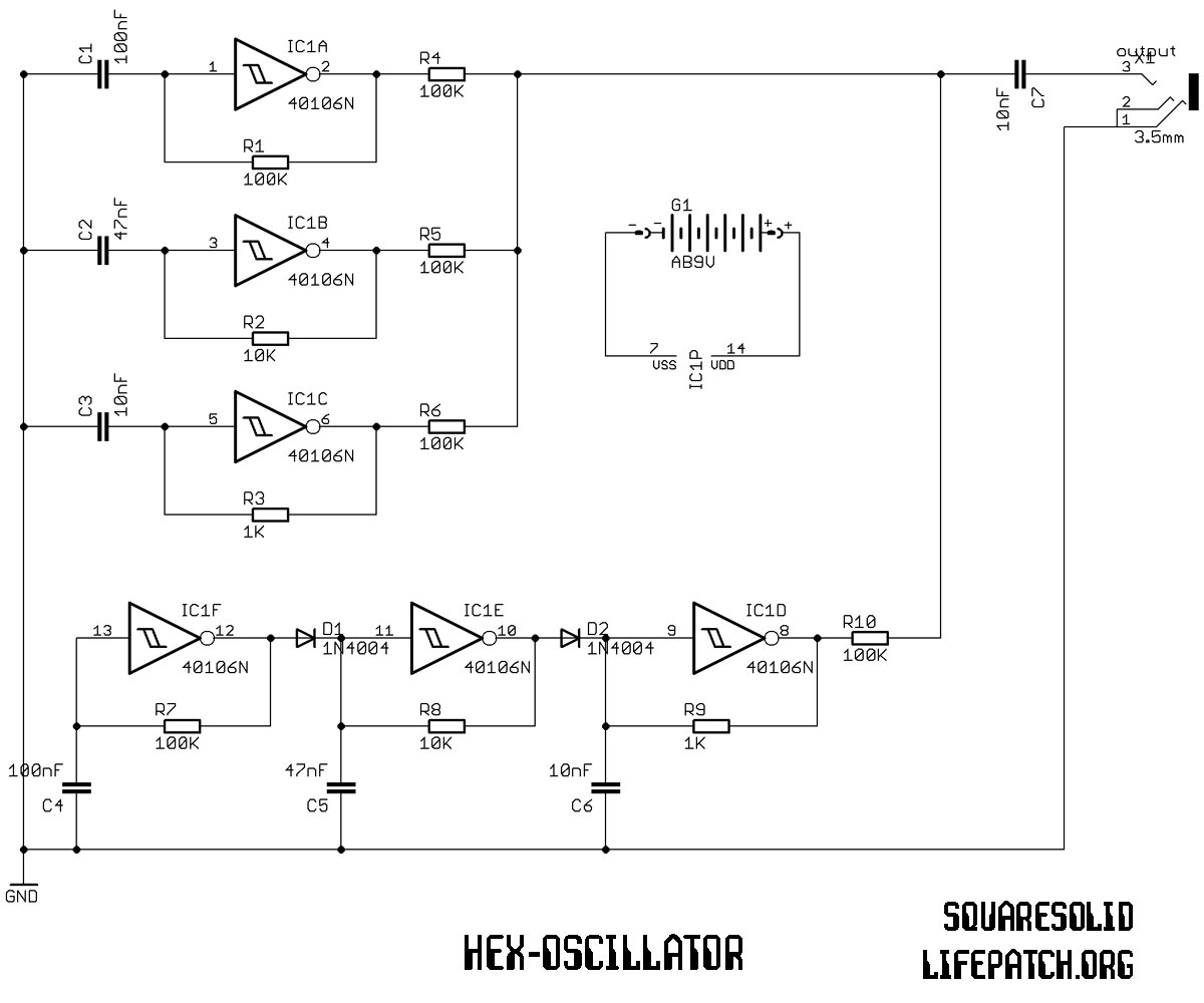

As far as I know a bagpipe consists of a bag with a couple of fixed pipes (drones) and a plpaying pipe (chanter)
You could adapt the Andres Siagian:

Here's another approach for a chanter sound attempt, using one '40106 oscllator and a '4013 forming two divide-by-two stages :
The second divider, first divider and oscillator generate the fundamental tone, the second harmonic and the fourth harmonic. respectively. These are mixed by R2/3/4/5. C2 blocks DC.
Attached is a wav file for the simulation output where the pitch was increased at 2-sec intervals by changing R1..
