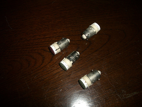

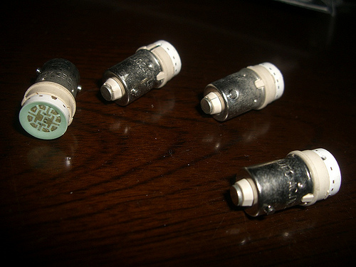

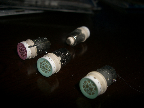

hi everybody, i have a few queries regarding this LED.
may i please know what is the name and type of this LED.
and how do you power it up?
there seems to be no +/- output, only one output.
any help would be much appreciated, thanks.
Resqueline
Jul 31, 2009
2,848
Jul 31, 2009
2,848
Those are ordinary incandescent bulb LED replacements, made to go in a Ba9s socket and run on 24V AC, and they seem to be made by DEC (as marked on them).
The bayonet collar is one pole and the tip is the other btw..
