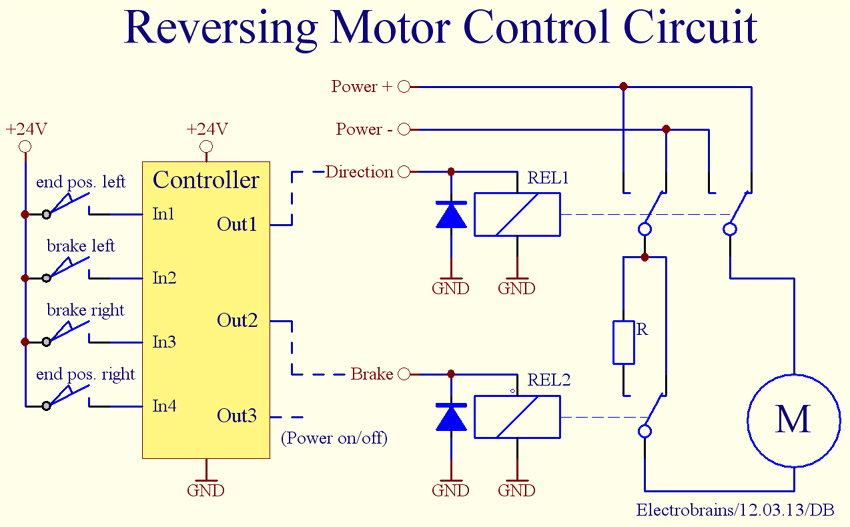

I'm looking for the simplest way to build a gantry that travels back and forth on the X axis only without it being hooked up to a computer. It will be belt driven and controlled by an 18v dc drill motor.
I was thinking about using an "on-off-on" switch at each end of the gantry slide to reverse the direction of the gantry, but I think the motor won't last long if I do that. I need something to slow the motor at each end before it reverses direction.
I've thought about Hall sensor's, 555 timers, limit switches etc., but they seem complicated being that I don't know much about them. Just want something simple.
Any idea's?

You could use two switches at each end.
switch 1 is positioned a short distance before the end of the axis. When the sled or gantry reaches that switch, the motor is slowed down e.g. by switching a resistor in series with the motor.
When the gantry reaches the end of the axis, a second switch reverses the direction. Onnce the gantry has moved far enough from the end, the 1st switch is de-activated, the series resistor is short circuited and the motor runs at full speed.
The same setup for the other end.

I think Harald has a good solution.
Practically, if only for one project, I would use a mini-PLC (you can buy them quite cheap second-hand, for instance a Siemens LOGO, Moeller EASY etc.), a couple of relays and a power resistor as Harald suggests.
See circuit diagram below.
Instead, for the brake function you could switch a resistor in an adjustable power supply, reducing the motor voltage (for instance down to 6V).
That would probably give less power loss and you could do without the mechanical relay (REL2).
For an even smoother but still simple solution, you could add a short stop cycle at the end positions. For that you would need another on/off relay though.
