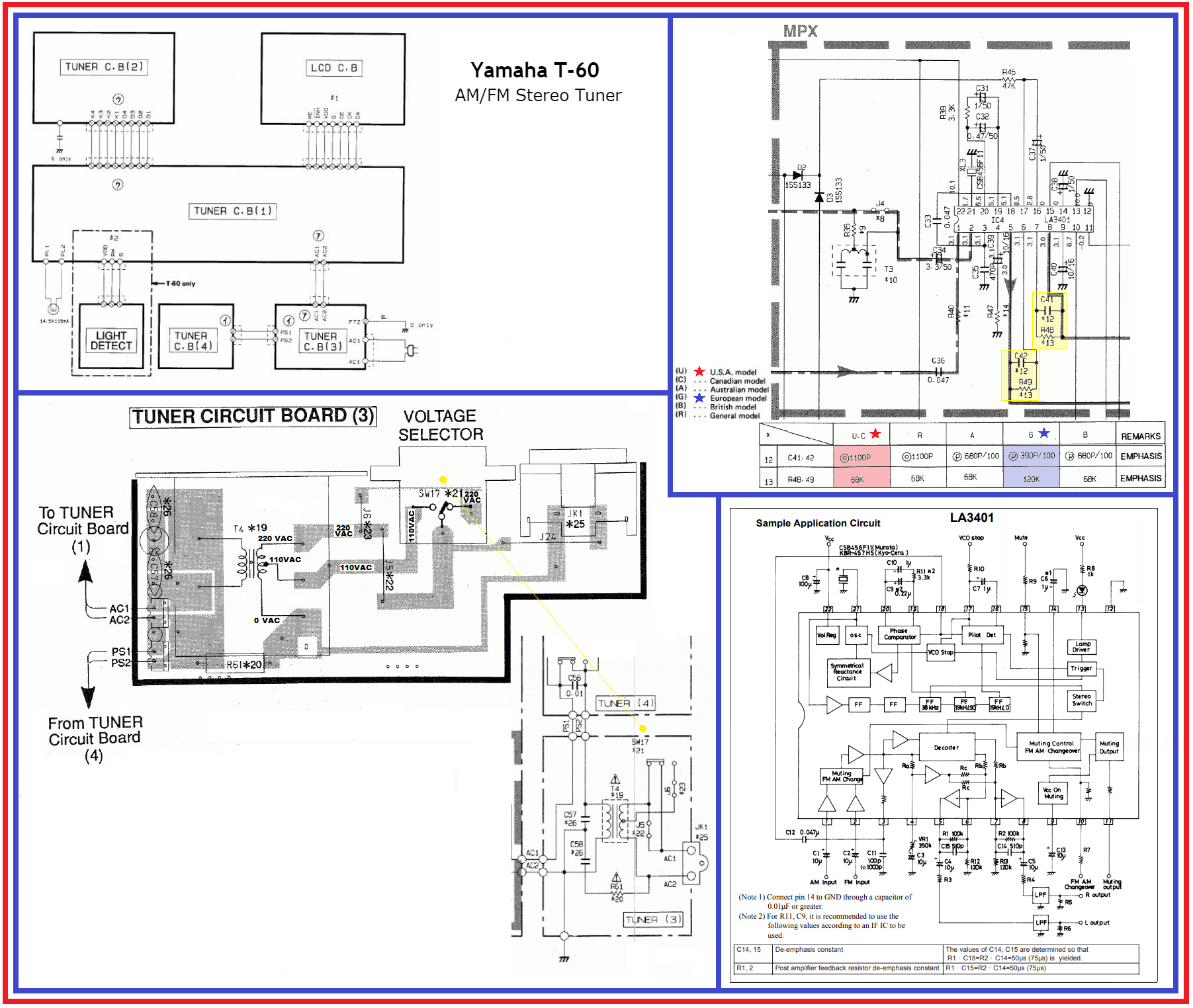

I have an old Yamaha t-60 tuner from a thrift store. When I press the on button it does not light up. I found inside there is a small transformer, a switch and a power part of the PCB. There are two wire wrap posts that clearly provide AC power to the digital display. I checked the voltage and see 13v. In the power section I checked the output of the rectifier/diode IC and it puts out 15v DC. I am stuck at what I should check next.

Sir multimaxfm . . . . .
I'll just bet that you will wait for another 15 years . . .maybe ? . . . . for that specific photo request for that specific, somewhere rare vintage unit.
Here goes . . .
REFERENCING . . . . . .
Top left corner is a block diagram of unit
Bottom left corner is both the board foil pattern and the schematic snippet of the AC voltage switching.
As you can see it suggests that next to the AC power input, is being switch SW17 that shifts the connection of AC line power to the proper primary winding on the power transformer, with its resultant operating continuously for 48 hours per day . . .ad infinitem..
Top right corner is the related schematic for that unit with my PINK and YELLOW highlighting of the relevant deemphasis R and C time constants.
If the unit is still wired Amerikanski or Canada . .oh my Canada . . . it purports 1100 pf caps and 68K
resistors.
Now if you fall under that BLUE star region, you would be using 390pf @100VDC and 120K resistors.
The final right bottom corner info , is just being a full data sheet of the typical application of that LA3401 chip.
Thaaaaaaaaaaaaaats-it . . . .

hey! thank you so muuuch! realy really cool! but i can't get how to change frequency step =) i need to make it non USA to be able to tune and listen 87.5 87.6 87.7 87.8 and so on. What should i do to make it possible? =)

Let's start with finding the audio R and L channel output jacks on the rear of the unit.
Over to their side is a slide switch that I believe will transition between the present 10khz station separation to your needed 9khz interstation spacing for AM, and I believe that will coincidentally correct for the difference on the FM band also..
Try it . . .you may like it . . . . .

the problem is that my model does not have that switch on panel but thas the place on the board, where it is suppose to be. maybe usa model had no this switch?. i saw that is should be accordinary to scheme, but its doesnt in my model. i can make photo later.
