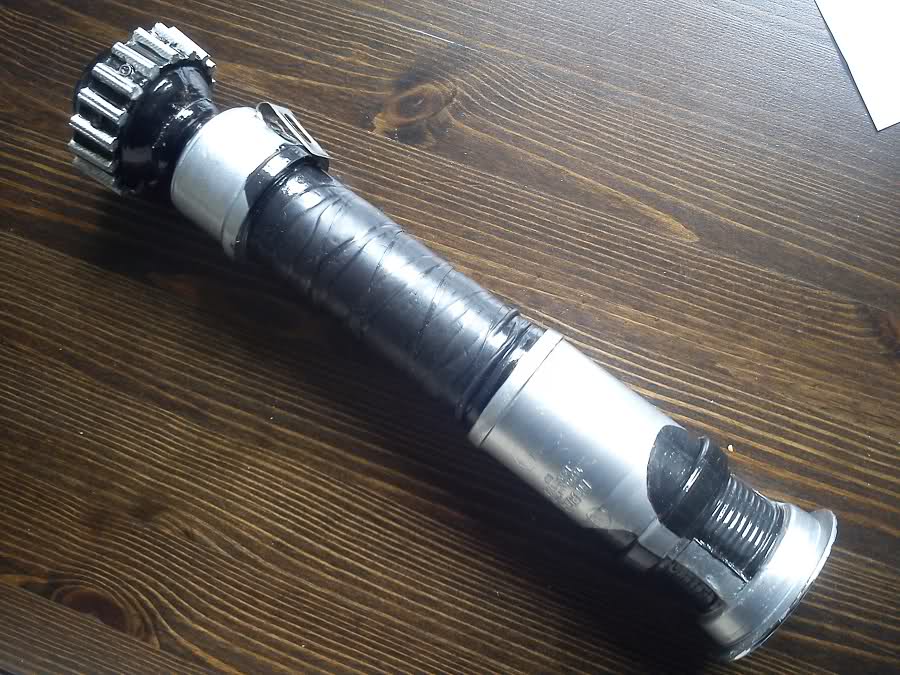

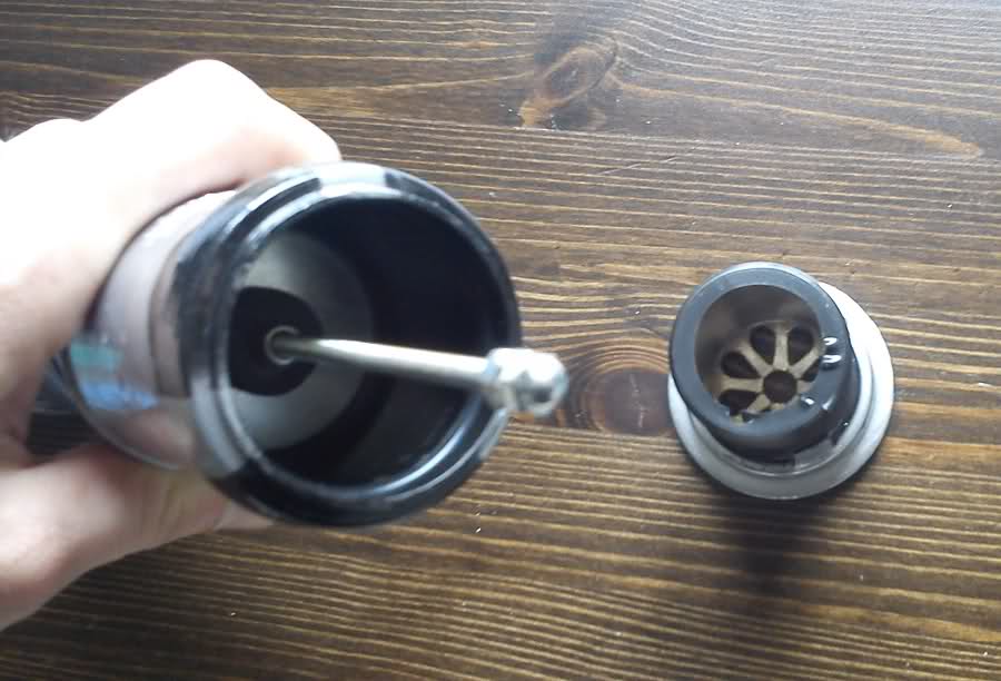

Thank you for your encouraging reply Cocacola :)
This is the hilt (yet to source some polycarbonate tubing for the 'beam'...)
and this is inside, where the batteries and circuitry will be housed

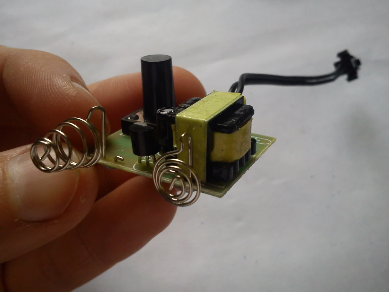

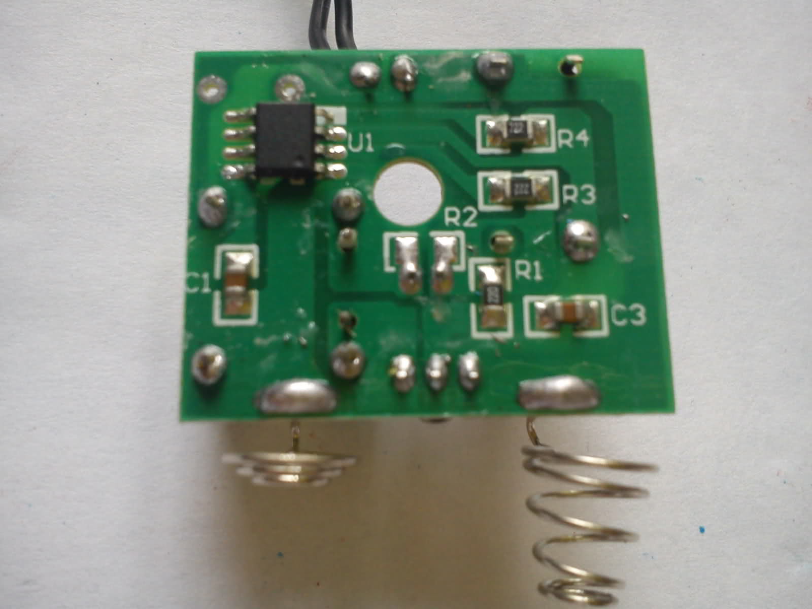

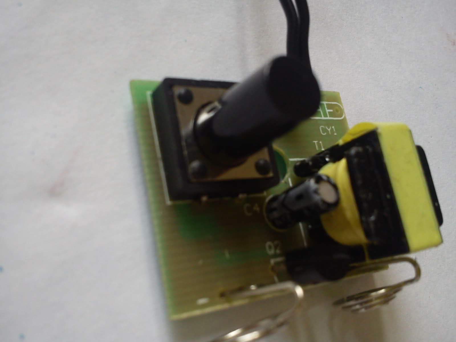

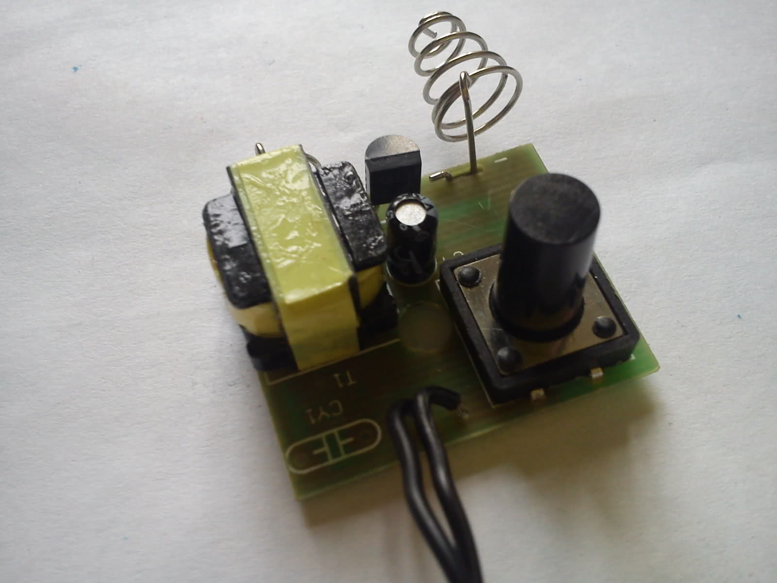

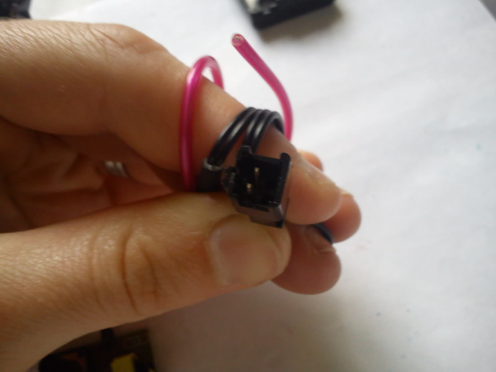

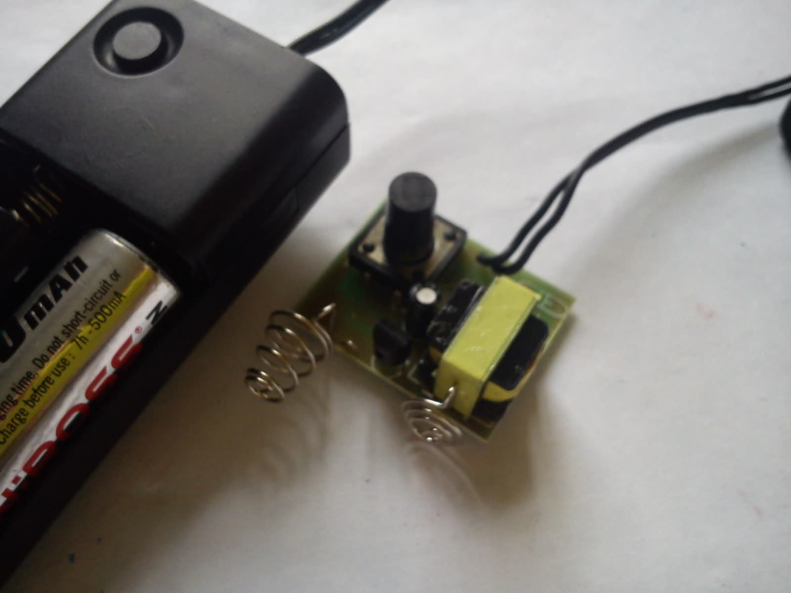

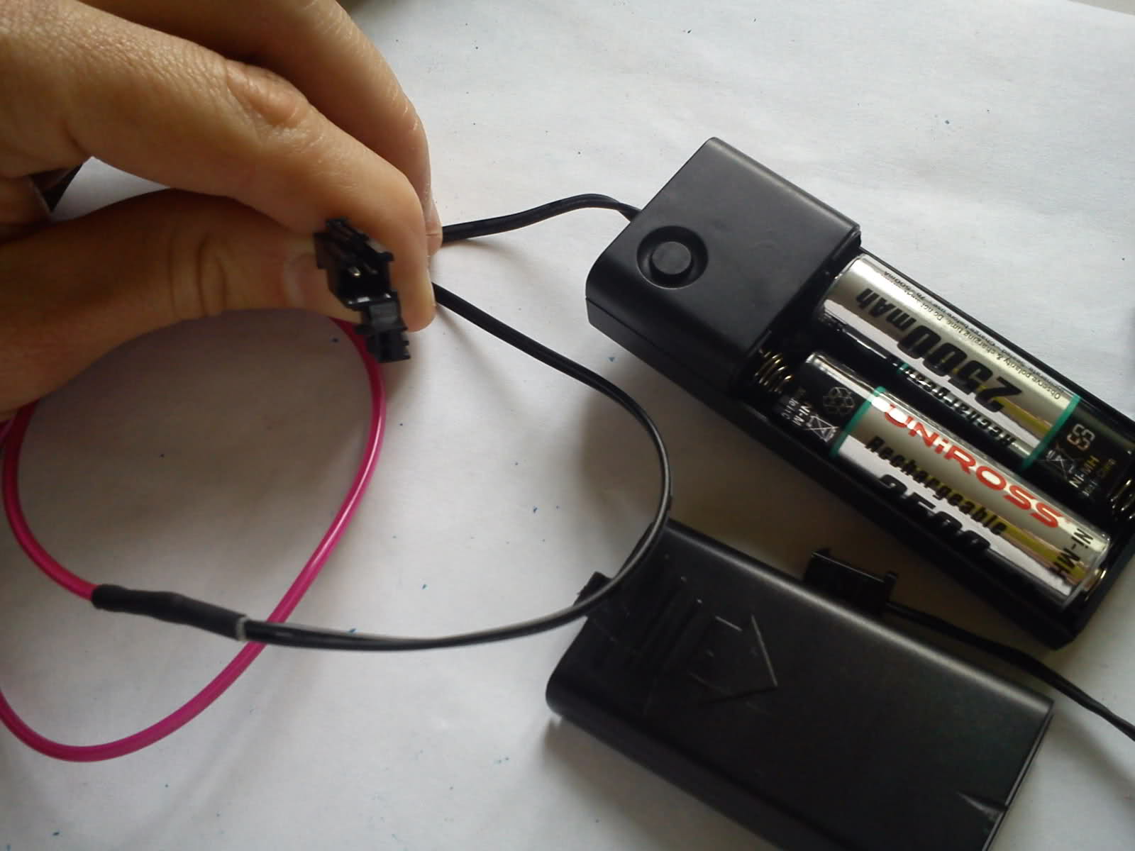

The following pics show the glow rope circuit board, wires and connections - I have 4 sets of these battery boxes, and 4 glow ropes in different colours;
I'm afraid my knowledge of electronics isn't good, and some things have gone right over my head, e.g the solid state driver :confused:
What, in your opinion would be the easiest way to power the 4 colours independently from a single battery box? There's room in the hilt for additional circuitry and to fix components aside of the battery container, so this can be used up if necessary, although I should add that at some point I'd also like to add a sound switch which makes the 'beam' sound from the film! Always one to bite off more than I can chew :D

OK first and foremost, be mindful of the polarity off all the wires when doing this! I can't stress this enough, you might short out something if the make to break isn't clean in the switch if polarity is mix matched...
What you are going to want to do is take the black wire pair that is attached to the circuit board, and mark ONE of the wires, use tape a sticker or whatever, but make sure only one wire is marked and your mark won't just fall off :p if you look at it funny...
Now take each of the 4 EL wires and plug it into the circuit board, and mark the wire directly across from the one you just marked on the circuit board... See attached image #1
attachment.php
The plug is polarized so when you plug them together it's easy to identify polarity...
When you are done you will have marked polarity on all the units, this is important as the next step is to cut all those connectors off, so you just have wires...

The top of the hilt is a 40mm plastic coupling (standard plumbing type),and where the compartment is shown opened up in the image below, the metal washer that you see with the threaded rod coming from it can be removed - below it is hollow metal tubing.
If the components don't fit in alongside the battery compartment and switch then I can hopefully put them below the washer in the main handgrip area. If I am correct the sound components, depending on what I use, can be run from a button cell battery which shouldn't need replacing too often?
Have contacted some UK plastics manufacturers to enquire about suitable high-impact resistant tubing this evening. Fingers crossed I can find some at a reasonable price!

Hello again,
Switches arrived and I wired the glow ropes in as advised - works perfectly!:D:D
....Then I ran into a technical hitch in the design - the battery compartment is too long for the section it needs to fit into. 'No problem' I thought - I'll use a 9v battery instead. Not only will it fit better but the connection is less likely to come loose than with 2xAAs.
I sought some advice from a friend of a friend who said that in order to achieve this, I would need this regulator: TS2950CT-3.3 which I bought along with a 9v battery clip
He advised that it should be soldered as follows;
Left pin> +ve on battery clip
middle pin>ground on battery clip plus -ve on board
right pin> +ve on board
This I did. Didn't work
I found a datasheet online which indicated the left and right should be the reverse of what I did (here for reference) so I resoldered but still nothing.
I checked the board was still ok by backtracking and hooking it up to the 2 AA batteries again and it all works fine. I'm stumped as to what I need to do next. It seems as though the 9v battery power is just not coming through at all. I tried a second battery clip and then a second regulator as I bought 2 (have 2 kids :rolleyes:). I also tried an alternative battery, althoug the first one is a rechargeable 9v which is new and had been charged overnight.
Now that I've learned what a regulator is and what it looks like, I've noticed there is another one already on the board as visible in the pics above. Could that be causing a problem perhaps, being double-regulated?

The 150mA rating is likely too low for your application, you should try a 1A regulator, but I can't seem to find a fixed voltage one on Maplin... You might have to go with and adjustable one if Maplin is your only option?

Nope, no worries about frying anything the circuit will only draw the current it needs if you are going to mail order look for a 1.5 or 2.0 amp version (in the same TO-220 package) the extra will ensure you have enough head room, short of measuring what your circuit it is actually using... 1A might very well be enough, and in likelihood is, I'm just aiming on the side of planning for worst case and if you mail order you have the option to get a higher rated one...
You can get a variable regular at Maplin, but you will need to use a few resistors to set the voltage level... Heck Maplin might even have a fixed one if you visit, I just hate their site and search features and being in the US don't know what the actual retail fronts look like...
In either case get the datasheet and be mindful of the pin out, I have found that with many 3.3 Volt regulators they like to swap the standard TO-220 regulator pin out locations for whatever reason...
