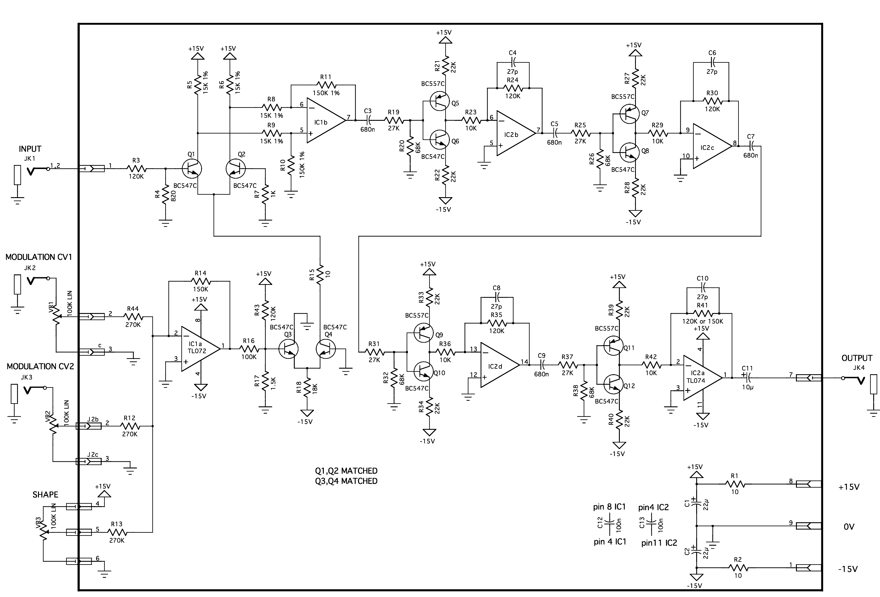

Hi all, i'm looking for advice on what component values i may need to change on this circuit to run it at -12v / +12v rather than the -15v / +15v please?

Calculate the voltage on the base of Q3 from resistors R17 and R43. Changing R43 to 100k may be close enough.
R21/R22 could be changed to 18k (likewise for all the other similar pairs of resistors).
R5 and R6 12k. R18 15k.
Is this for a eurorack mod synth module?

HI Steve, thanks, it's to go in a music from outer space system I've been building, well actually it is already in the system just i've been noticing some spiralous noises and quite a lot of undulating hum/distorted/noise coming from it at times and realised I hadn't paid enough attention to the fact it was designed to run on a different voltage, lazy really, just assumed it'd be fine..... electronics tends to not like my assumptions :)
"Calculate the voltage on the base of Q3 from resistors R17 and R43"
I hope i'm getting this right, in that i just use a voltage divider calculation?
So here's my calculation based on original component vlaues
15 (v) x 1.5 (R17) = 22.5
120 (R43) + 1.5(R17) =121.5 22.5/121.5 = 0.1851
So the answer 0.1851 needs to remain (or be as close as possible) when adjusting the divider accepting 12v and changing R43?
And with R43 changed to 100K and voltage at 12v
12 (v) x 1.5 (R17) = 18
100 (R43) + 1.5 (R17) = 101.5 18 / 101.5 = 0.1773
Is that close enough?
Actually I stopped here and realized I should be able to calculate, I needed to get some help off a friend though to help me through the steps needed to isolate R43, the calculation needed is;
V source x R17 / V out - R17 = R43
12 x 1.5 / 0.8151 - 1.5 = 95.74
As for the other pairs of resistors, i'm unsure how to calculate these, or at least what calculation is required? Maths is still very new to me, but trying my best to learn and catch up

The changed I suggested probably aren't that important. I don't really know why Q3 is biased the way it is, but our of an abundance of caution I'd say keep it as similar as possible.
The values I gave would be what I would start with.

You could use a +-15 V power supply plus a pair of 7812/7912 voltage regulators to create the +-12 V for the music module from the +- 15 V. No additional transformer or rectifier required, only the regulators and a handful of capacitors. Easy to wire on a piece of perfboard.
Do you think it would be easier to provide both power buses throughout rather than change the modules?
The additional "bus" is but a pair of wires (ground is and has to be the same for both power systems).
It's the way I'd go because I'm lazy ;D. Doesn't mean you have to do it that way. If you want to learn a bit about modifying ("hacking") the 15 V modules to work from 12 V you're welcome.

In general there would be no problem supplying some modules with +/-15V and others +/-12V. In fact, most of the modules designed for +/-12V should not be damaged by +/-15V (not a guarantee).
However, a module powered by +/-15V could supply an output voltage outside +/-12V to a module powered by +/-12V, and this might cause problems.
It may be easier to look at the inputs (and outputs) of the +/-12V modules and see if they will be safe in such an instance.
If you go this route, you will need to check any new +/-12V modules, including ones where you don't have the schematic.

Cheers Harald. Ok, I understand this and agreed it would be easier. I think for now i'm ready to learn how to modify the circuits as it will be a good learning exercise, i'm finding learning Math quite difficult and this might be a good place to begin trying to apply myself more.

Cheers Steve. Would this mean checking the Control voltage tolerances for each module? Or checking what CV each module expects to recieve? I.m pretty sure the MFOS modules expect -+/-5v and supply this also, I've driven some harder at times by mistake and haven't seen any problems, but then I'm unsure of how over time this might damage the circuit
Also i'm guessing making sure there's no impedance problems between modules?

It would mean checking the output voltage for all modules. Make sure it doesn't exceed +/-12V. If the inputs (of the +/- 12V modules) are protected by some series resistance or blocking capacitors then the chance of damage will be reduced.

I'd gotten the power distribution incorrect in the entire system. I'd wired it all in series. Rewired it all today with a bus and all noise, spirilous sounds, popping disappeared. If I'd explained the problems I was having with my system and photos of how I'd wired it all I'm sure you'd have pointed my error out straight away. Apologies. I will still make the modifications to the YUSYNTH modules to adapt to +/- 12v. Good news is that my synth now sounds HUGE and wonderful :)
