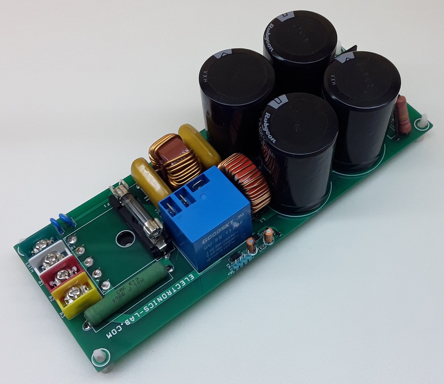

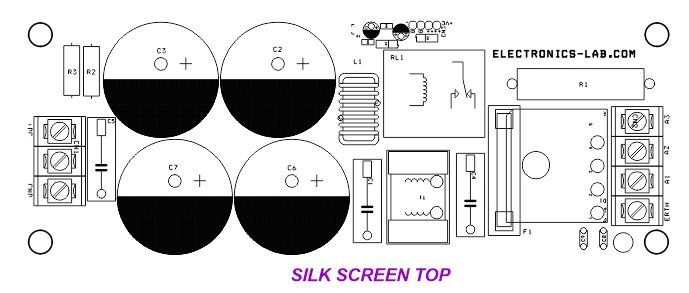

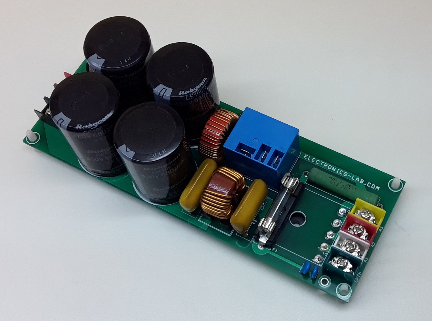

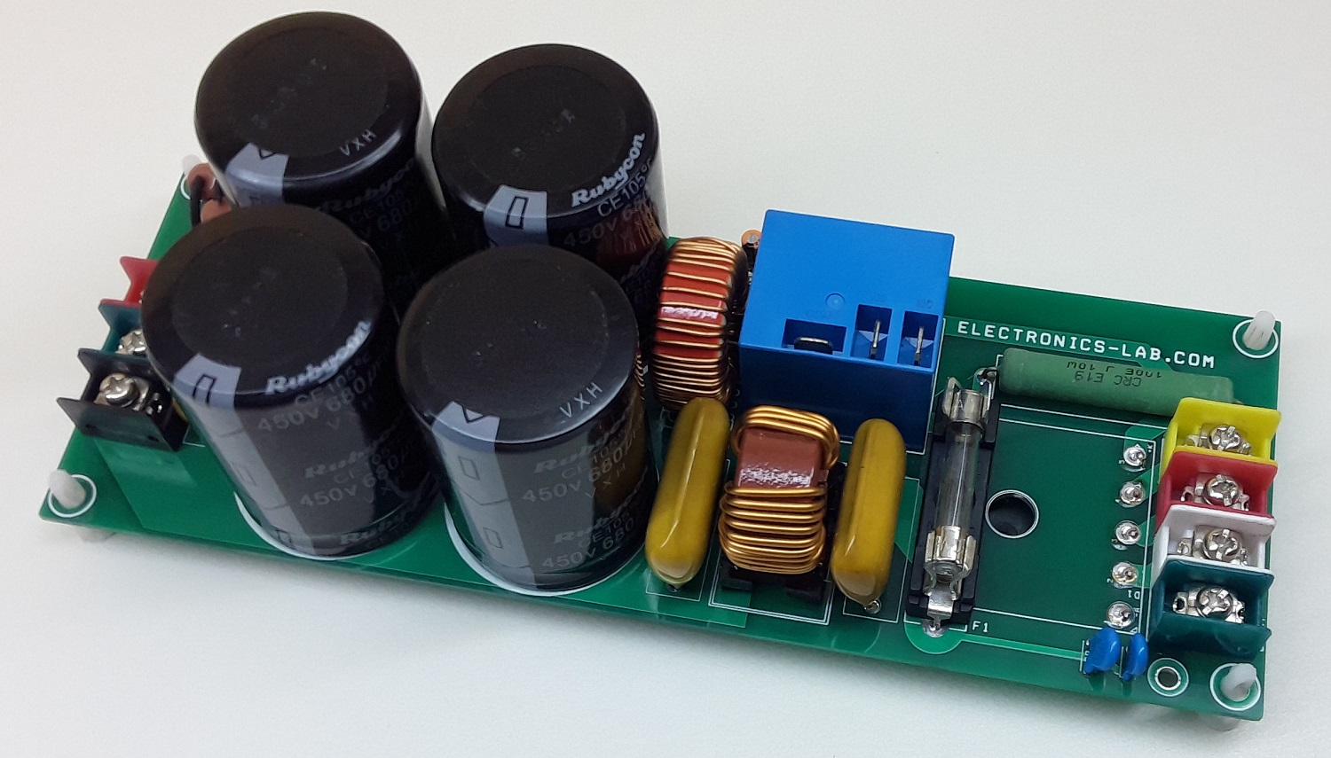

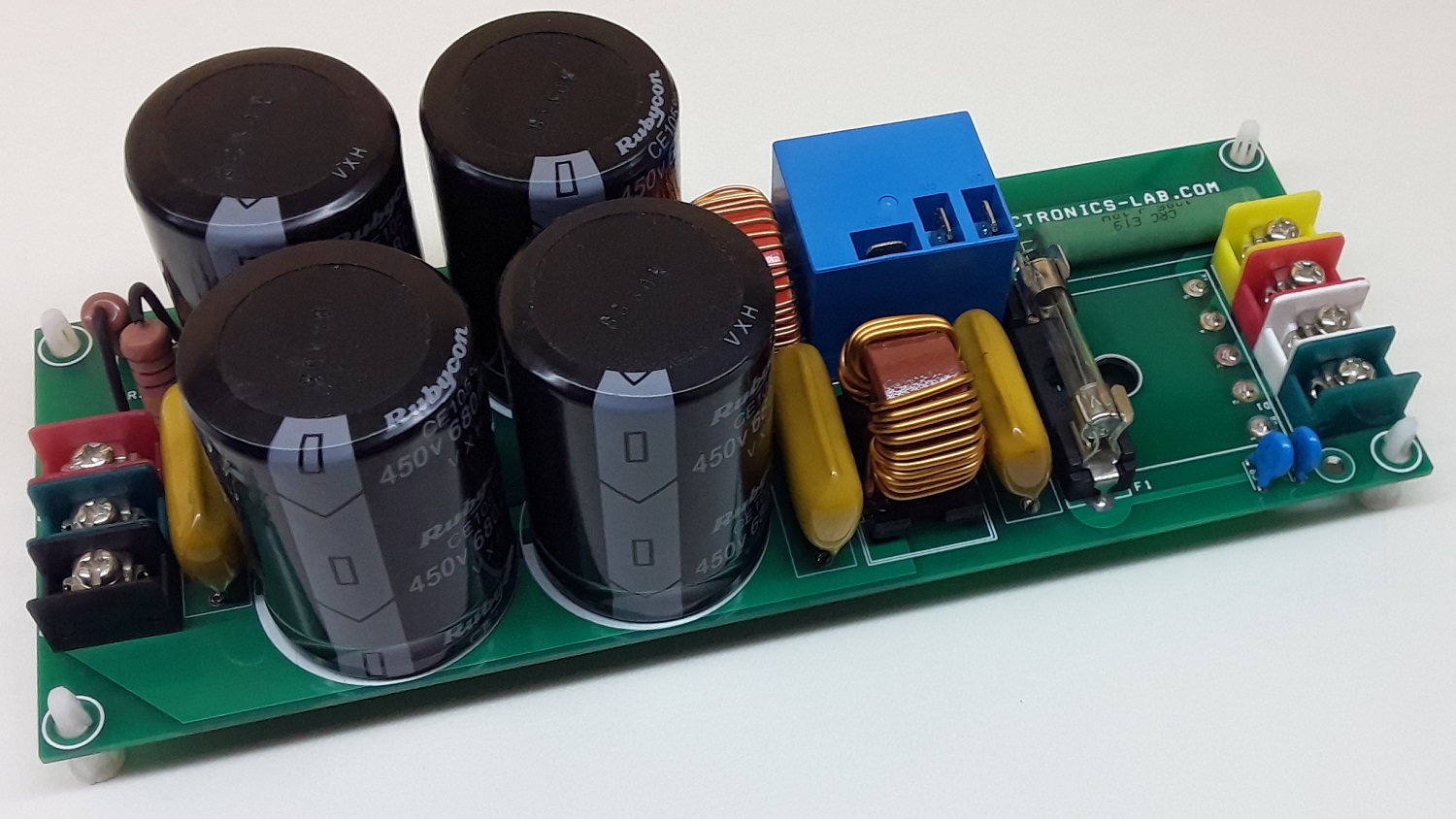

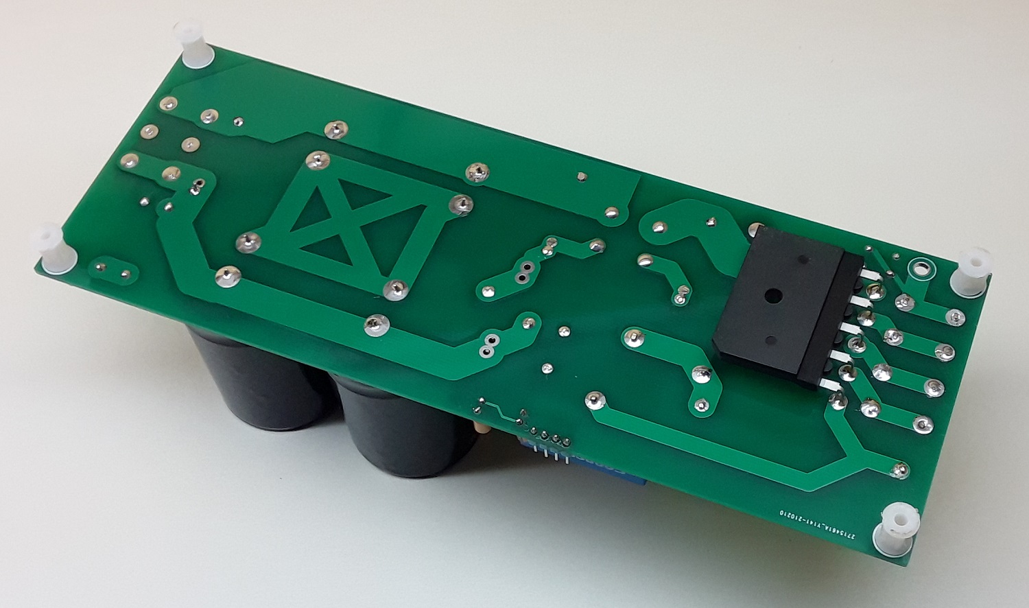

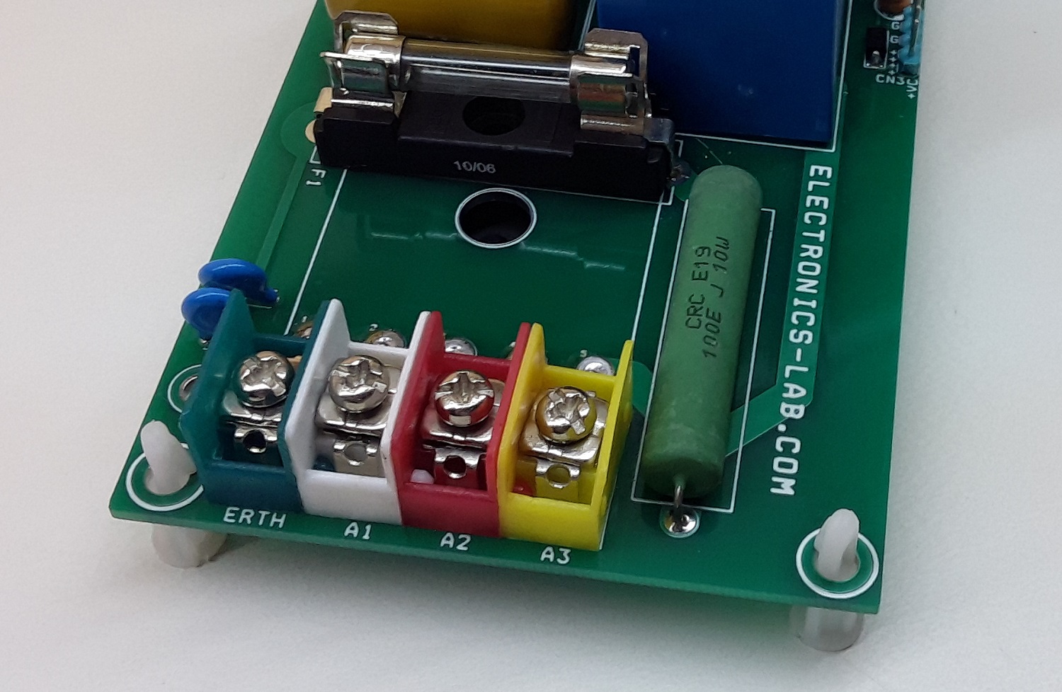

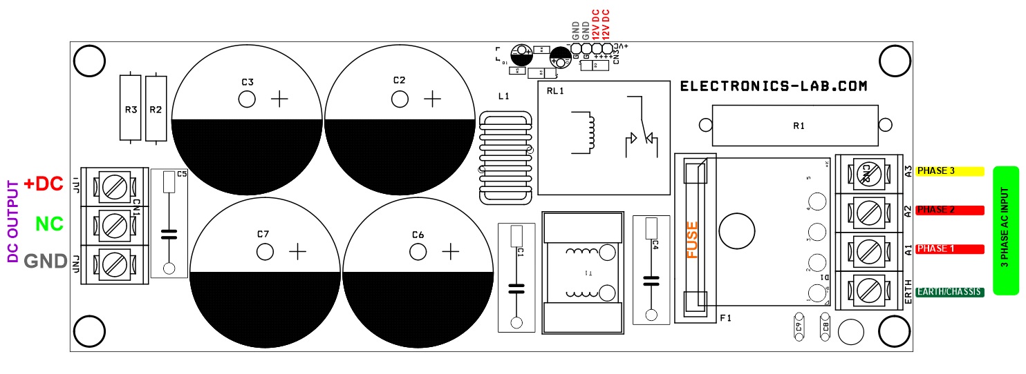

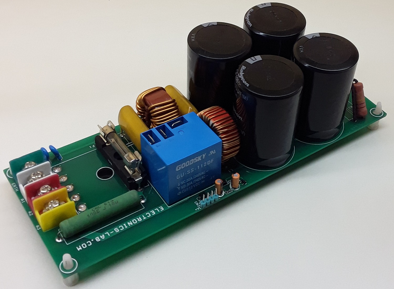

Although this power supply design is specific to the Intelligent Power Modules (IPM) VFD drives, high voltage boost converters, high voltage battery chargers, etc, the concept and circuit design may be used for any power supply that requires a high voltage output of up to 800V DC and 4 A. Since it is an unregulated power supply the output will depend on AC input voltage. The circuitry includes a passive EMI filter consisting of elements C8, C9, C4, T1, and L1.  Bridge rectifier D1, R1 for inrush current protection, and a relay RL1 for soft powering up and reducing conduction losses in steady-state. 4 x electrolytic capacitors C2, C3, C6, C7 are used for buffering the rectified DC bus voltage, bleeding resistors R1, and R2 provided to discharge the DC bus capacitor after power off. It is advisable to use a heatsink for the bridge rectifier. Inrush current circuit requires 12-15V DC @ 80mA. Choose appropriate fuse as per current requirement. The relay takes care of the inrush current. It is important to switch ON the 12V-15V DC and 3phase power same time.
We have tested this power supply with Input 3 Phase 430V AC, Output 620V DC, Continued Current 5A, but it is advisable to use it at max 3A continued current.

  • Nominal Input Voltage 3 Phase 100V to 480V AC
  • Output Depend on input AC Supply
  • Output Current Continues 3Amps (Maximum 5 Amps)
  • On Board EMI Filter
  • On Board High wattage resistor for inrush Current
  • On Board Relay for soft powering up and reducing Power Losses
  • On Board Fuse for Short Circuit/Over Current Protection
  • Screw Terminals (Barrier) for Easy Connections
  • Logic Supply 12-15V for inrush Control Relay Circuit

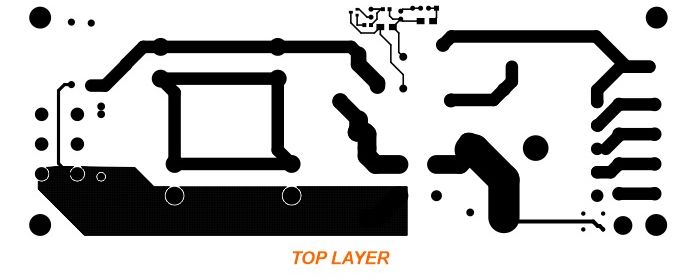

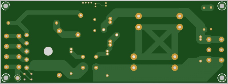

  • PCB dimensions: 206.37 x 75.56 mm

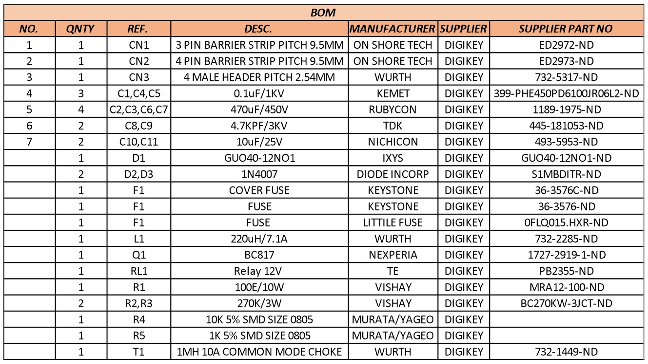

NO.QNTYREF.DESC.MANUFACTURERSUPPLIERSUPPLIER PART NO
11CN13 PIN BARRIER STRIP PITCH 9.5MMON SHORE TECHDIGIKEYED2972-ND
21CN24 PIN BARRIER STRIP PITCH 9.5MMON SHORE TECHDIGIKEYED2973-ND
31CN34 MALE HEADER PITCH 2.54MMWURTHDIGIKEY732-5317-ND
43C1,C4,C50.1uF/1KVKEMETDIGIKEY399-PHE450PD6100JR06L2-ND
54C2,C3,C6,C7470uF/450VRUBYCONDIGIKEY1189-1975-ND
62C8,C94.7KPF/3KVTDKDIGIKEY445-181053-ND
72C10,C1110uF/25VNICHICONDIGIKEY493-5953-ND
1D1GUO40-12NO1IXYSDIGIKEYGUO40-12NO1-ND
2D2,D31N4007DIODE INCORPDIGIKEYS1MBDITR-ND
1F1COVER FUSEKEYSTONEDIGIKEY36-3576C-ND
1F1FUSEKEYSTONEDIGIKEY36-3576-ND
1F1FUSE LITTILE FUSEDIGIKEY0FLQ015.HXR-ND
1L1220uH/7.1AWURTHDIGIKEY732-2285-ND
1Q1BC817NEXPERIADIGIKEY1727-2919-1-ND
1RL1Relay 12V TEDIGIKEYPB2355-ND
1R1100E/10WVISHAYDIGIKEYMRA12-100-ND
2R2,R3270K/3WVISHAYDIGIKEYBC270KW-3JCT-ND
1R410K 5% SMD SIZE 0805MURATA/YAGEODIGIKEY
1R51K 5% SMD SIZE 0805MURATA/YAGEODIGIKEY
1T11MH 10A COMMON MODE CHOKEWURTHDIGIKEY732-1449-ND

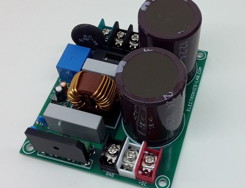

Ruben
Please provide Gerber files or KiCad project for the 3 Phase AC-DC 2KW PSU. Great design for HV applications!
Taj
The fuse and input filter should be added before the bridge rectifier so if the bridge rectifier goes short the fuse will blow
also there should be some Metal oxide varistors after the fuses for surge protection.
