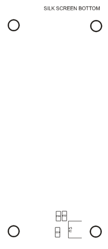

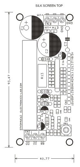

This 10A -400V DC Intelligent power module board has been designed using ON Semiconductors STK544UC62K. This Inverter IPM module includes the output stage of a 3-phase inverter, pre-drive circuits, bootstrap circuits, protection circuits, op-amp based current sense circuit, comparator circuit for fault/Over current output, Bus voltage output, onboard 5V DC regulator for op-amp circuit.
Motor Control by mixos

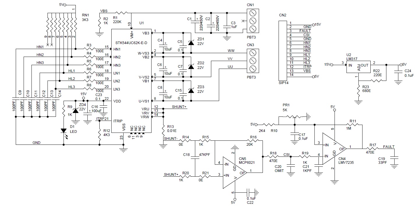

This 10A -400V DC Intelligent power module board has been designed using ON Semiconductors STK544UC62K. This Inverter IPM module includes the output stage of a 3-phase inverter, pre-drive circuits, bootstrap circuits, protection circuits, op-amp based current sense circuit, comparator circuit for fault/Over current output, Bus voltage output, onboard 5V DC regulator for op-amp circuit. The board can be used to drive AC Induction, BLDC, PMSM motors, and Brushed DC Motors. The module integrates optimized gate drive of the built-in IGBTs to minimize EMI and losses, while also providing multiple on-module protection features including under-voltage or over-voltage, over-current, and fault reporting. The built-in, high-speed HVIC requires only a single supply voltage and translates the incoming logic-level gate inputs to the high-voltage, high-current drive signals required to properly drive the module’s internal IGBTs.
Separate negative IGBT terminals are connected to a shunt resistor to provide the current feedback to the system microcontroller. This IPM module helps to develop various power applications and also can be used as H-Bridge for brushed DC motor. The module mainly helps to drive Hall sensor-based, encoder-based motors and 3 Phase AC Motors. The IC has Built-in dead-time for shoot-thru protection. The internal substrate temperature is measured with an internal pulled-up thermistor. PWM frequency is up to 20 KHz. The board can be used in applications like small machines as speed controller, washing machine, refrigerator, Air condition, automation, AC motor speed controller, dc motor speed controller, brushless dc motor driver, ac servo driver etc.
This board designed to evaluate ON Semiconductors STK544UC62K. The motion IPM is installed as the motor power module on the board to drive a three-phase AC Induction Motor (ACIM), Brushless DC (BLDC) motor, Brushless AC (BLAC) motor, or Permanent-Magnet Synchronous Motor (PMSM). The board has bulk capacitors and microcontroller (MCU) interface circuitry. As this board is designed for a wide variety of motor types, not all included circuitry is required for all types of motors. Some motor types may require some additional circuitry to be added, depending on the control algorithms being implemented.
The board is designed to connect to DC power sources feeding current to the motor. The three-phase motor output terminals (UU, VV, and WW) from the screw terminal should be connected to the motor windings. Three bootstrap power supply circuits are designed into the board, one per phase. A bootstrap capacitor and Zener diode provided to prevent the IPM module from over-voltage input. The microcontroller (MCU) or motion-controller development board connects to this IPM board via the provided 14 Pin header connector. Six low-pass filters are used between the signal input connector and the gate input signal pins of the IC. Short-circuit current protection is provided by a single shunt resistor, op-amp, and low-pass filter. Additional resistor divider circuitry is included to monitor bus voltage, inverter phase current, and module temperature.  This board is made for a high voltage motor up to 400V DC. This board can be used to make a VFD driver with help of an embedded system or microcontroller board which generates 6 PWM signals and take care of over current, fault, Bus Voltage feedback signals. IC MCP6021 op-amp used as current to voltage converter, LMV7235 comparator provides Fault/Over current output.
Note 1: The pre-drive power supply low voltage protection has approximately 200 mV of hysteresis and operates as follows. Upper side : The gate is turned off and will return to regular operation when recovering to the normal voltage, but the latch will Continue till the input signal will turn ‘high’. Lower side : The gate is turned off and will automatically reset when recovering to normal voltage. It does not depend on input signal voltage.
Note 2: When assembling the IPM on the heat sink the tightening torque range is 0.6 Nm to 0.9 Nm.
Note 3: The pre-drive low voltage protection protects the device when the pre-drive supply voltage falls due to an operating malfunction.

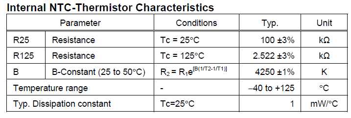

Note 4: Inside the IPM, a thermistor used as the temperature monitor is connected between VDD terminal and T/ITRIP terminal, therefore, an external pull down resistor R12 4K3 connected between the T/ITRIP terminal and VSS terminal is used, read data sheet for more info for temperature feedback.

  • Supply Up To 400V DC
  • Gate Driver Supply 15V DC
  • Current Feedback Output 200mV/1Amp
  • Fault Output Normally High, Goes low at Over Current set point
  • Trimmer Potentiometer PR1 to set the overcurrent/Fault output
Inputs/Outputs 14 Pin Header Connector
  • PIN1: 15V DC Supply for a gate driver
  • PIN 2: GND
  • PIN3: Fault output Normally High, goes low when a fault occurs
  • PIN4: Current feedback output 200mV/1A
  • PIN5: GND
  • PIN6: PWM 1 High In
  • PIN7: PWM 2 High In
  • PIN8: PWM 3 High In
  • PIN9: PWM 1 Low In
  • PIN10: PWM 2 Low In
  • PIN11: PWM 3 Low In
  • PIN 12: ITRP (Over Temperature Output)
  • PIN 13: VBS ( DC Bus Voltage FeedBack ) Output
  • PIN 14: 5V DC Output

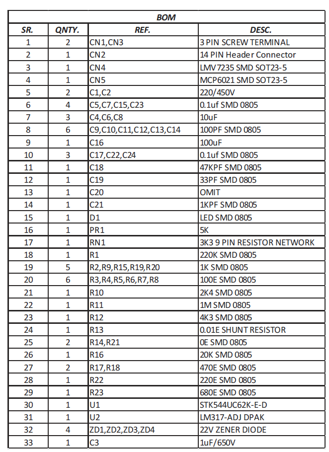

Parts List
