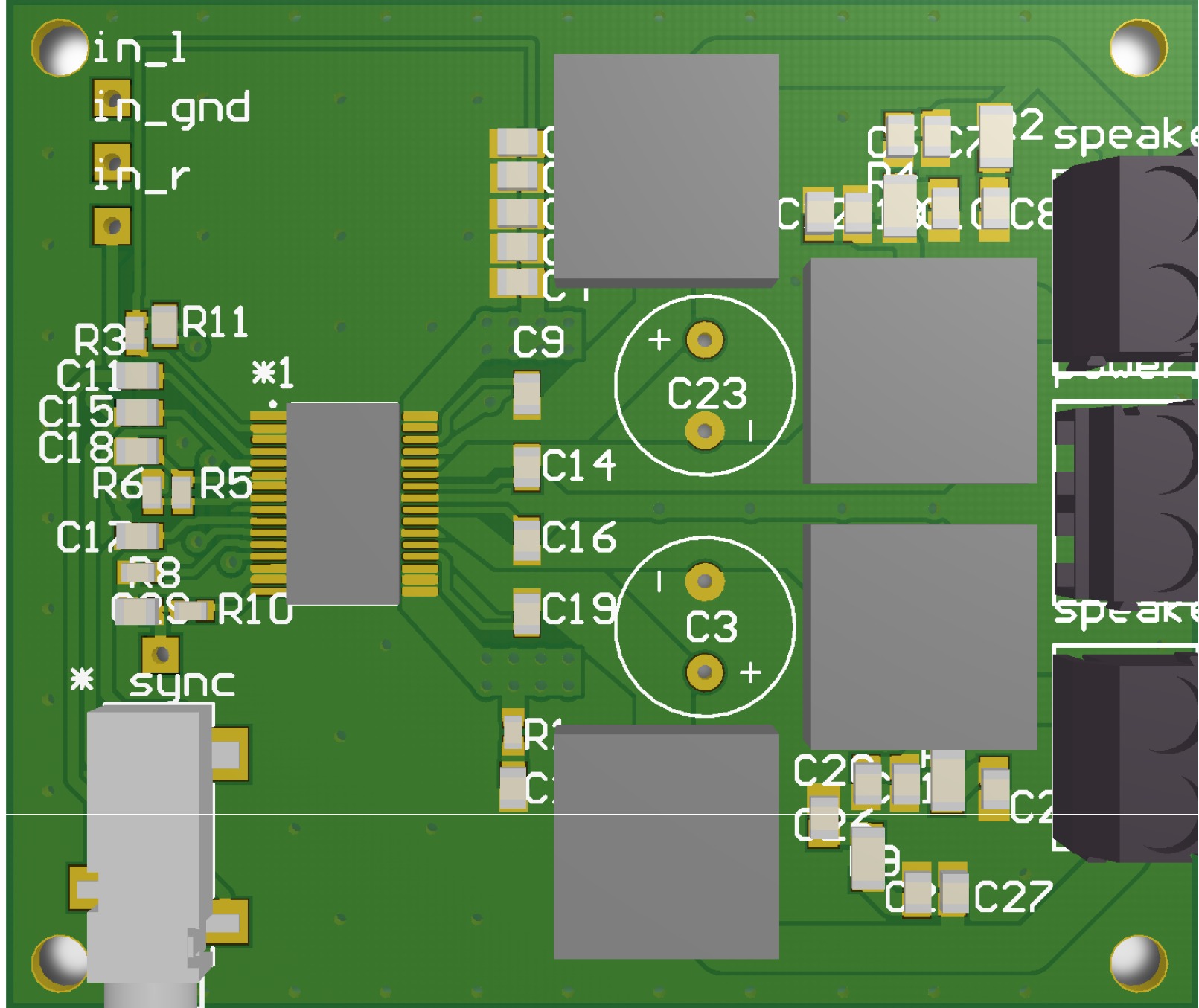

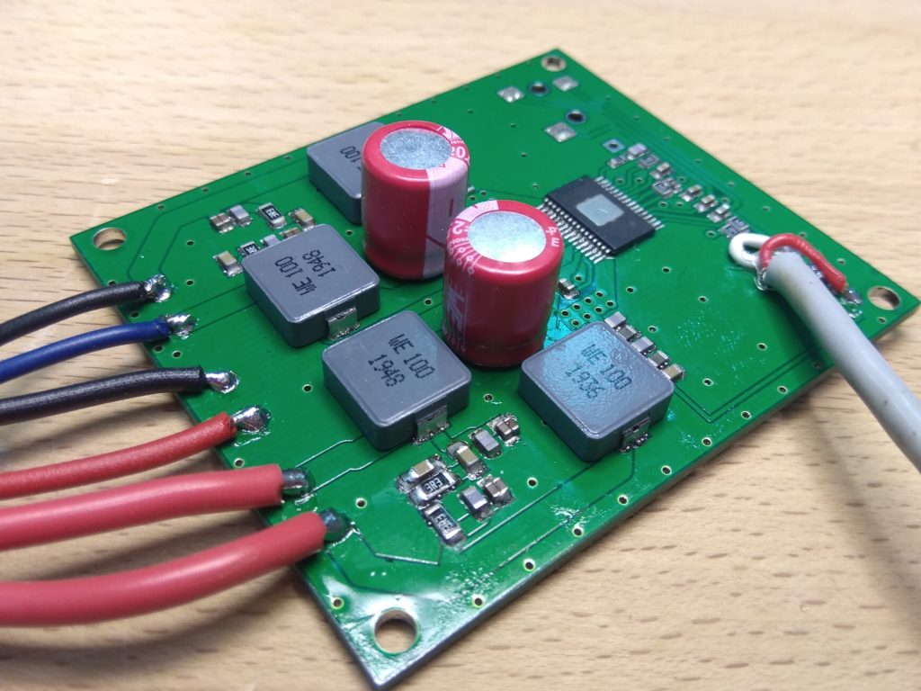

I designed an audio power amplifier board based around the TPA3116D2. I choose the highest possible oscillator frequency of 1200khz. Many Chinese designs feature no output LC filter which may result in power losses and lower efficiency. Because of that, I choose higher grade components that are included in the output filter. My design also includes a large heatsink, which may come in handy when dealing with a version of the IC that has a bottom-mounted heat pad. My design also include loads of vias at the edge of the PCB which take care of high-frequency interference.
This amplifier is capable of delivering 50W to a single-channel load (4Ω).

Thanks, I was thinking about doing the same thing. Looks great and awesome write-up
yasin
Your circuit design is excellent. Could you please share the Gerber file of the circuit?
