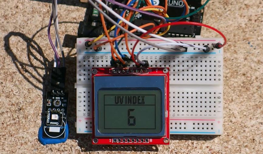

Today, we will build a UV meter using the Arduino and the ultraviolet sensor (UVM30A) with a Nokia 5110 LCD display as the display for the meter. The Nokia 5110 is used to display the UV index which is an international standard unit for the intensity of ultraviolet rays from the sun being experienced in a particular place and at a particular time.

Connecting the N0kia 5110 LCD to the Arduino is an art that we have perfected over several tutorials, an example of which can be found here, but for the purpose of this tutorial, we will still include the pin map so you can easily connect it if following that schematic is a little bit difficult. Alongside the pin map for the LCD is the pin map for connecting the UV sensor to the Arduino.
UV Sensor to Arduino pin map
UV sensor – Arduino
GND - GND
VCC - VCC
output - A0
Nokia 5110 LCD to Arduino Pin map
LCD – Arduino
Pin 1(RST) – D12
Pin 2(CE) – D11
Pin 3(DC) – D10
Pin 4(DIN) – D9
Pin 5(CLK) – D8
Pin 6(VCC) - VCC
Pin 7(LIGHT) - GND
Pin 8(GND) - GND
Double check the connections to confirm everything is okay before proceeding to the code.

Demo
Connect the Arduino board to your computer, launch the IDE and paste the code into it. Don’t forget to add the UI and the Splash files to the Arduino sketch folder for the code before uploading as this may bring up errors. The splash and UI files are part of the files in the zip file under the downloads section.
Demo
Upload the code to your board and take it outside to measure the UV intensity in your area. It was a very sunny day in Greece at the time this tutorial was written.
