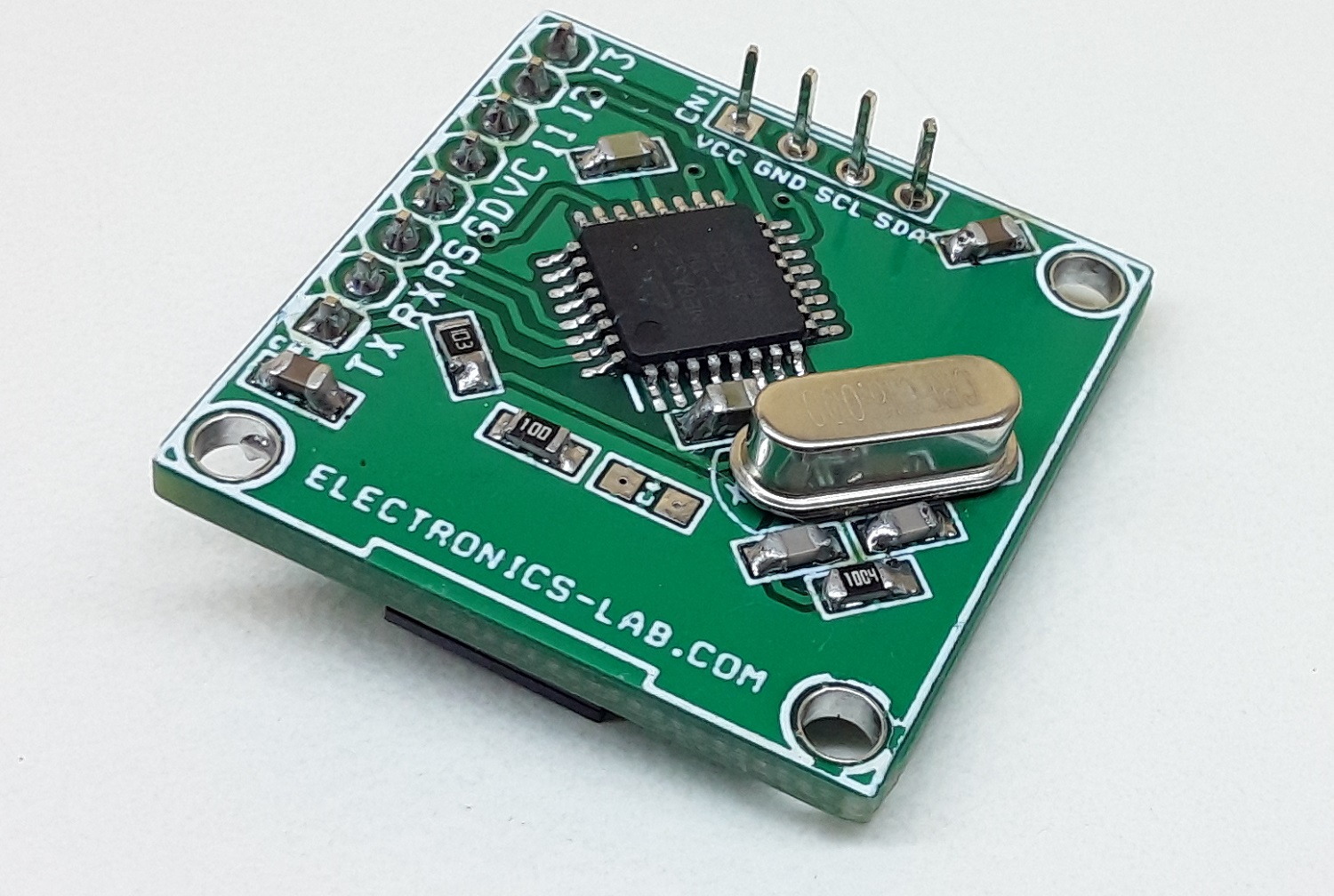

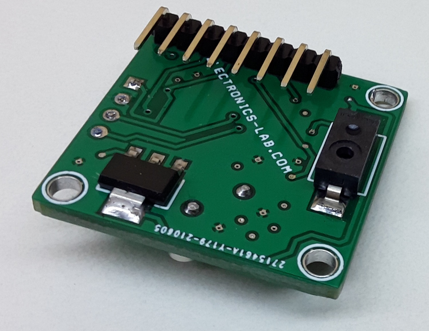

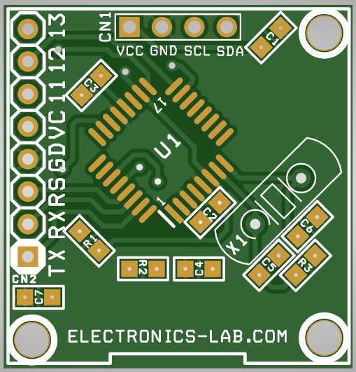

This is an easy to build, very compact, and low profile Arduino compatible platform to build a humidity meter/Gauge using a 0.96Inch OLED display. The project consists of Atmega328 microcontroller, 0.96Inch OLED display, 3.3V regulator, and HIH5030 analog humidity sensor from Honeywell.
This is an easy to build, very compact, and low profile Arduino compatible platform to build a humidity meter/Gauge using a 0.96Inch OLED display. The project consists of Atmega328 microcontroller, 0.96Inch OLED display, 3.3V regulator, and HIH5030 analog humidity sensor from Honeywell. The HIH5030 sensor provides an analog voltage output, the analog voltage is near linear voltage output vs %RH, the sensor output is connected to A0 (Arduino-ADC pin 0) of the ATmega328 microcontroller. The sensor output is 0.25V to 2.5V vs 0 to 100% RH. Connector CN2 is provided for boot-loader flashing and Arduino programming. Use Pin 4 GND and Pin5 VCC to power the project.

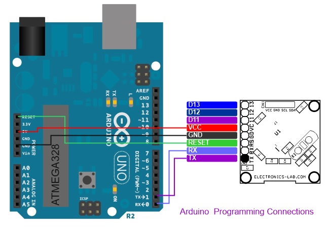

This is Arduino compatible project, a new Atmega328 microcontroller requires flashing the boot-loader and then program the Arduino code. Follow the link below to learn the programming process. Example code is provided as a download to test the project, this code is not accurate required proper calibration and mapping.
From Arduino to a Microcontroller on a Breadboard: https://www.arduino.cc/en/Tutorial/BuiltInExamples/ArduinoToBreadboard

- PCB dimensions: 28.42 x 27.31 mm

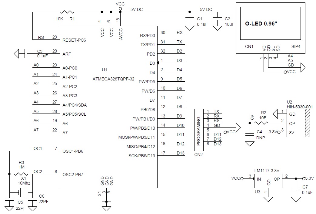

Schematic

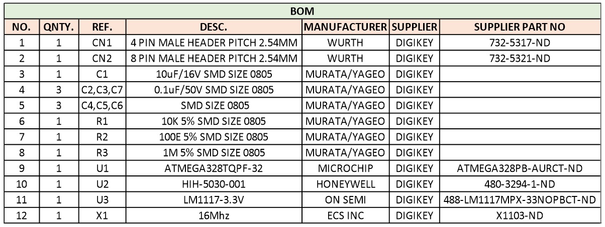

Parts List
| NO. | QNTY. | REF. | DESC. | MANUFACTURER | SUPPLIER | SUPPLIER PART NO |
| 1 | 1 | CN1 | 4 PIN MALE HEADER PITCH 2.54MM | WURTH | DIGIKEY | 732-5317-ND |
| 2 | 1 | CN2 | 8 PIN MALE HEADER PITCH 2.54MM | WURTH | DIGIKEY | 732-5321-ND |
| 3 | 1 | C1 | 10uF/16V SMD SIZE 0805 | MURATA/YAGEO | DIGIKEY | |
| 4 | 3 | C2,C3,C7 | 0.1uF/50V SMD SIZE 0805 | MURATA/YAGEO | DIGIKEY | |
| 5 | 3 | C4,C5,C6 | SMD SIZE 0805 | MURATA/YAGEO | DIGIKEY | |
| 6 | 1 | R1 | 10K 5% SMD SIZE 0805 | MURATA/YAGEO | DIGIKEY | |
| 7 | 1 | R2 | 100E 5% SMD SIZE 0805 | MURATA/YAGEO | DIGIKEY | |
| 8 | 1 | R3 | 1M 5% SMD SIZE 0805 | MURATA/YAGEO | DIGIKEY | |
| 9 | 1 | U1 | ATMEGA328TQPF-32 | MICROCHIP | DIGIKEY | ATMEGA328PB-AURCT-ND |
| 10 | 1 | U2 | HIH-5030-001 | HONEYWELL | DIGIKEY | 480-3294-1-ND |
| 11 | 1 | U3 | LM1117-3.3V | ON SEMI | DIGIKEY | 488-LM1117MPX-33NOPBCT-ND |
| 12 | 1 | X1 | 16Mhz | ECS INC | DIGIKEY | X1103-ND |

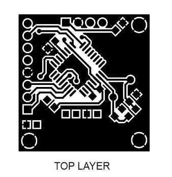

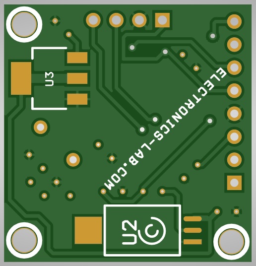

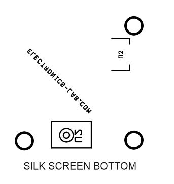

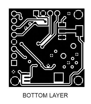

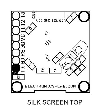

Gerber View

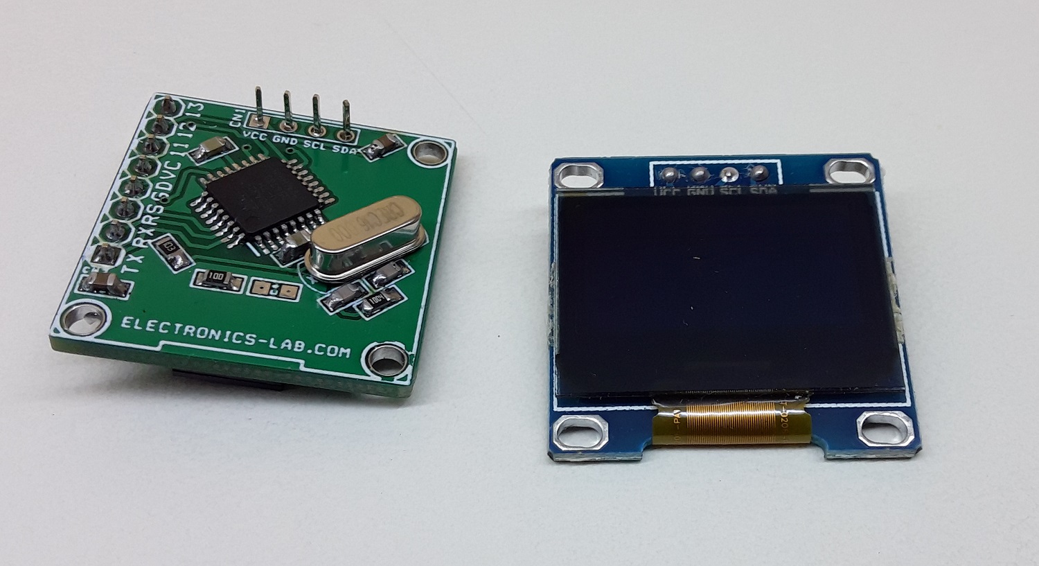

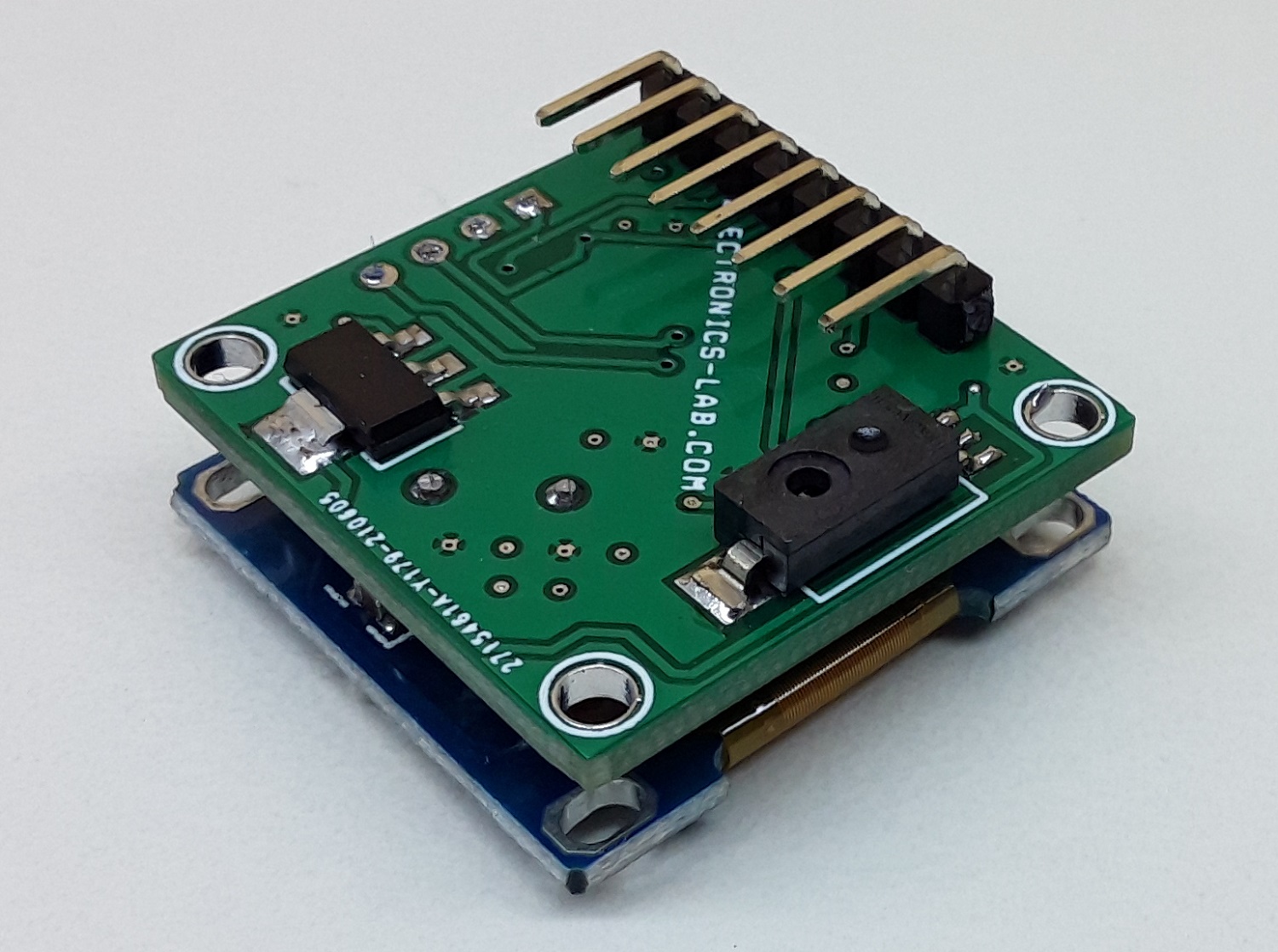

Photos
