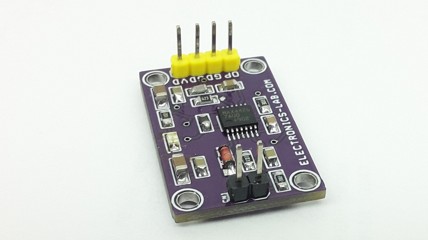

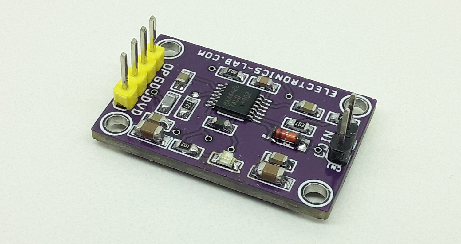

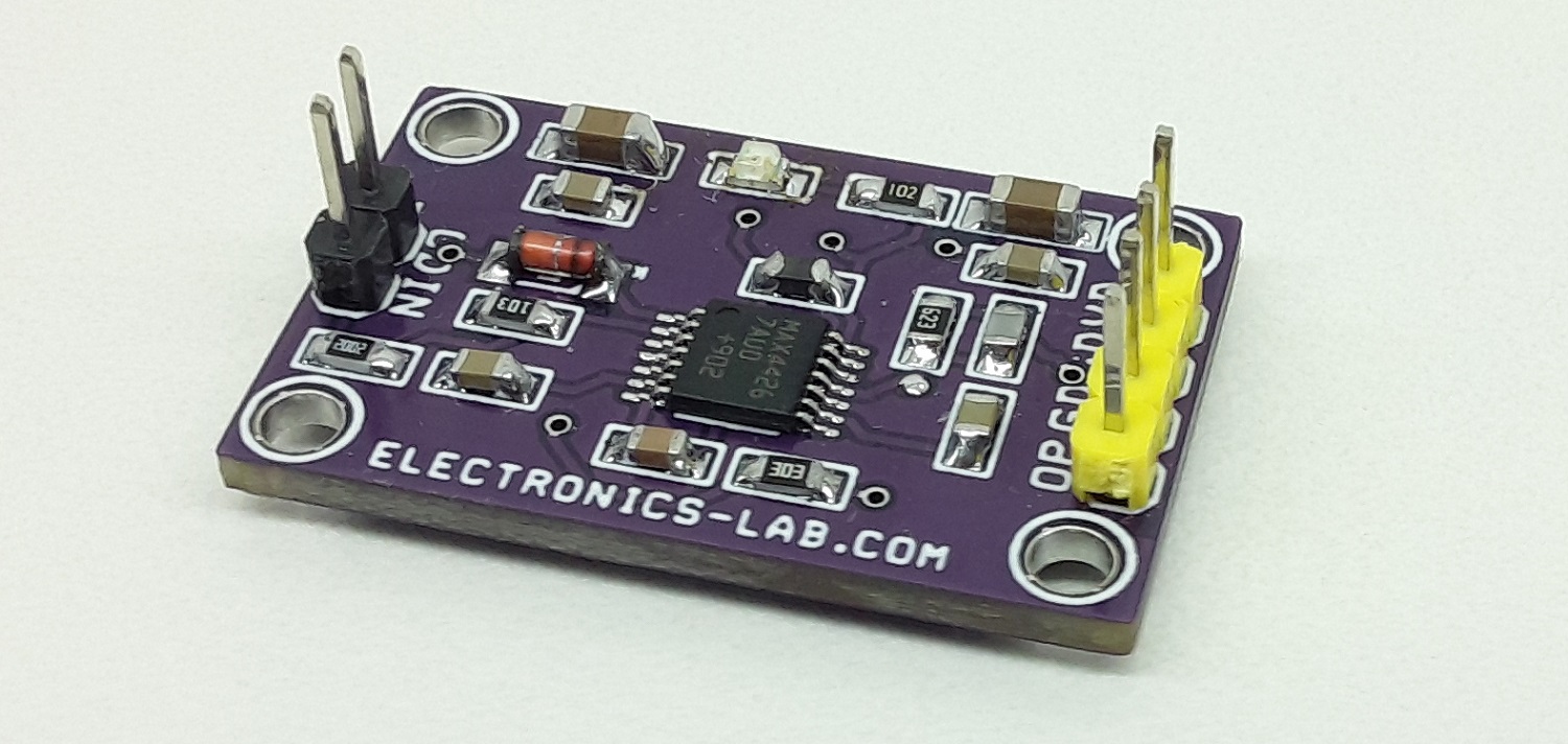

This is a Full wave rectifier project built using MAX44267 dual OPAMP which provides true zero output with a single supply. The circuit converts Bipolar/AC input into full-wave output.

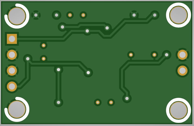

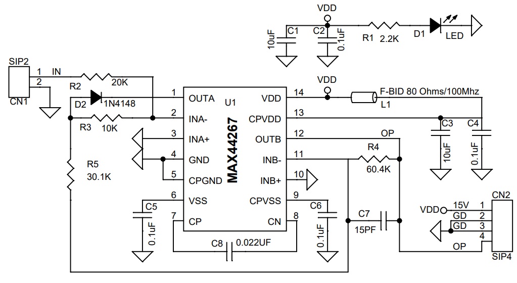

This is a Full wave rectifier project built using MAX44267 dual OPAMP which provides true zero output with a single supply. The circuit converts Bipolar/AC input into full-wave output. CN1 is provided for sinewave input, CN2 helps to connect the power and output. Operating supply 15V DC, D1 power LED.
The MAX44267 precision, low-noise, low-drift dual operational amplifier offers true-zero output that allows the output to cross zero maximizing the dynamic range of an ADC and increasing resolution. In addition, the input common-mode range extends from +13.5V down to -12V. The MAX44267 integrates charge-pump circuitry that generates the negative voltage rail in conjunction with external capacitors. This allows the amplifier to operate from a single +4.5V to +15V power supply, but it is as effective as a normal dual-rail ±4.5V to ±15V amplifier. The architecture eliminates the need for a negative power-supply rail, saving system cost and size. The MAX44267 is unity-gain stable with a gain-bandwidth product of 5MHz. The device features low offset voltage of 50μV (max), drift of 0.4µV/°C (max), and 200nVP-P noise from 0.1Hz to 10Hz. The low offset and noise specifications and wide input common-mode range make the device ideal for sensor transmitters and interfaces. Varying the external charge pump capacitors enables the charge-pump noise to be minimized.
- Operating power Supply 15V DC @ 10mA
- Input Signal 100mV to 4V Peak to Peak
- Input Frequency Response 1Hz to 10Khz
- 2Khz Full wave output from 1Khz Sinewave
- CN1 2.54 mm Male Header Connector for Input Signal
- D1 Power LED
- CN2 Signal Output and Power Input

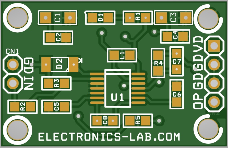

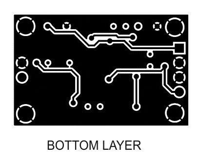

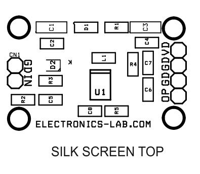

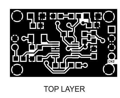

- PCB Dimensions 30.64 x 19.69 mm
Schematic

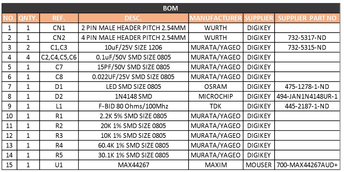

Parts List
| NO. | QNTY. | REF. | DESC. | MANUFACTURER | SUPPLIER | PART NO |
| 1 | 1 | CN1 | 2 PIN MALE HEADER PITCH 2.54MM | WURTH | DIGIKEY | |
| 2 | 1 | CN2 | 4 PIN MALE HEADER PITCH 2.54MM | WURTH | DIGIKEY | 732-5317-ND |
| 3 | 2 | C1,C3 | 10uF/25V SIZE 1206 | MURATA/YAGEO | DIGIKEY | 732-5315-ND |
| 4 | 4 | C2,C4,C5,C6 | 0.1uF/50V SMD SIZE 0805 | MURATA/YAGEO | DIGIKEY | |
| 5 | 1 | C7 | 15PF/50V SMD SIZE 0805 | MURATA/YAGEO | DIGIKEY | |
| 6 | 1 | C8 | 0.022UF/25V SMD SIZE 0805 | MURATA/YAGEO | DIGIKEY | |
| 7 | 1 | D1 | LED SMD SIZE 0805 | OSRAM | DIGIKEY | 475-1278-1-ND |
| 8 | 1 | D2 | 1N4148 SMD | MICROCHIP | DIGIKEY | 494-JAN1N4148UR-1 |
| 9 | 1 | L1 | F-BID 80 Ohms/100Mhz | TDK | DIGIKEY | 445-2187-1-ND |
| 10 | 1 | R1 | 2.2K 5% SMD SIZE 0805 | MURATA/YAGEO | DIGIKEY | |
| 11 | 1 | R2 | 20K 1% SMD SIZE 0805 | MURATA/YAGEO | DIGIKEY | |
| 12 | 1 | R3 | 10K 1% SMD SIZE 0805 | MURATA/YAGEO | DIGIKEY | |
| 13 | 1 | R4 | 60.4K 1% SMD SIZE 0805 | MURATA/YAGEO | DIGIKEY | |
| 14 | 1 | R5 | 30.1K 1% SMD SIZE 0805 | MURATA/YAGEO | DIGIKEY | |
| 15 | 1 | U1 | MAX44267 | MAXIM | MOUSER | 700-MAX44267AUD+ |
