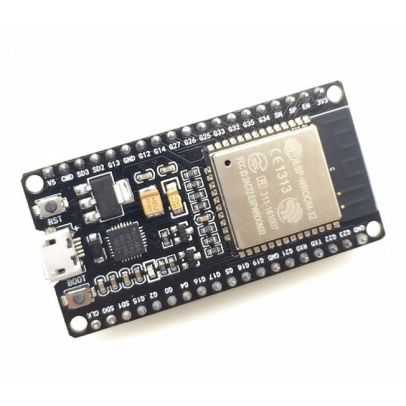

DOIT DEVKIT V1 ESP32 Based Board
The ESP32 is way advanced compared to the ESP-12e. Among several features, the ESP32 packs a CPU core, a faster Wi-Fi, more GPIOs (especially increased analog pins that we all desired), supports Bluetooth 4.2 and Bluetooth low energy. The board also comes with touch-sensitive pins, alongside a built-in hall effect and temperature sensors. While both boards are quite cheap, the ESP32 ($6 – $12) costs slightly more than the ESP-12e ($3-$6).

  1. ESP32 based development board ( I will be using the DOIT DEVKIT V1 board)

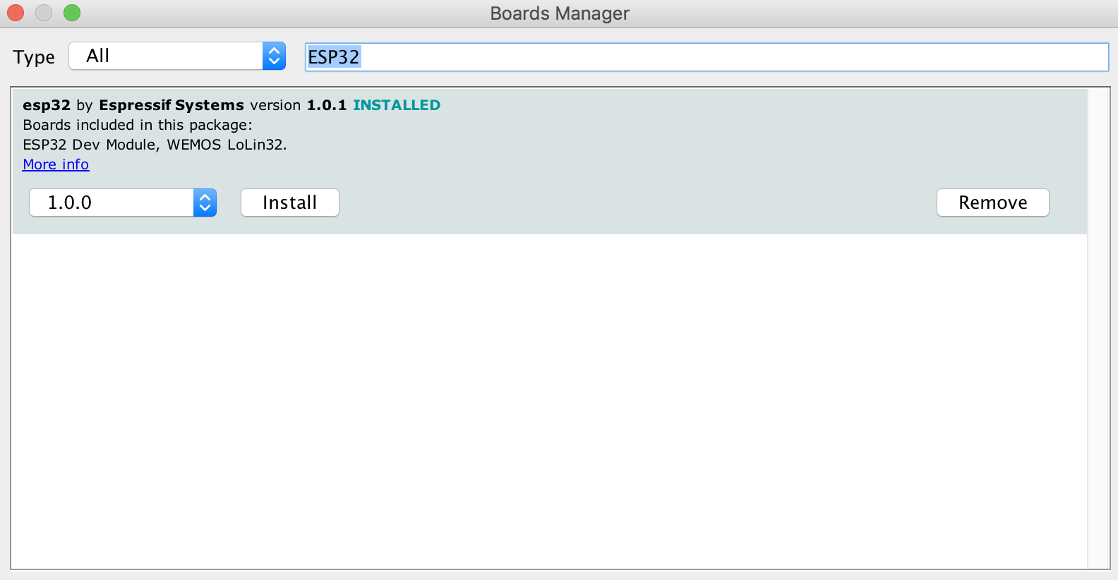

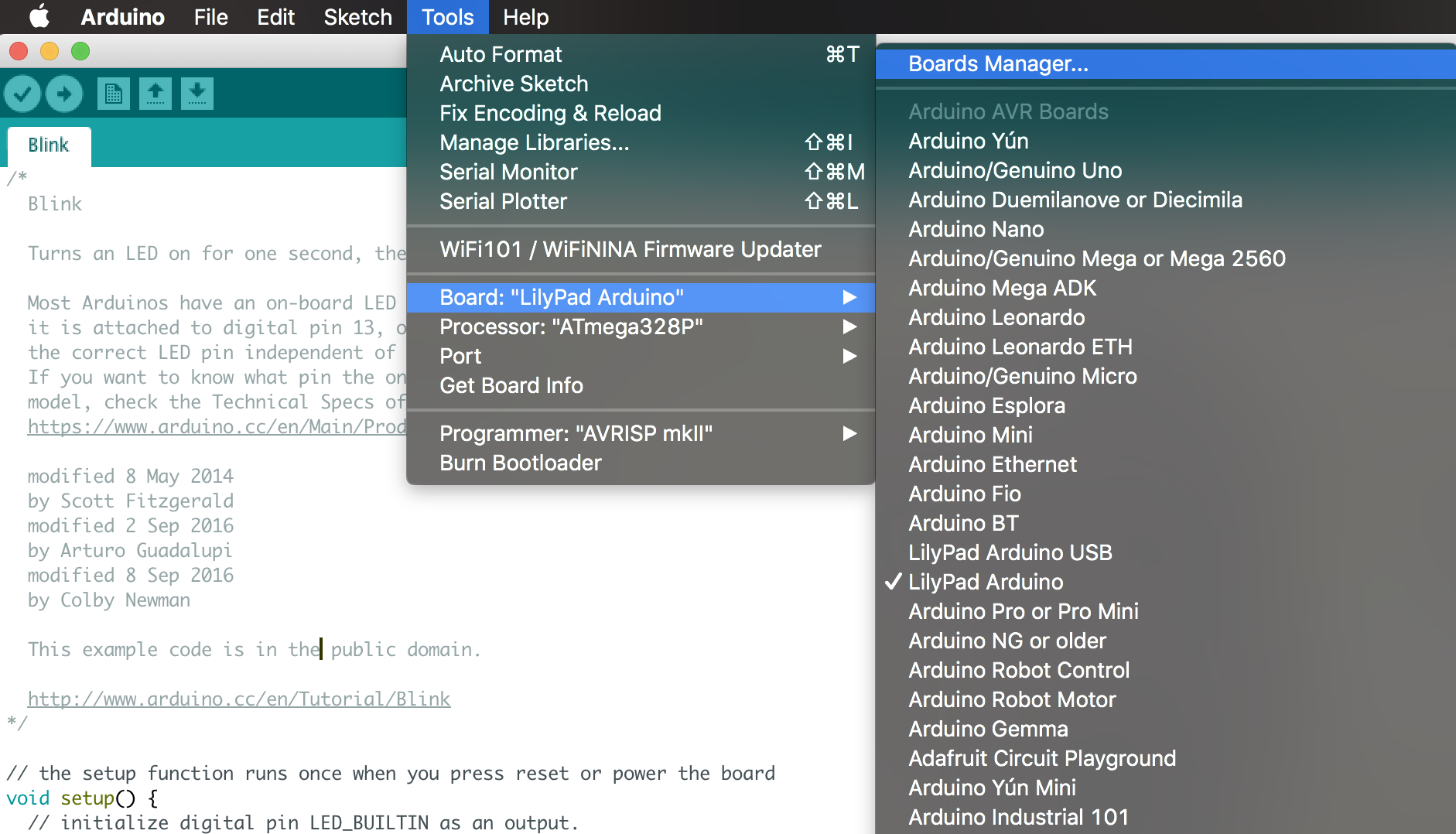

– Next, open the Arduino board manager. Go to tools > Boards > Boards manager
– When the board manager opens up, enter ESP32 into the search bar and scroll to the bottom, you will see “ESP32 by Espressif systems”, click on install.
Click on Install
With that done, you should now see quite a number of ESP32 based boards under the Arduino Board list.
