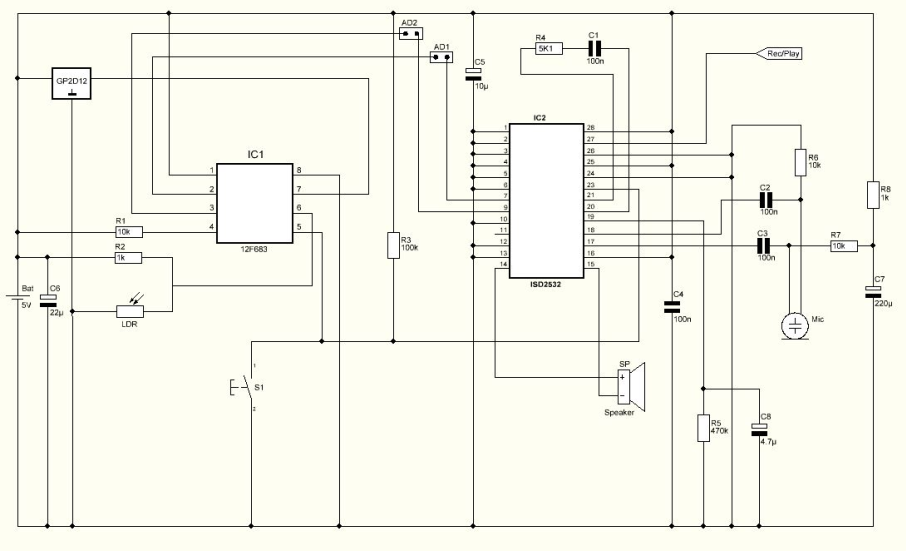

Schematic
Schematic

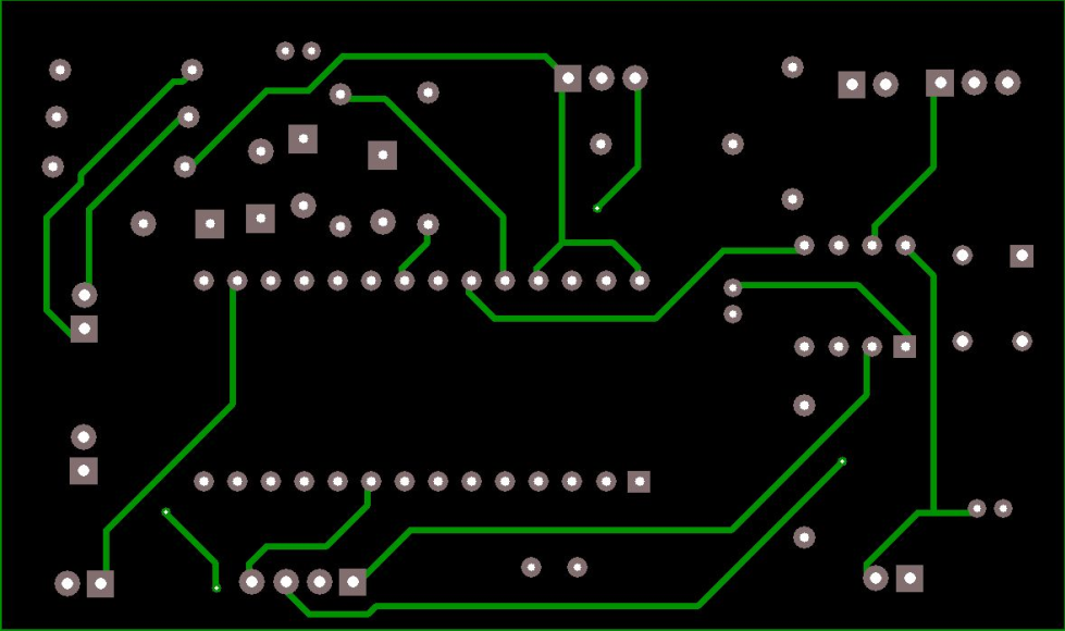

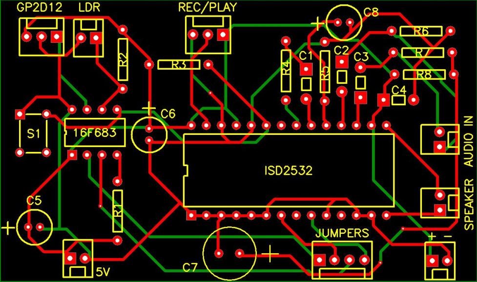

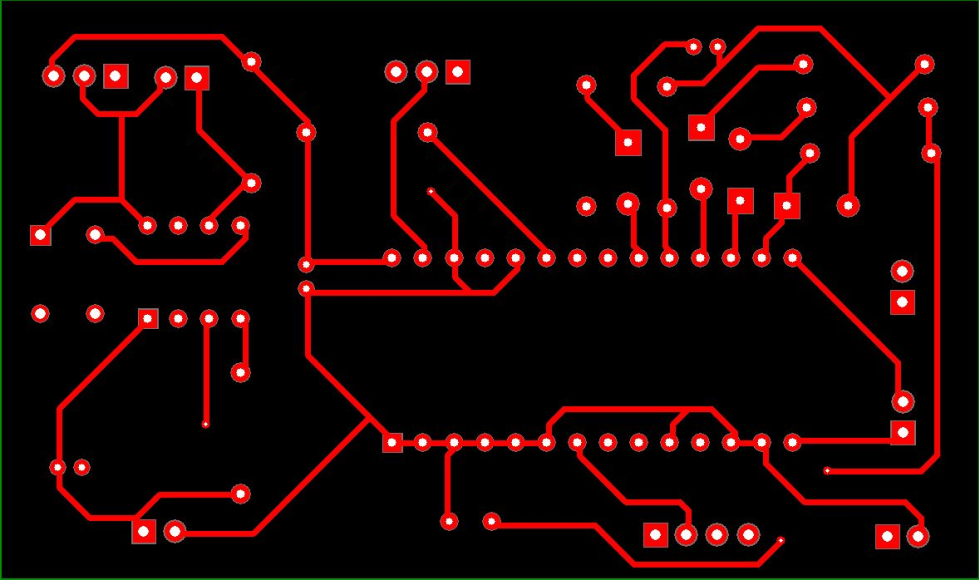

PCB
The PCB, which you can find it below, used for this Project is double layer and its size is 80.66 mm x 47.70 mm.

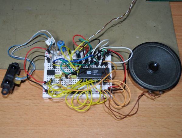

How it works
This circuit has 2 sensors. One motion sensor ( Sharp GP2D12 ) and a light sensor ( LDR ). The microcontroller monitors both sensors and triggers the sound chip in certain conditions.
Every time the circuit is powered on, the microcontroller stores the distance read by the sharp sensor and uses this as reference for the space available for object/people detection. Anything moving in front of the sensor up to that reference activates the first stored sound.
The other 3 sounds are time triggered only when the light is out. The LDR senses the light intensity and only when placed in darkness it will activate the remaining sounds. Sometimes the sounds are individually played and sometimes combined. There are 4 sounds slots available with max. length of 6 seconds each.
How to record sounds
The PCB has some connectors with jumpers making it possible to change from record to playback mode and vice versa.
Connector #1 named REC/PLAY is a 3 pin connector and jumper connection must be placed to the left side for record mode or to the right side for playback mode.
Also connector #2 named Jumpers must have 2 jumpers installed for playback mode. This is responsible for the memory address of the sounds.
When in record mode, some wire jumper connections must be made to change the address of the recordings manually connecting pin 2 and 3 to VDD or VSS according to table bellow:
table
For VDD and VSS connections it’s possible to use connector named + –
Recording: With power off, connect a microphone, move jumper to record mode and connect message pin 2 and pin 3 to VSS.
  • Turn on the power and prepare the sound you wish to record for #1 sound.
  • Press and keep the S1 push button while recording. Release the button to stop recording.
  • Connect pin 2 to VDD and keep pin 3 to VSS – this will address sound #2.
  • Connect pin 2 to VSS and pin 3 to VDD – this will address sound #3.
  • Connect pin 2 to VDD and keep pin 3 to VDD – this will address sound #4.
  • Turn the power off, disconnect microphone, restore address jumpers and move jumper to playback mode.

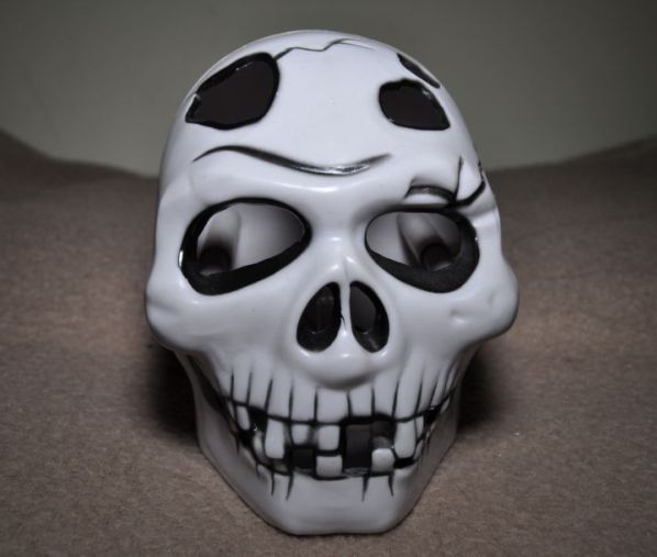

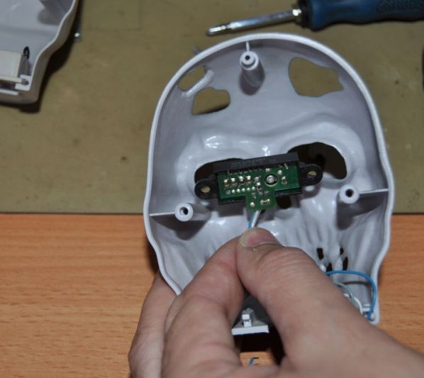

After soldering all components on the PCB and once all sounds are recorded it’s time to get it inside a box. I’ve found the perfect box for this project… this skull.
Photo_2
Photo_3
Placing the motion sensor in the eye section.

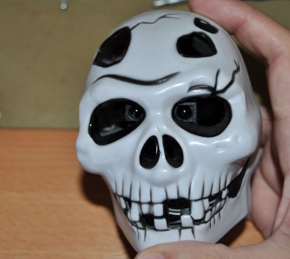

Photo_4
The sharp sensor adds a crazy eyes look to this skull.

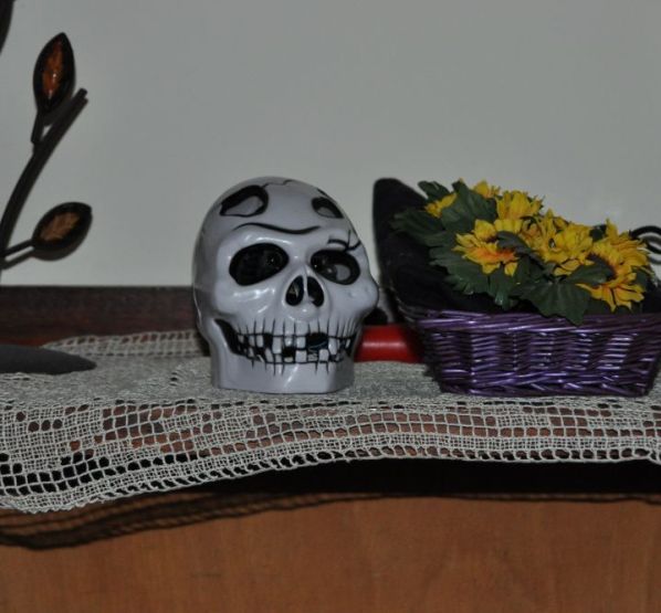

Photo_5
The skull is ready to make some noise and scare the visitors.
