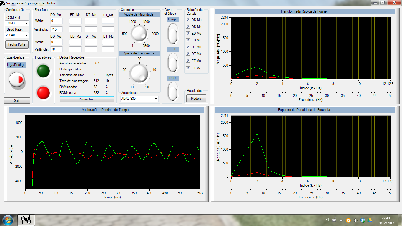

Screenshot
This project is an accelerometer data acquisition system for automotive suspension analysis. In other words it’s a low frequency spectrum analyzer based on Lanchpad TIVA Series from Texas Semiconductors.

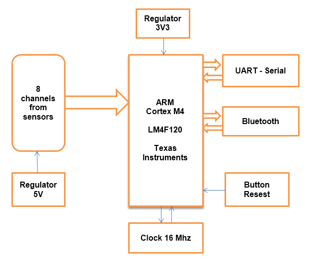

The system is based in 3 parts:
  • the GUI (user interface),
  • the hardware (core is a LM4F120 that is an ARM of Texas Instruments) and
  • accelerometers (in my case, needed for vibration analysis).

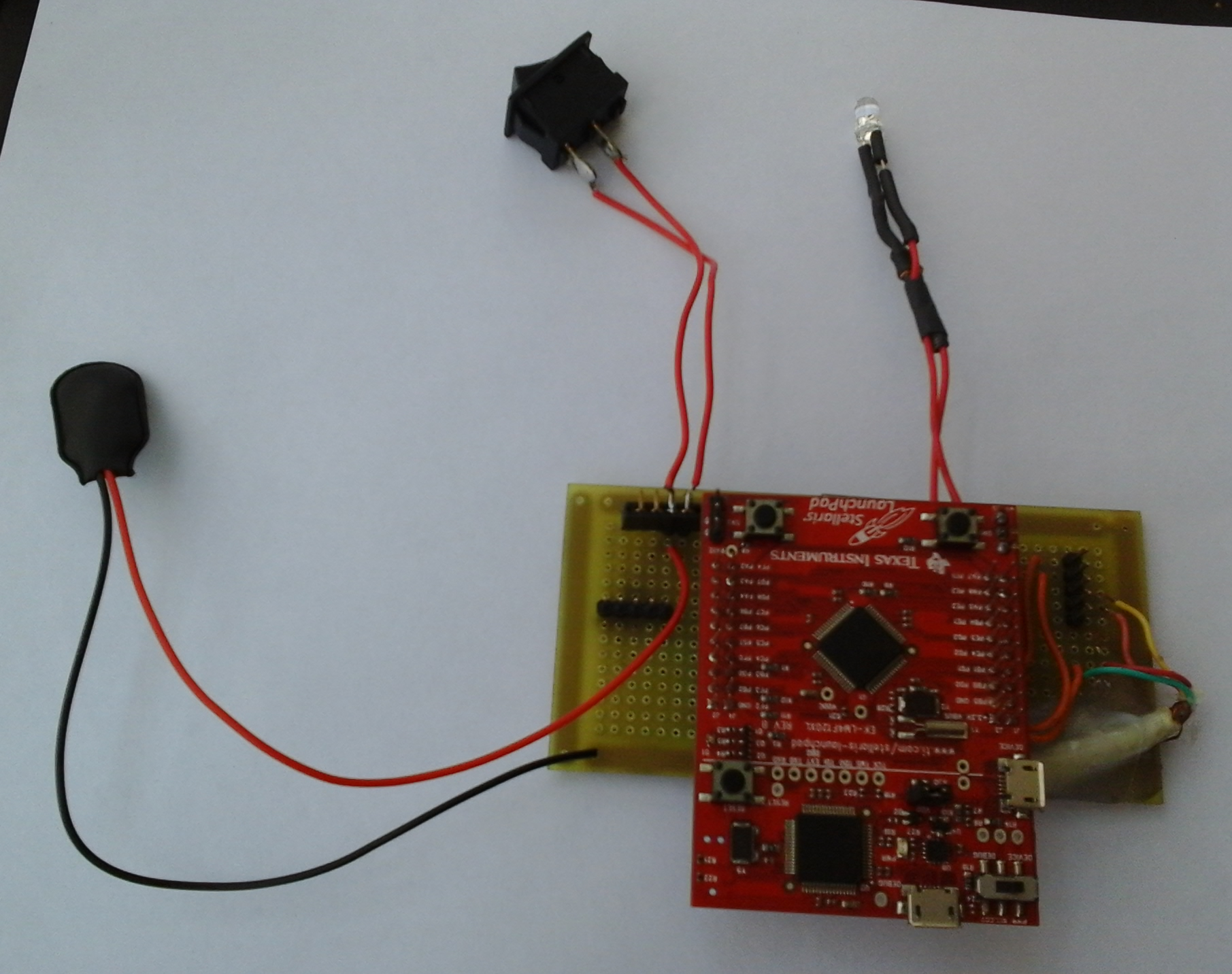

The hardware contains two voltage regulators (3.3V, 5V), 8 connectors for AD, 1 channel for serial protocol, 1 channel for Bluetooth, and one reset button. System status is displayed using three LEDs and a one LED is for 5V power supply indication.
The main component is the ARM processor. The firmware, contains a FIR low pass filter with 75 Hz cutoff frequency , sample frequency is 512 Hz, 256 points FFT and Power Density Spectrum based on Welch Method.

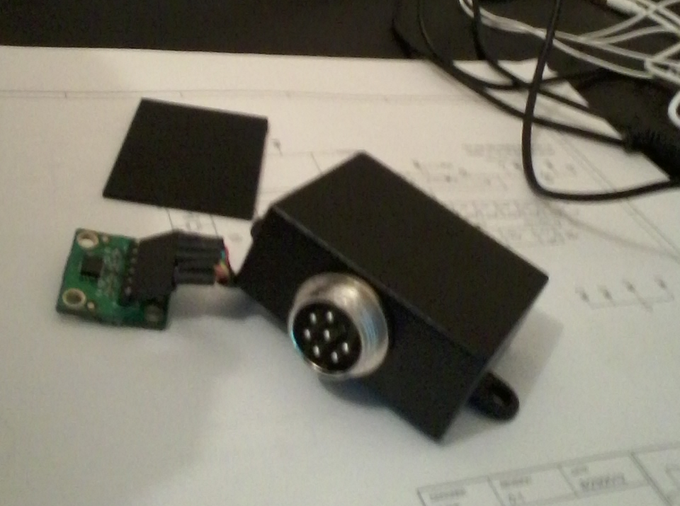

The accelerometers used are 4x ADXL 335 (+/- 3g) and 4x ADXL 325 (+/- 2g) with 3V supply voltage.
system_diagram
photo_1
LaunchPad_th
Accelerometer_th

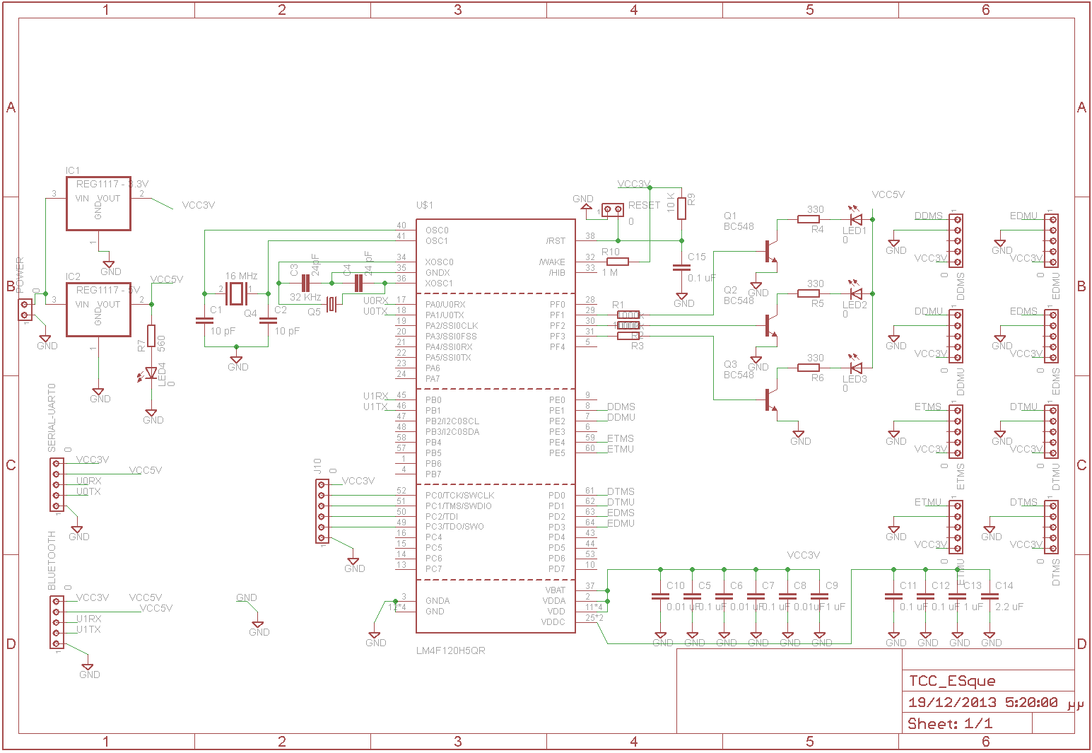

Schematic
Schematic
ADXL335
connection of ADXL335 to MCU

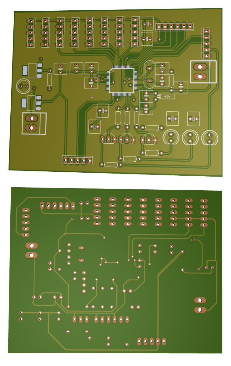

3D_PCB
3D PCB rendering
photo_2
manufactured PCB
