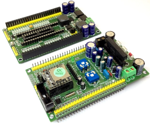

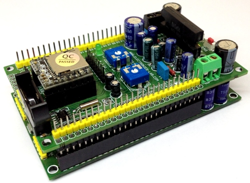

MP3 Shield has been designed for various applications related to voice record and play using MP3 module with memory card storage, this shield can be used as standalone mode or Digital mode by serial interface. In standalone mode it can play 16 messages with couple of other functions, Standalone operation possible by connecting resistors and push switches on ADC pins of the module check data sheet for switch connections.  Digital mode provides full control of messages with serial interface. Shield also has DS1307 RTC on board to develop a taking clock or other time related applications. Board has dual audio outputs, single channel 3W direct speaker output from MP3 Module and On board 5W Stereo Amplifier based on BA5406 provided to Amplify low audio signal coming from MP3 module. 4 Tact switch with open header connector can be interface to any port of micro-controller using female to female wire harness. RC6, RC7 and RC5 pin connected to micro-controller for serial interface. DS1307 RTC pins are connected to RA0 and RA1 Port pins. Refer data sheet for Module Serial Interface, switch connections circuit for stand-alone mode.
This module is a shield for 28/40 Pin PIC Development Board

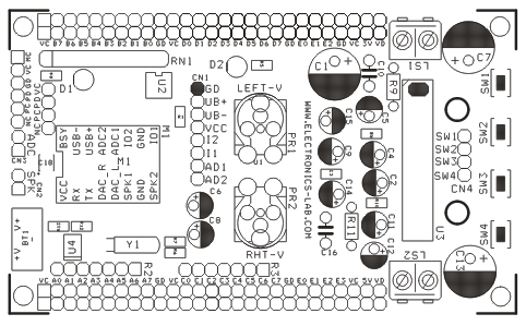

  • CN2 Connector: Direct Speaker Connection to MP3 Module
  • Additional 5W Stereo Audio Amplifier for Power Full Sound
  • The audio data is sorted by folder; supports up to 100 folders, each folder can be assigned to 1000 Songs
  • 30 levels volume adjustable, 10 levels EQ adjustable.
  • RCT DS1307 Connected to VCC 5V DC of the Shield
  • Speaker 8 Ohms, LS1, LS2 Screw Terminal for Speaker Connections
  • D1 Busy LED
  • D2 Power LED
  • R3, R2, RN1 (Resistor network Optional can be used as pull ups as per application requirement)
  • PR1 Left channel Audio Volume Control Trimmer Potentiometer
  • PR2 Right Channel Audio Volume Control Trimmer Potentiometer
  • SW1-SW4 Push Type Tact Switches Can be used as per requirement
  • BT1 3V Battery Holder for RTC
  • CN1 : USB Interface, ADC Connections for Switches ( Stand Alone Mode)

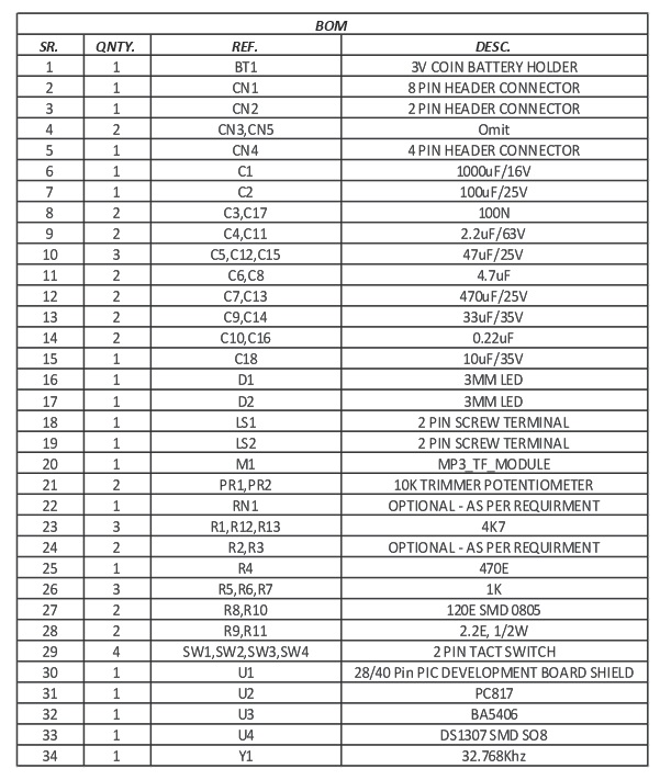

Parts List
