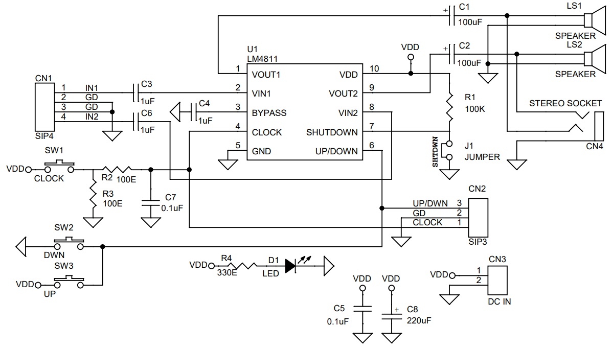

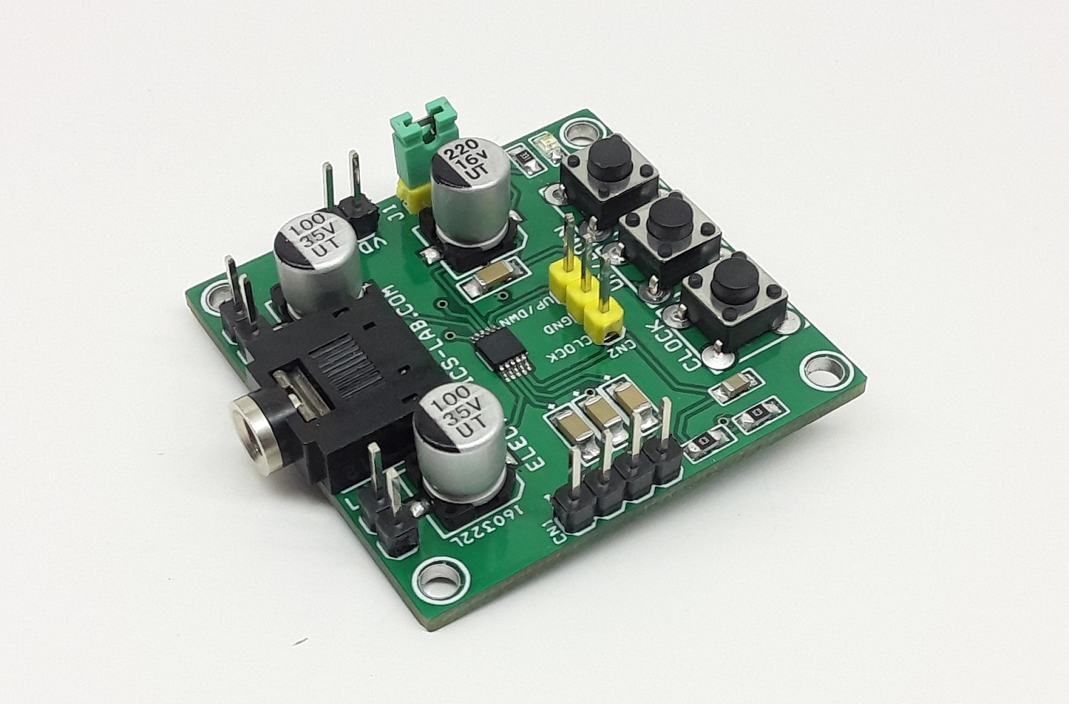

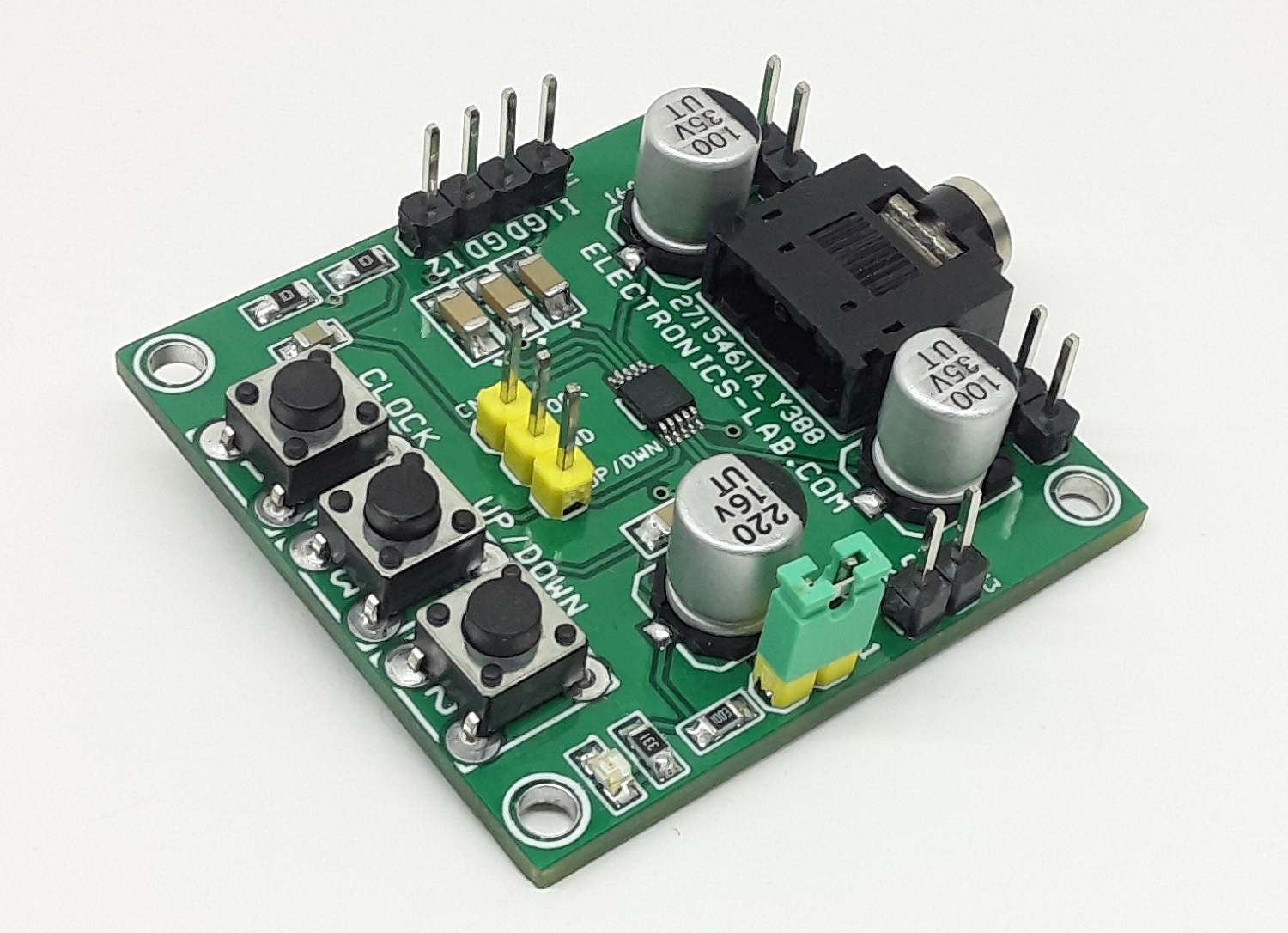

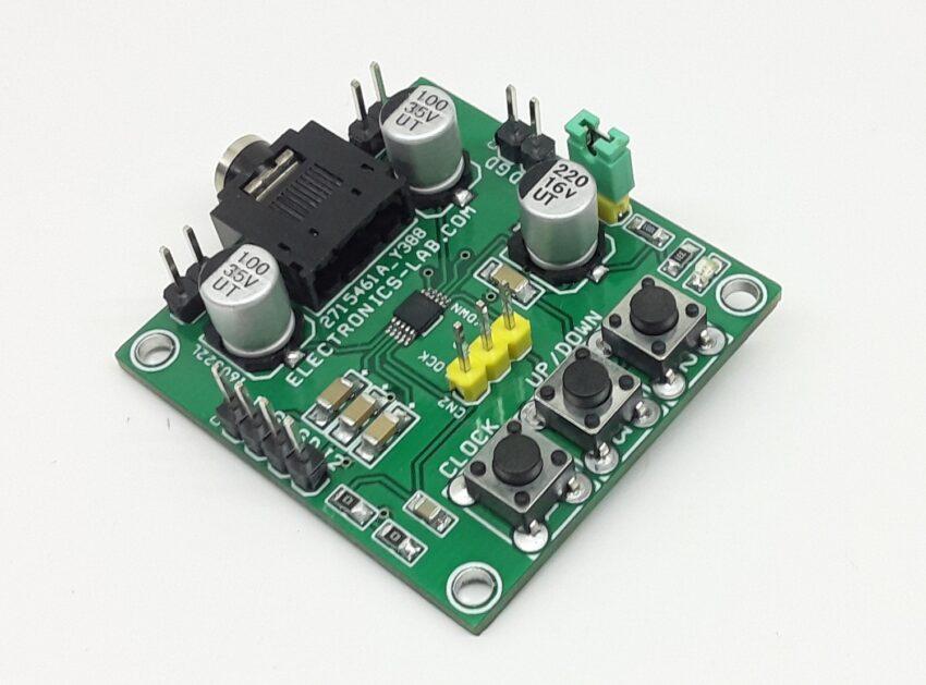

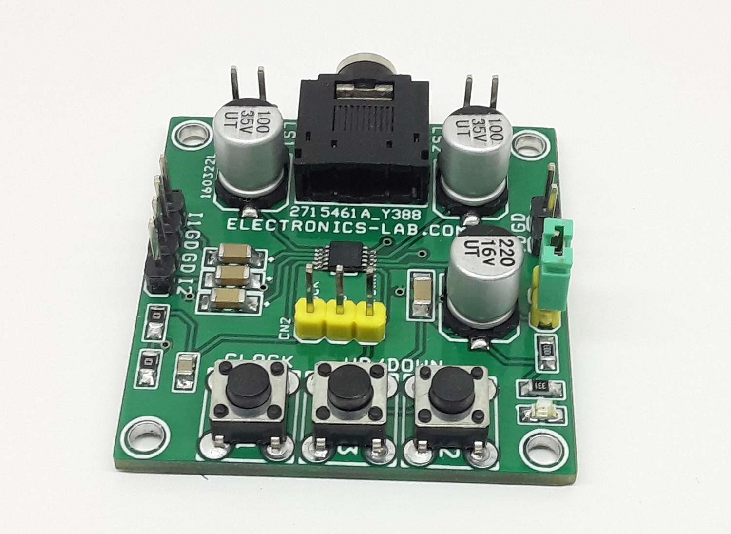

This is a low noise Headphone Amplifier capable of delivering 105mW per channel of continuous average power into a 16Ω load with 0.1% (THD+N) from a 5V power supply. The project is based on the LM4811 chip from the boomer series.
This is a low noise Headphone Amplifier capable of delivering 105mW per channel of continuous average power into a 16Ω load with 0.1% (THD+N) from a 5V power supply. The project is based on the LM4811 chip from the boomer series. The board provides high-quality output power with a minimal number of external components. It features a digital volume control that sets the amplifier’s gain from +12dB to −33dB in 16 discrete steps using a two−wire interface or onboard 3 tactile switches. On-board jumper implements the shutdown feature. The chip also has an internal thermal shutdown protection mechanism.

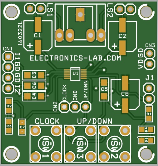

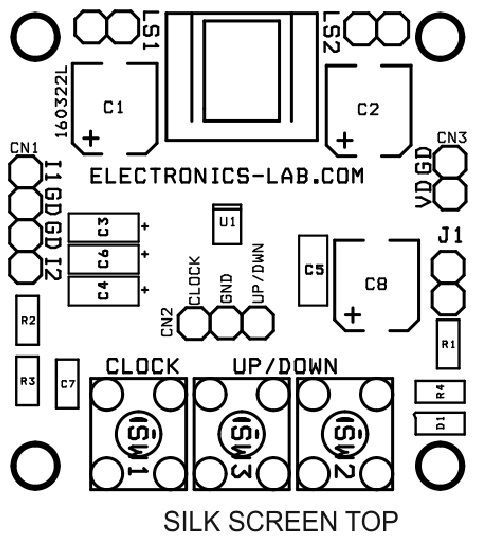

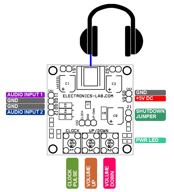

Connector CN1 Audio Input
- Pin 1 Audio Signal Input 1
- Pin 2 GND
- Pin 3 GND
- Pin 4 Audio Signal Input 2
Connector CN3 Power Supply
- Pin 1 +5V DC Input
- Pin 2 GND
Others
- Connector LS1 and LS2: Optional Speaker or Headphone Connection
- Connector CN4: 3.5MM Stereo EP Female socket for Headphone
- Connector CN2: External/Optional 2 Wire Gain Control
- Jumper J1: Closes = Enable, J1 Open Shutdown
- LED D1: Power LED
- Switch 1: Clock Input, Increment Steps
- Switch 2: Volume Down Operation
- Switch 3: Volume Up Operation
- Operating Power Supply 5V DC
- Output 105mW Stereo
- On-Board Power LED
- Digital Volume Control Range from +12dB to −33dB
- “Click and Pop” Suppression Circuitry
- THD+N at 1kHz, 105mW Continuous Average Output Power into 16Ω 0.1 % (typ)
- THD+N at 1kHz, 70mW Continuous Average Power into 32Ω 0.1 % (typ)
- Low Shutdown Current
- 3 Tactile Switches to set the Gain
- Optional 3 Pin Header Connector for 2 Wire Interface for Micro-Controller for Gain
- On-Board Stereo EP Socket for Easy Headphone Interface
- Optional 2 x Header Connector for Headphone/Speaker Connections
- Header Connector for Power Supply
- Jumper for Shutdown

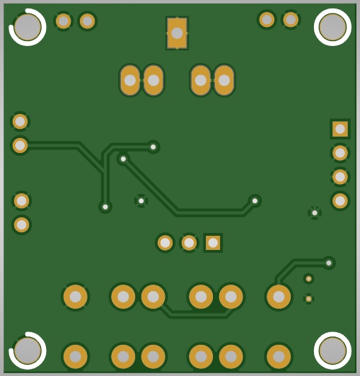

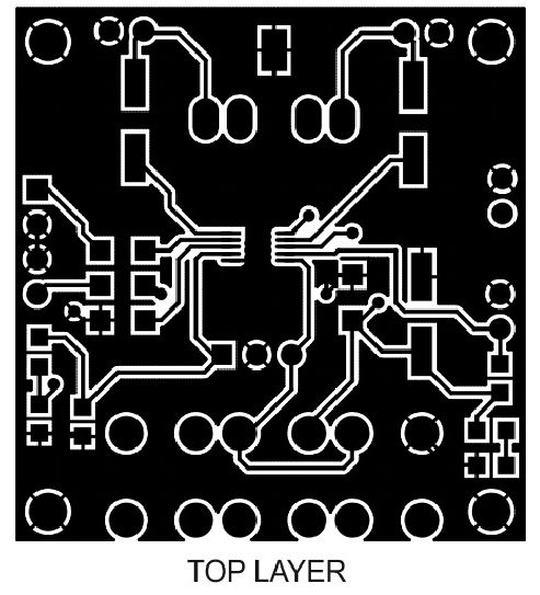

- PCB Dimensions 39.21 x 37.47 mm
- 4 x 2.5MM Mounting Holes
Schematic

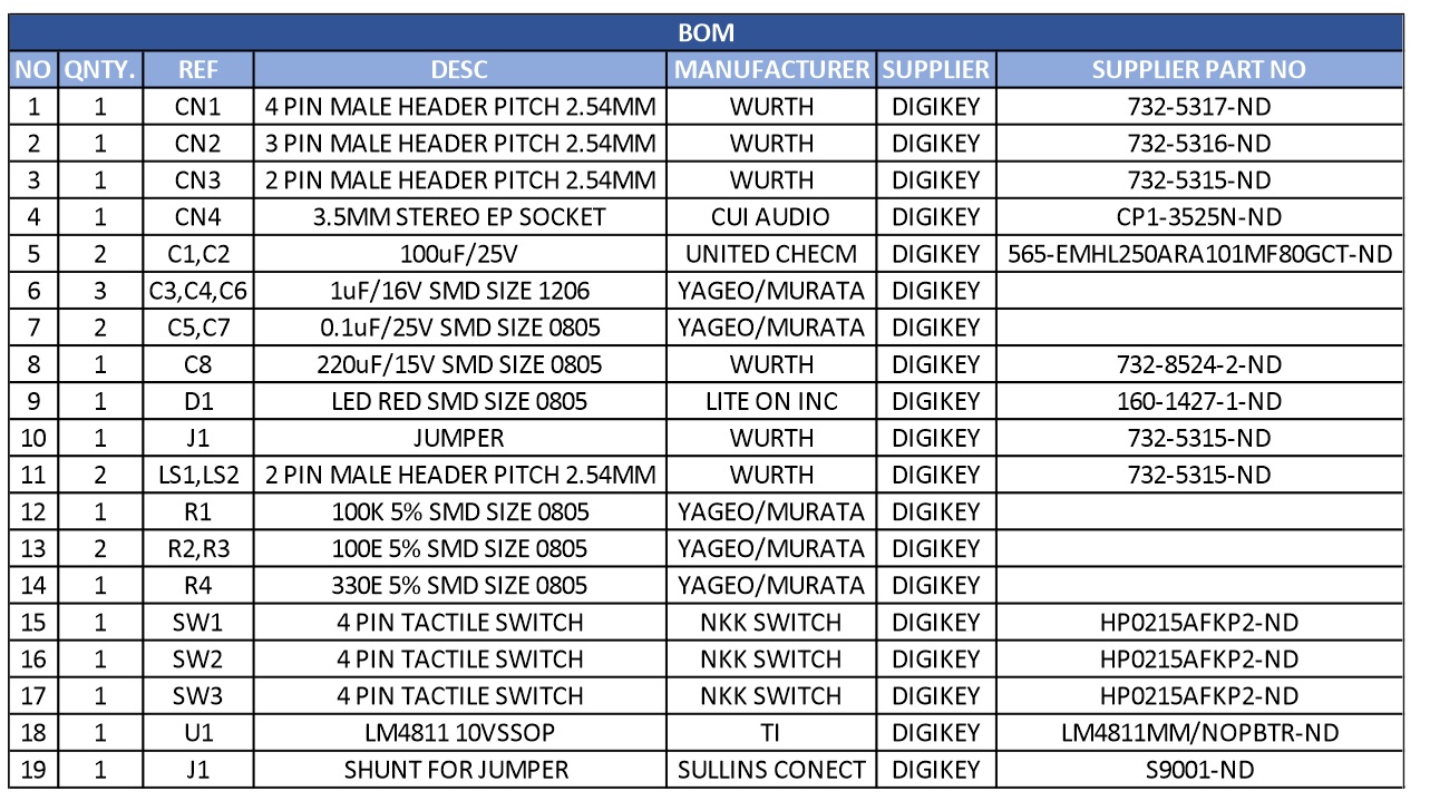

Parts List
| NO | QNTY. | REF | DESC | MANUFACTURER | SUPPLIER | PART NO |
| 1 | 1 | CN1 | 4 PIN MALE HEADER PITCH 2.54MM | WURTH | DIGIKEY | 732-5317-ND |
| 2 | 1 | CN2 | 3 PIN MALE HEADER PITCH 2.54MM | WURTH | DIGIKEY | 732-5316-ND |
| 3 | 1 | CN3 | 2 PIN MALE HEADER PITCH 2.54MM | WURTH | DIGIKEY | 732-5315-ND |
| 4 | 1 | CN4 | 3.5MM STEREO EP SOCKET | CUI AUDIO | DIGIKEY | CP1-3525N-ND |
| 5 | 2 | C1,C2 | 100uF/25V | UNITED CHECM | DIGIKEY | 565-EMHL250ARA101MF80GCT-ND |
| 6 | 3 | C3,C4,C6 | 1uF/16V SMD SIZE 1206 | YAGEO/MURATA | DIGIKEY | |
| 7 | 2 | C5,C7 | 0.1uF/25V SMD SIZE 0805 | YAGEO/MURATA | DIGIKEY | |
| 8 | 1 | C8 | 220uF/15V SMD SIZE 0805 | WURTH | DIGIKEY | 732-8524-2-ND |
| 9 | 1 | D1 | LED RED SMD SIZE 0805 | LITE ON INC | DIGIKEY | 160-1427-1-ND |
| 10 | 1 | J1 | JUMPER | WURTH | DIGIKEY | 732-5315-ND |
| 11 | 2 | LS1,LS2 | 2 PIN MALE HEADER PITCH 2.54MM | WURTH | DIGIKEY | 732-5315-ND |
| 12 | 1 | R1 | 100K 5% SMD SIZE 0805 | YAGEO/MURATA | DIGIKEY | |
| 13 | 2 | R2,R3 | 100E 5% SMD SIZE 0805 | YAGEO/MURATA | DIGIKEY | |
| 14 | 1 | R4 | 330E 5% SMD SIZE 0805 | YAGEO/MURATA | DIGIKEY | |
| 15 | 1 | SW1 | 4 PIN TACTILE SWITCH | NKK SWITCH | DIGIKEY | HP0215AFKP2-ND |
| 16 | 1 | SW2 | 4 PIN TACTILE SWITCH | NKK SWITCH | DIGIKEY | HP0215AFKP2-ND |
| 17 | 1 | SW3 | 4 PIN TACTILE SWITCH | NKK SWITCH | DIGIKEY | HP0215AFKP2-ND |
| 18 | 1 | U1 | LM4811 10VSSOP | TI | DIGIKEY | LM4811MM/NOPBTR-ND |
| 19 | 1 | J1 | SHUNT FOR JUMPER | SULLINS CONECT | DIGIKEY | S9001-ND |
Connections
