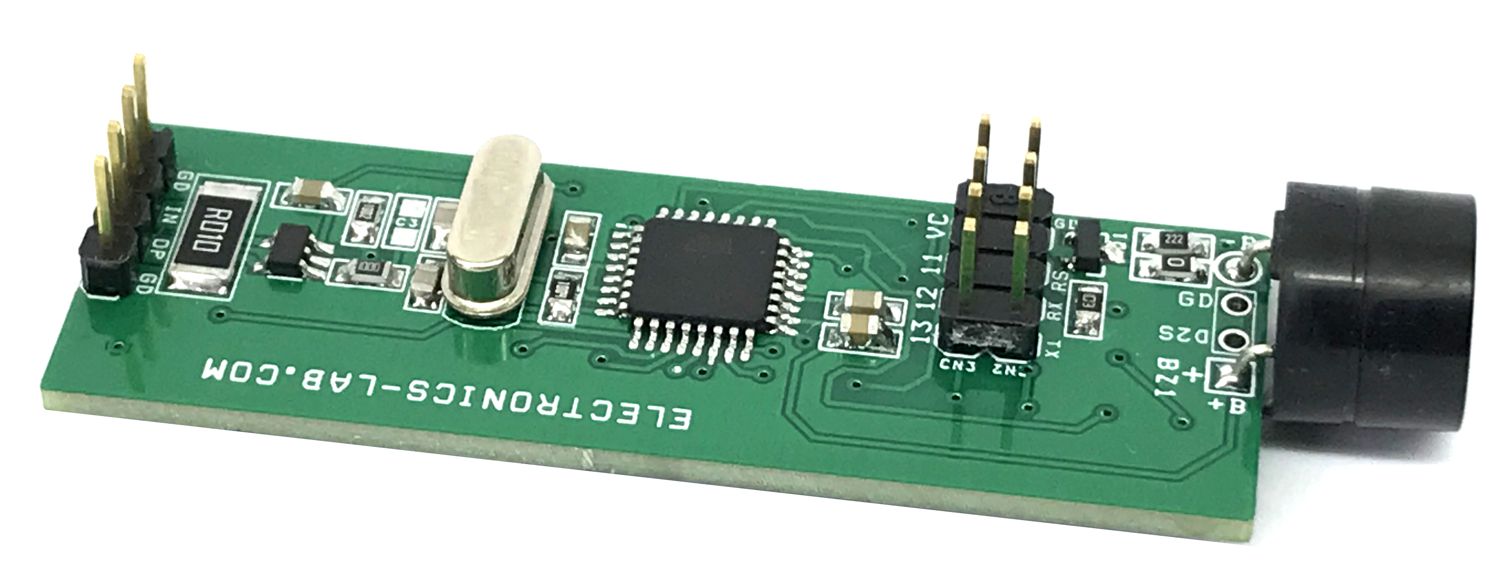

This Bar-Graph Display provides a high visibility 15-Segment Bar-Graph display for current measurements. A buzzer provides audible sound when an over-current condition event occurs.

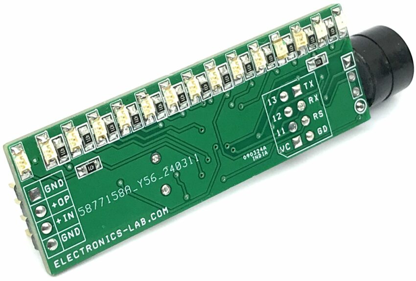

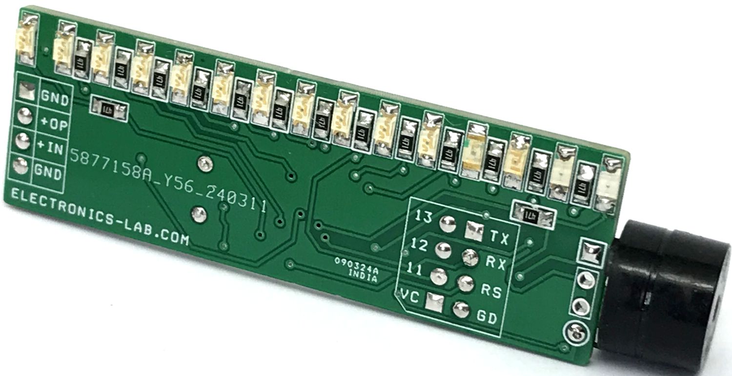

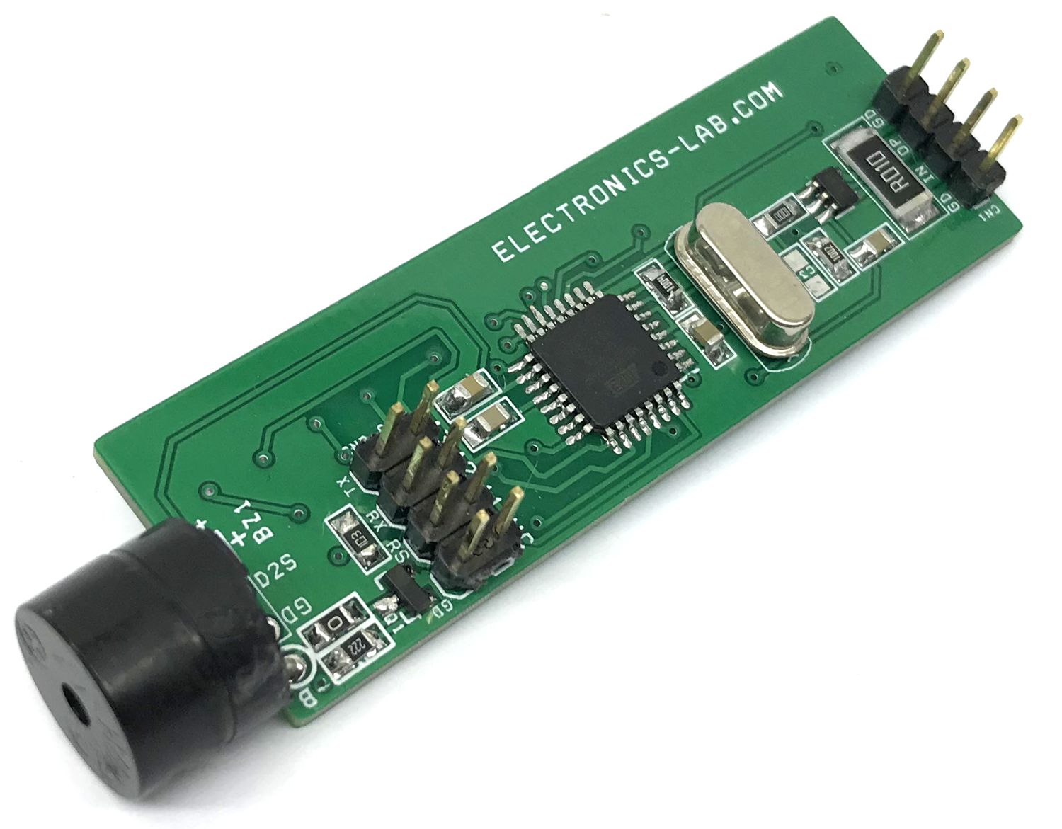

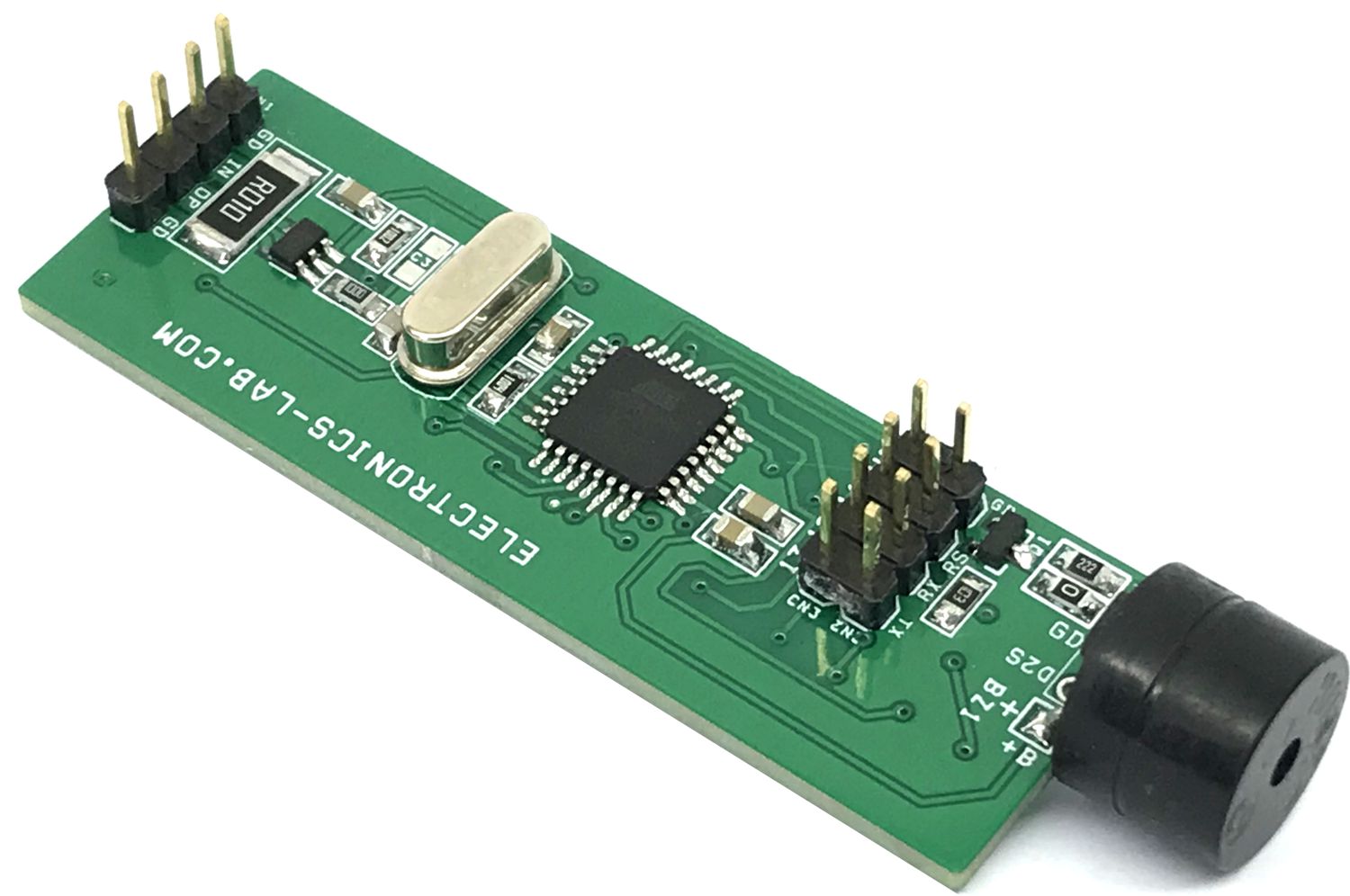

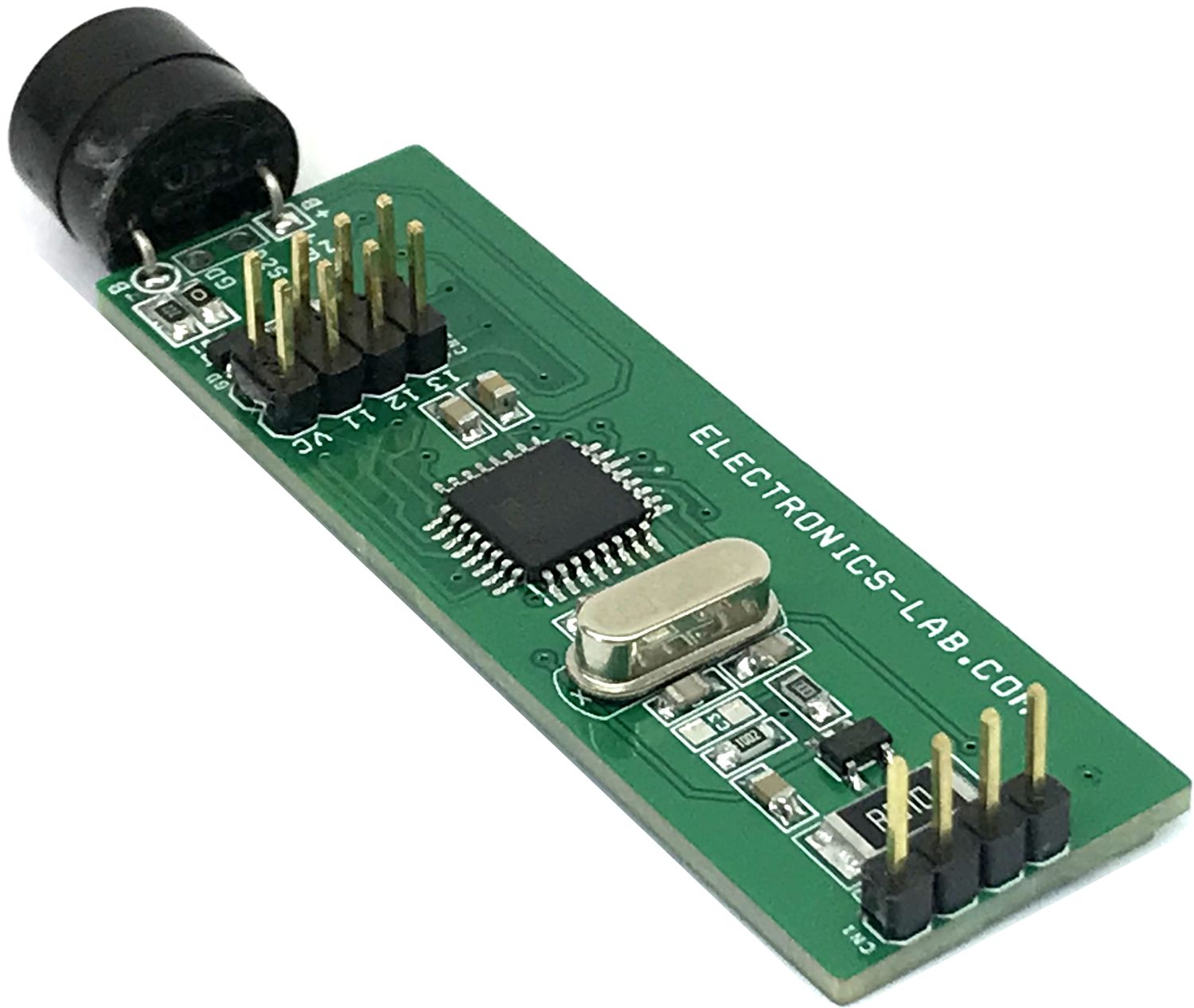

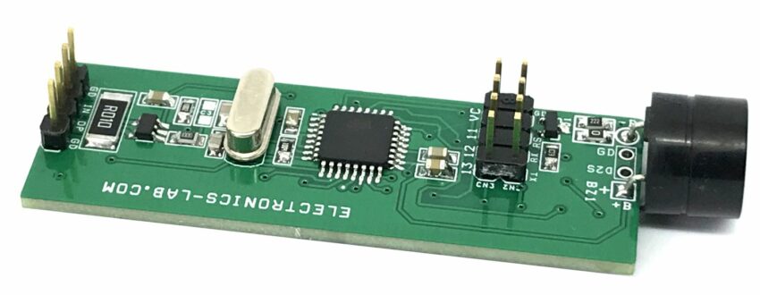

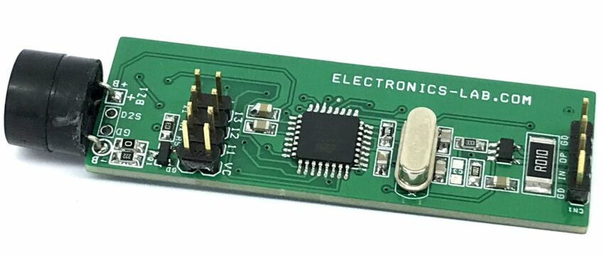

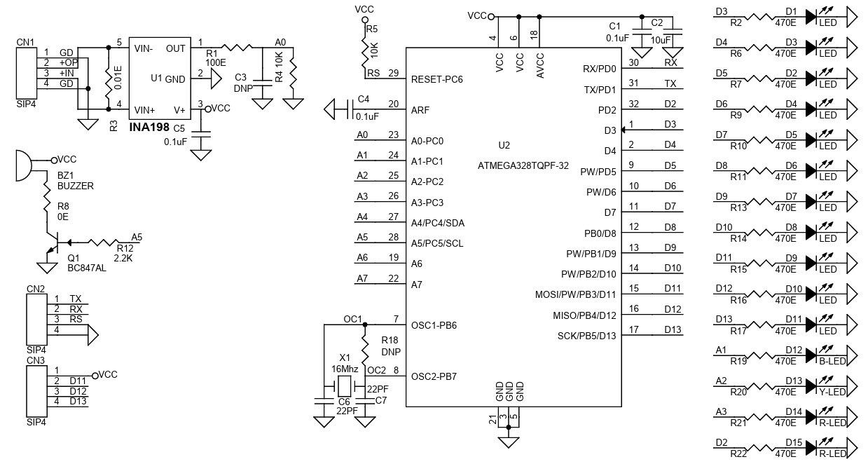

This Bar-Graph Display provides a high visibility 15-Segment Bar-Graph display for current measurements. A buzzer provides audible sound when an over-current condition event occurs. The 15 segments are made with Red, Blue, Green, and yellow color LEDS. All LEDs are SMD size 1206. This tiny board can display 0 to 2A current and provide an Alarm sound when the current level goes more than 2A. The project is Arduino-compatible and is based on an ATMEGA328 chip. INA198 chip measures the load current across the shunt resistor and provides an output voltage to ADC of ATMEGA328. The microcontroller drives and controls the 15 LEDs connected to I/O lines.

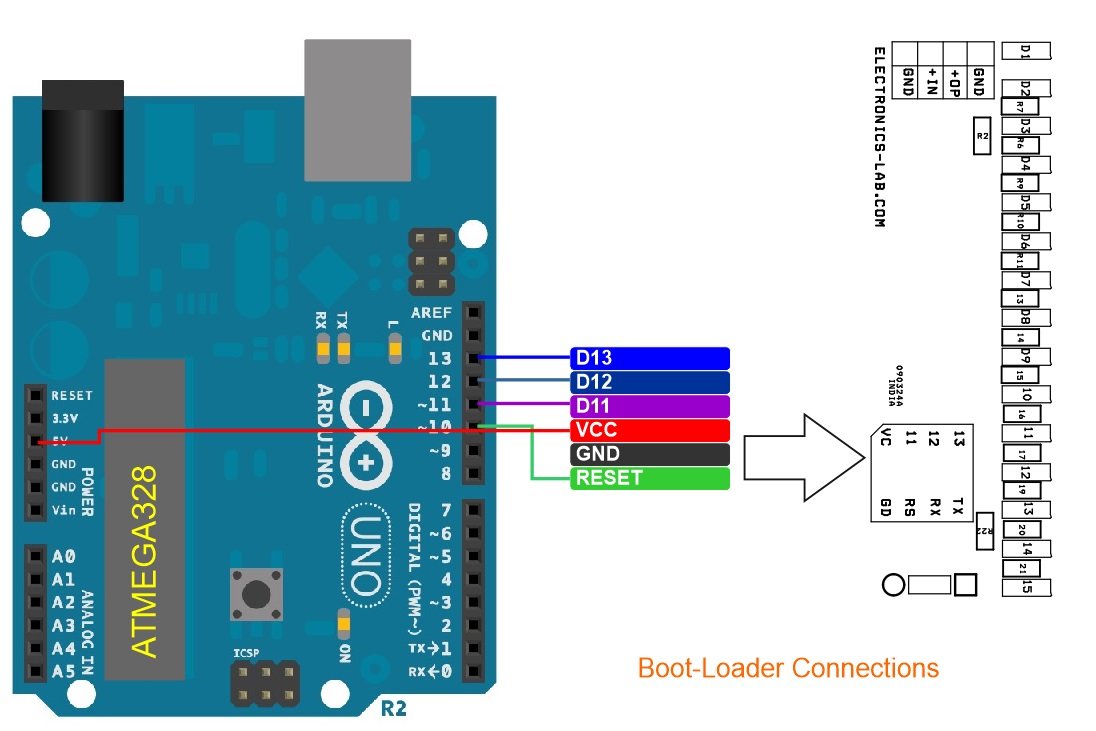

The project is Arduino-compatible. Connectors CN2 and CN3 are provided for Arduino programming and boot-loader. An example Arduino code is available as a download. Users may modify and write their code. Refer to the diagrams below for Bootloader and Arduino programming connection. Each LED display consumes approx. 125mA current and the ADC Map values to 15Leds + Buzzer.
- Power 5V DC
- 15 Bar-Graph LEDs (Red. Green, Blue, Yellow Colour)
- Buzzer for Over Current
- INA198 Current to Voltage Converter Chip
- Arduino Compatible Project
- Header Connector for Current Measurement
- Header Connector for Arduino Programming and Bootloader
- PCB Dimensions 59.37 x 19.84mm

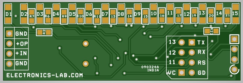

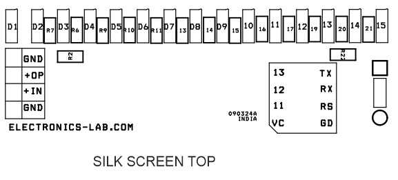

Connections
- CN1: Pin 1 = GND, Pin 2 = +OP to Load, Pin 3 = +In, Pin 4 = GND
- CN2: Pin 1 = TX, Pin 2 = TX, Pin 3 = Reset, Pin 4 = GND, (Programming Connector)
- CN3: Pin 1 = VCC 5V, Pin 2 = D11, Pin 3 = D12, Pin 4 = D13 (Programming Connector)
- Arduino Pins: Buzzer A5, Analog Current Sense Input = A0
- Bar-Graph LED Vs Arduino Pins: LED 1 = D3, LED 2 = D5, LED 3 = D4, LED 4 = D6, LED 5 = D7, LED 6 = D8, LED 7 = D9, LED 8 = D10, LED 9 = D11, LED 10 = D12, LED 11 = D13, LED 12 = A1, LED 13 = A2, LED 14, A3, LED 15 = D2
Arduino Programming
Schematic

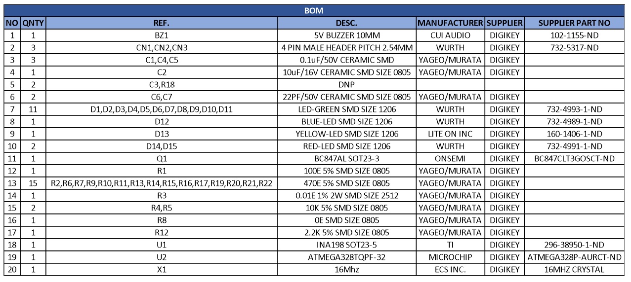

Parts List
| NO | QNTY | REF. | DESC. | MANUFACTURER | SUPPLIER | SUPPLIER PART NO |
| 1 | 1 | BZ1 | 5V BUZZER 10MM | CUI AUDIO | DIGIKEY | 102-1155-ND |
| 2 | 3 | CN1,CN2,CN3 | 4 PIN MALE HEADER PITCH 2.54MM | WURTH | DIGIKEY | 732-5317-ND |
| 3 | 3 | C1,C4,C5 | 0.1uF/50V CERAMIC SMD | YAGEO/MURATA | DIGIKEY | |
| 4 | 1 | C2 | 10uF/16V CERAMIC SMD SIZE 0805 | YAGEO/MURATA | DIGIKEY | |
| 5 | 2 | C3,R18 | DNP | |||
| 6 | 2 | C6,C7 | 22PF/50V CERAMIC SMD SIZE 0805 | YAGEO/MURATA | DIGIKEY | |
| 7 | 11 | D1 to D11 | LED-GREEN SMD SIZE 1206 | WURTH | DIGIKEY | 732-4993-1-ND |
| 8 | 1 | D12 | BLUE-LED SMD SIZE 1206 | WURTH | DIGIKEY | 732-4989-1-ND |
| 9 | 1 | D13 | YELLOW-LED SMD SIZE 1206 | LITE ON INC | DIGIKEY | 160-1406-1-ND |
| 10 | 2 | D14,D15 | RED-LED SMD SIZE 1206 | WURTH | DIGIKEY | 732-4991-1-ND |
| 11 | 1 | Q1 | BC847AL SOT23-3 | ONSEMI | DIGIKEY | BC847CLT3GOSCT-ND |
| 12 | 1 | R1 | 100E 5% SMD SIZE 0805 | YAGEO/MURATA | DIGIKEY | |
| 13 | 15 | R2,R6,R7,R9,R10,R11, R13 to R22 | 470E 5% SMD SIZE 0805 | YAGEO/MURATA | DIGIKEY | |
| 14 | 1 | R3 | 0.01E 1% 2W SMD SIZE 2512 | YAGEO/MURATA | DIGIKEY | |
| 15 | 2 | R4,R5 | 10K 5% SMD SIZE 0805 | YAGEO/MURATA | DIGIKEY | |
| 16 | 1 | R8 | 0E SMD SIZE 0805 | YAGEO/MURATA | DIGIKEY | |
| 17 | 1 | R12 | 2.2K 5% SMD SIZE 0805 | YAGEO/MURATA | DIGIKEY | |
| 18 | 1 | U1 | INA198 SOT23-5 | TI | DIGIKEY | 296-38950-1-ND |
| 19 | 1 | U2 | ATMEGA328TQPF-32 | MICROCHIP | DIGIKEY | ATMEGA328P-AURCT-ND |
| 20 | 1 | X1 | 16Mhz | ECS INC. | DIGIKEY | 16MHZ CRYSTAL |
