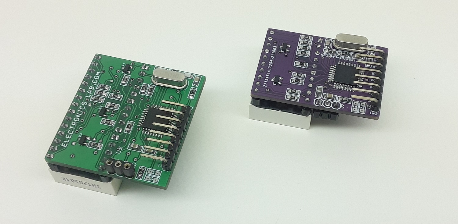

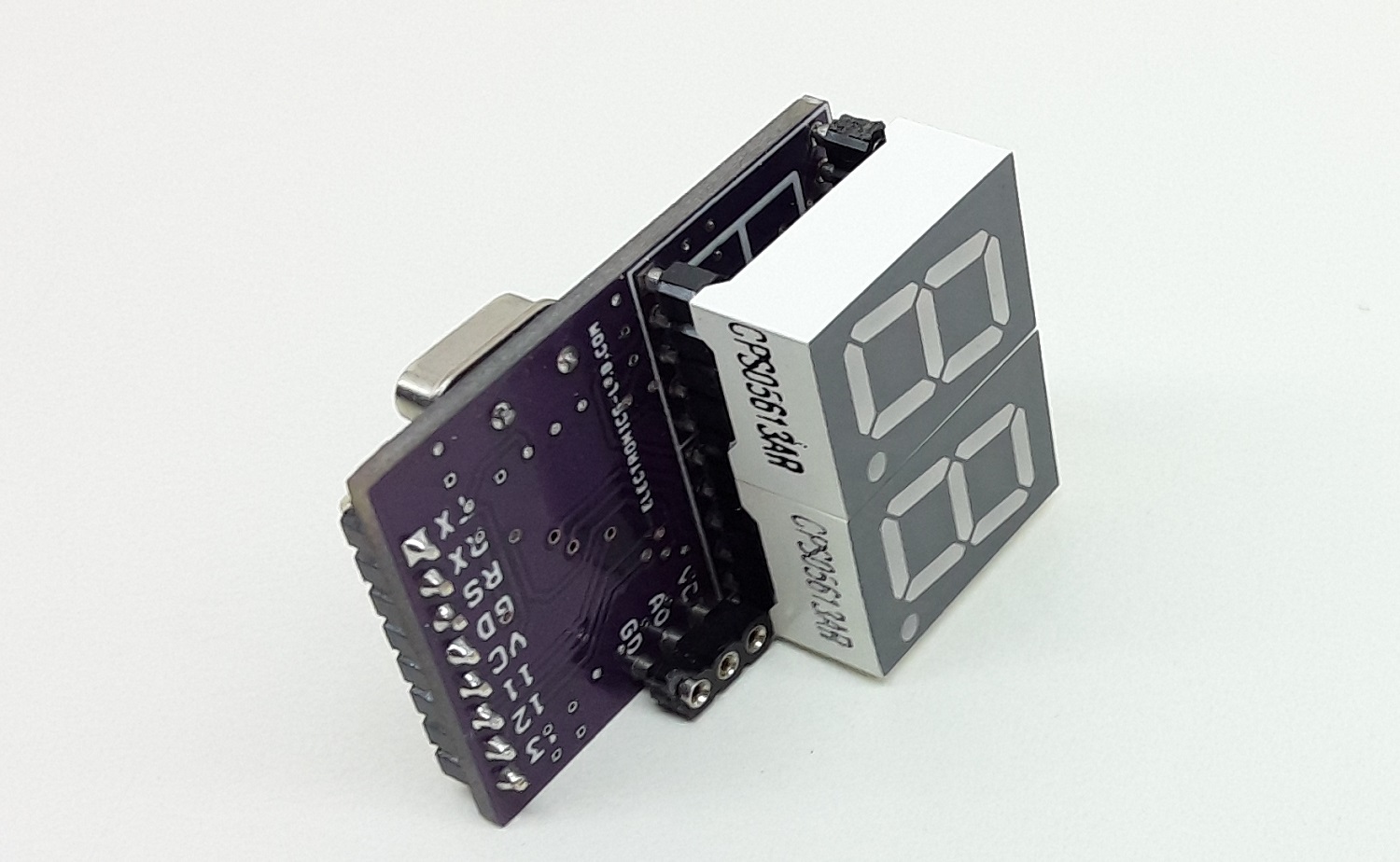

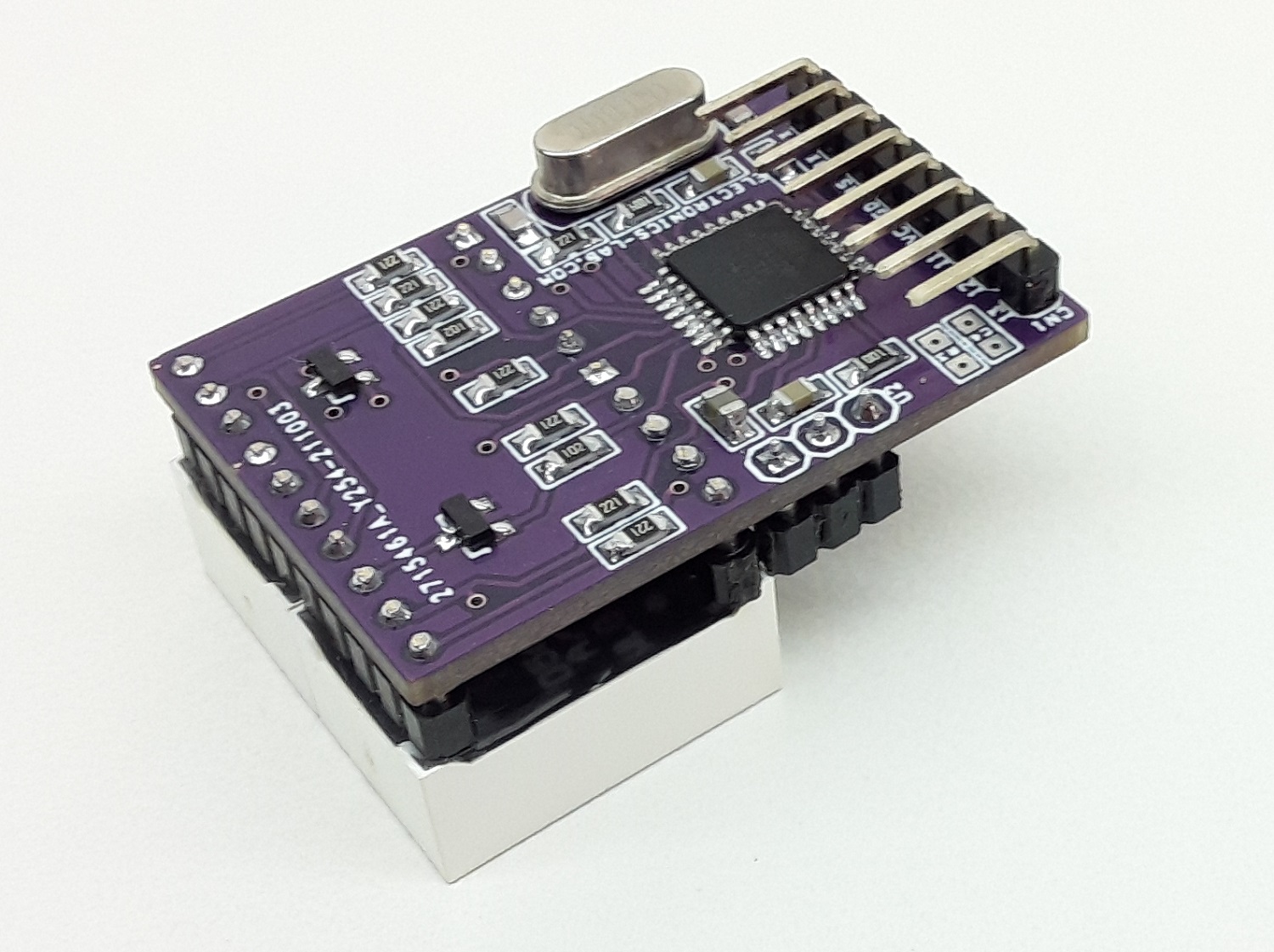

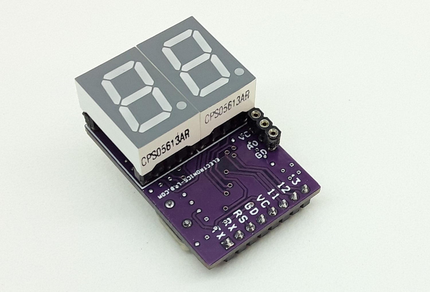

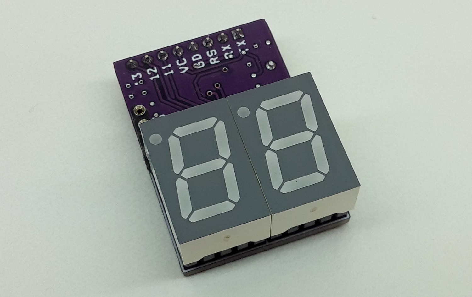

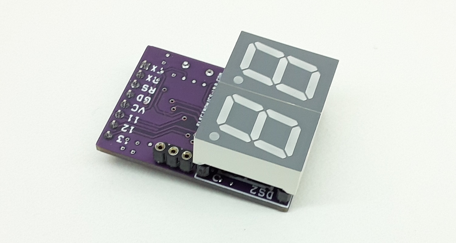

Arduino 2-Digit 0.5″ Common Cathode 7 Segment Display Module

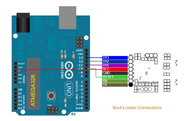

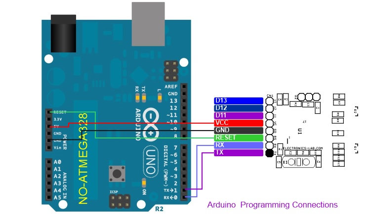

This is an Arduino compatible board for creating 2 Digit Display projects. The circuit operates with 5V DC, Connector CN1 is provided for bootloader programming and Arduino firmware upload.
This is an Arduino compatible board for creating 2 Digit Display projects. The circuit operates with 5V DC, Connector CN1 is provided for bootloader programming and Arduino firmware upload. A new Atmega328 chip requires a bootloader and Arduino firmware programming, Connector CN1 helps you with both functions. Follow the link below to learn more about programming using Arduino. Arduino code is available as a download to test the board.
Arduino Programming
From Arduino to a Microcontroller on a Breadboard: https://www.arduino.cc/en/Tutorial/BuiltInExamples/ArduinoToBreadboard

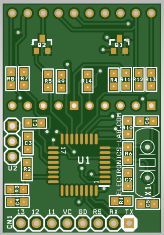

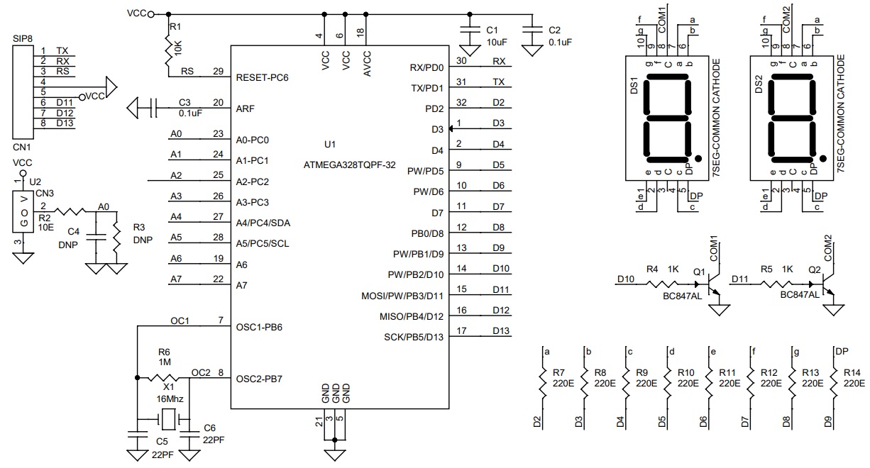

Arduino Compatible Hardware
- Atmega328 microcontroller
- 2 Digit 0.5 Inch 7 Segment Display, Common Cathode
- 2 x BC847 Transistors to drive Display Common Cathode for Multiplexing
- CN1: Arduino Programming and Boot-Loader Connector
- U2: 3 Pin Connector to Connect LM35 Temperature Sensor or Analog Input
- Current Limiting Resistors for 7 segment display and other components

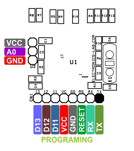

Arduino Pins
- Digital Pin D10 Display 1 Common Cathode
- Digital Pin D11 Display 2 Common Cathode
- Digital Pin D2 Display Segment A
- Digital Pin D3 Display Segment B
- Digital Pin D4 Display Segment C
- Digital Pin D5 Display Segment D
- Digital Pin D6 Display Segment E
- Digital Pin D7 Display Segment F
- Digital Pin D8 Display Segment G
- Digital Pin D9 Display Segment DP
- DIGITAL INPUTS D13, D12, D11, TX, RX
- ANALOG PIN A0 LM35 TEMPERATURE SENSOR OR ANALOG INPUT
- PROGRAMING D13, D12, D11, TX, RX, RESET
- Supply 5V DC can be optimized for 3.3V Operations
- LM35 Temperature Sensor, Analog Input A0

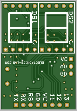

- Compact Hardware
- PCB Dimensions 37.78 x 26.04 mm

Schematic

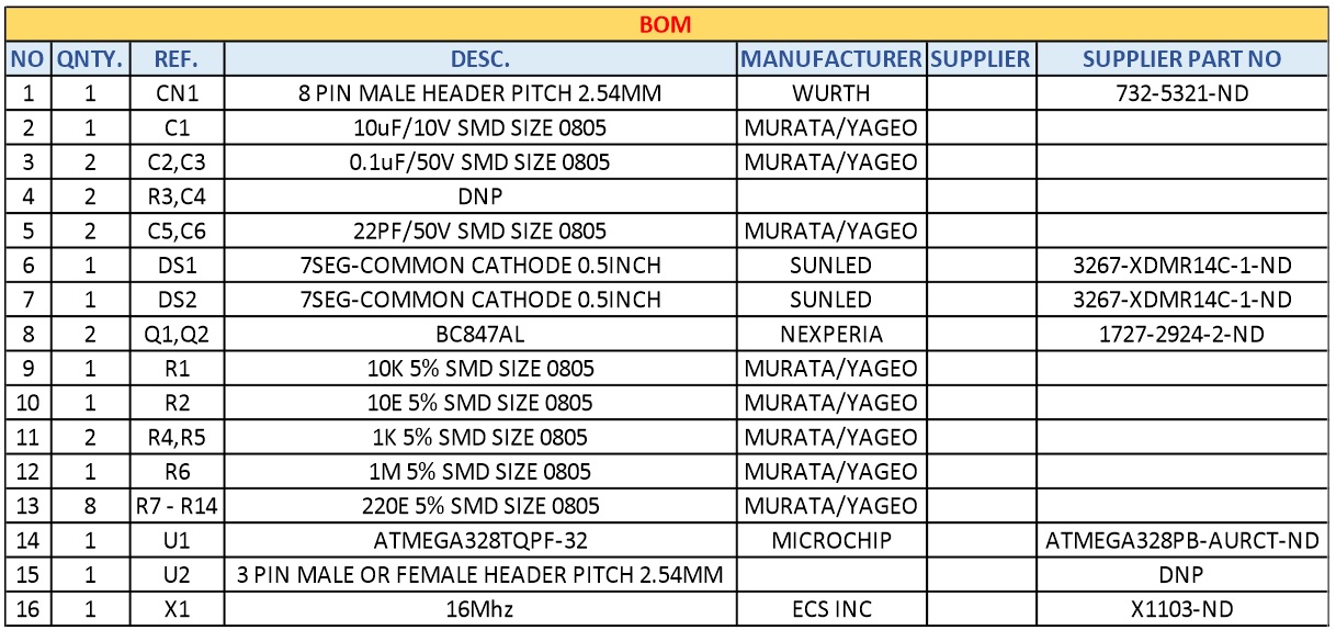

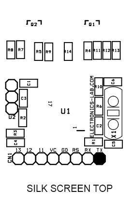

Parts List
| NO | QNTY. | REF. | DESC. | MANUFACTURER | SUPPLIER | PART NO |
| 1 | 1 | CN1 | 8 PIN MALE HEADER PITCH 2.54MM | WURTH | 732-5321-ND | |
| 2 | 1 | C1 | 10uF/10V SMD SIZE 0805 | MURATA/YAGEO | ||
| 3 | 2 | C2,C3 | 0.1uF/50V SMD SIZE 0805 | MURATA/YAGEO | ||
| 4 | 2 | R3,C4 | DNP | |||
| 5 | 2 | C5,C6 | 22PF/50V SMD SIZE 0805 | MURATA/YAGEO | ||
| 6 | 1 | DS1 | 7SEG-COMMON CATHODE 0.5INCH | SUNLED | 754-1705-5-ND or 754-1704-5-ND | |
| 7 | 1 | DS2 | 7SEG-COMMON CATHODE 0.5INCH | SUNLED | 754-1705-5-ND or 754-1704-5-ND | |
| 8 | 2 | Q1,Q2 | BC847AL | NEXPERIA | 1727-2924-2-ND | |
| 9 | 1 | R1 | 10K 5% SMD SIZE 0805 | MURATA/YAGEO | ||
| 10 | 1 | R2 | 10E 5% SMD SIZE 0805 | MURATA/YAGEO | ||
| 11 | 2 | R4,R5 | 1K 5% SMD SIZE 0805 | MURATA/YAGEO | ||
| 12 | 1 | R6 | 1M 5% SMD SIZE 0805 | MURATA/YAGEO | ||
| 13 | 8 | R7 - R14 | 220E 5% SMD SIZE 0805 | MURATA/YAGEO | ||
| 14 | 1 | U1 | ATMEGA328TQPF-32 | MICROCHIP | ATMEGA328PB-AURCT-ND | |
| 15 | 1 | U2 | 3 PIN MALE OR FEMALE HEADER PITCH 2.54MM | DNP | ||
| 16 | 1 | X1 | 16Mhz | ECS INC | X1103-ND |
Connections
