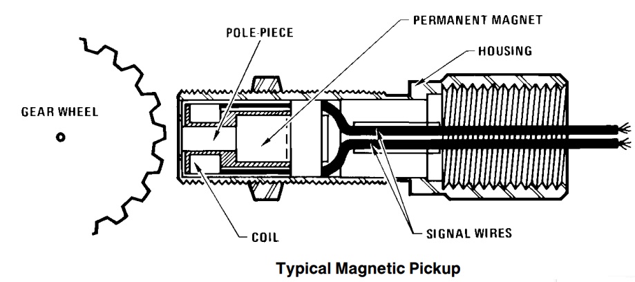

Magnetic Pickup Sensor
A Magnetic Pickup Sensor consists of a permanent magnet, a pole-piece, and a sensing coil all encapsulated in a cylindrical case. Magnetic Pickup is most frequently used to sense passing teeth on a gear, sprocket, or timing belt wheel, to bolt-heads, key-ways, or other moving machine-mounted targets.
