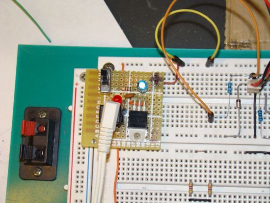

Important: You need a regulated +5V supply for accuracy of the output. The ADC uses Vdd as the reference for conversion, and all computations are done with Vdd = 5V. You can get a regulated +5V using a LM7805 linear regulator IC.
Photo_2
Getting a regulated +5V from a LM7805 IC

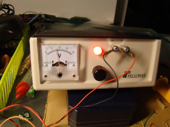

Photo_3
Variable power supply source for testing the DVM

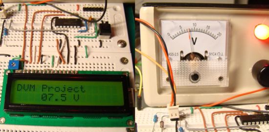

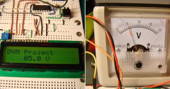

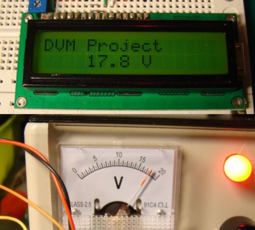

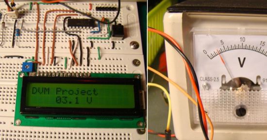

Output
The DVM is tested for various input voltages ranging from 0-20 V and found to be very accurate. Some snapshots of the testing are here.
