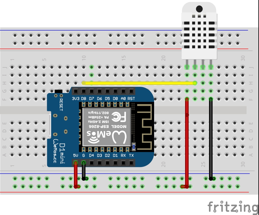

The schematic for this project is simple. All we need to do is connect the DHT22 temperature and humidity sensor to the Wemos board. Although the Wemos D1 mini was used for this schematic, you can use any of the other ESP8266 boards available. Connect the components as shown in the schematics below.
Schematic
Here is a breakdown of the connections between the pins to make the connections clearer.
DHT11 – Wemos
VDD – 5v
Data – D8
GND – GND
The connections seems simple enough, but go over it one more time to be sure the wires are properly connected.
