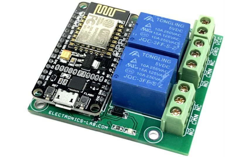

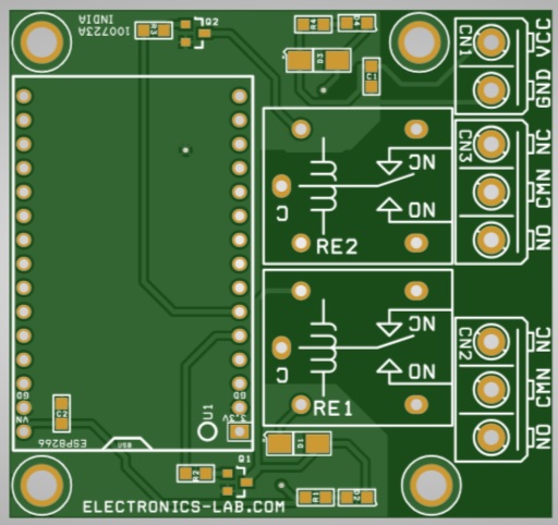

The project described here is an ESP8266 NodeMCU Two Channel Relay Module. This board enables users to control 2 x relays remotely.
The project described here is an ESP8266 NodeMCU Two Channel Relay Module. This board enables users to control 2 x relays remotely. The 2 channels can be controlled remotely using a webserver/WiFi connection. The project works with 5VDC. Two LEDs indicate relay operation. Screw terminals help user to connect devices and power the supply. Relay output has 3 contacts normally closed, normally open, and common. Relay can drive a load up to 10A/250VAC or 10A/30VDC. It can be used in applications such as IoT and smart Home/Home automation.
The board can be connected to a server through a TCP Client and also can be controlled by HTTP. With this module, users can upload firmware and can create a versatile IoT project. It is suitable for your smart home and IoT project with network control.

Hardware Details

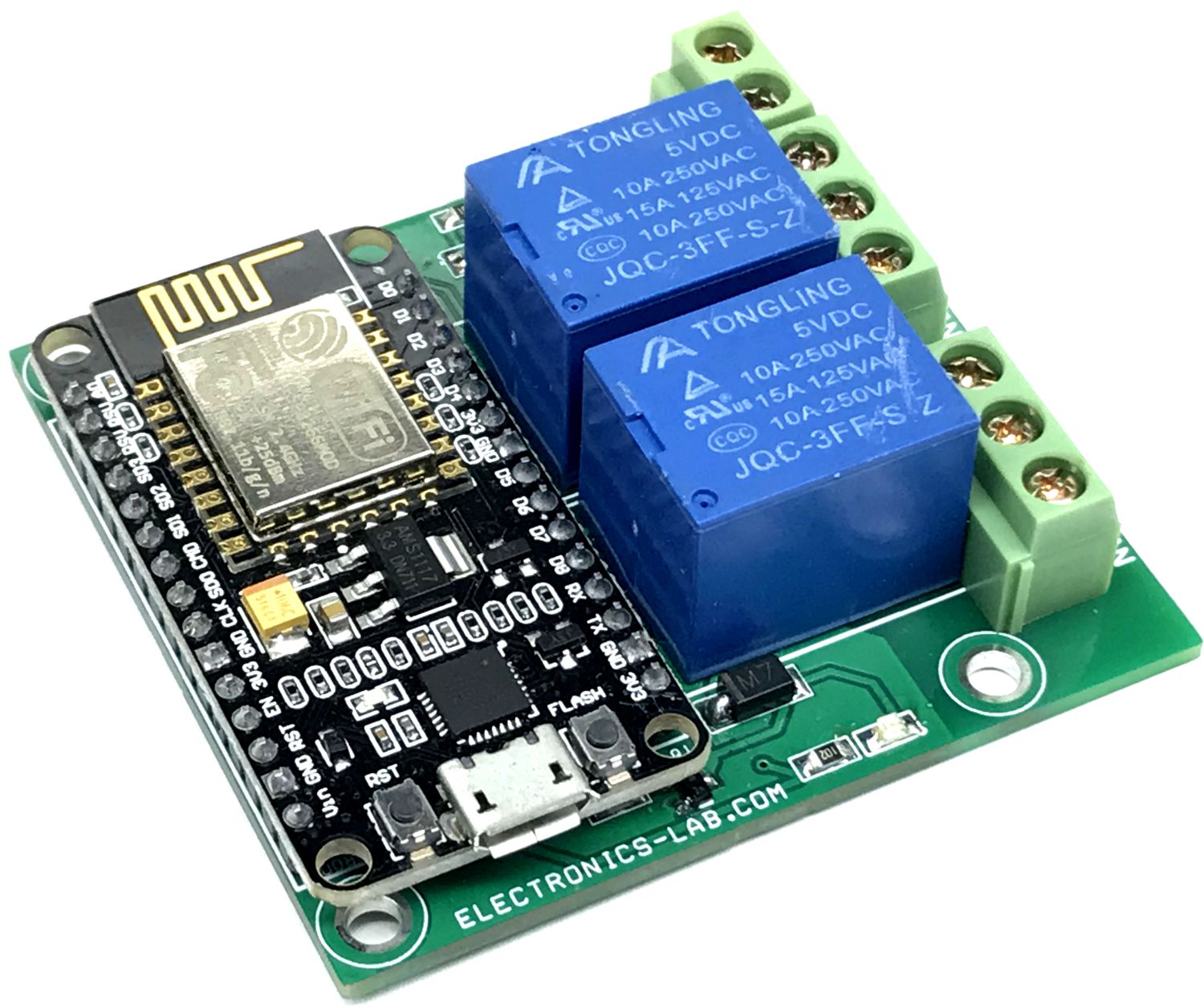

- ESP8266 MCUNODE (WiFi)
- 2 x 5V Relay
- 2 x LEDs Relay Operations
- 2 x 3 Pin Screw Terminals (Relay Output Normally Open, Normally Closed and Common Connections)
- 2 Pin Screw Terminal Power Input 5V DC

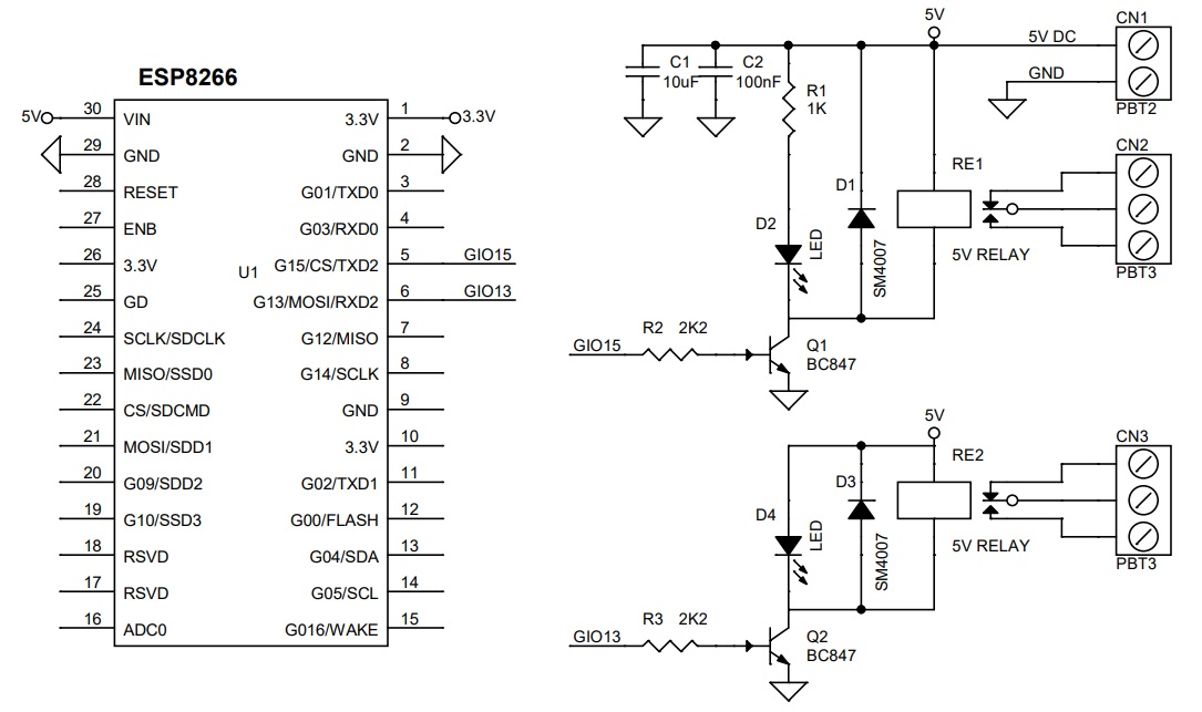

- 2 x BJT (Transistors) drive relays
- 2 x Flyback diodes
- ESP8266 GPIO15 Connected to Relay 1
- ESP8266 GPIO13 Connected to Relay 2
- Power Supply 5V DC
- Current 100mA (when Relays are on)
- 2 x Relay LED
- 4 x 3MM Mounting Holes
- Screw Terminal for Easy Connections

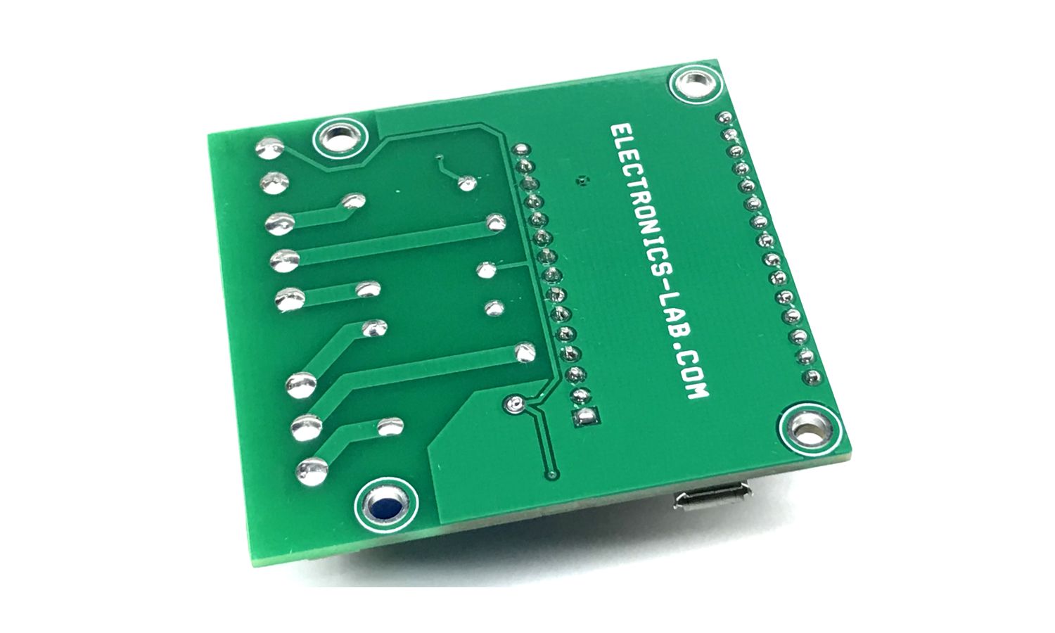

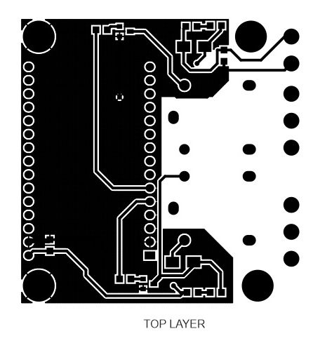

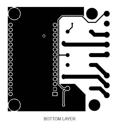

- PCB Dimensions 57.63 x 53.98 mm

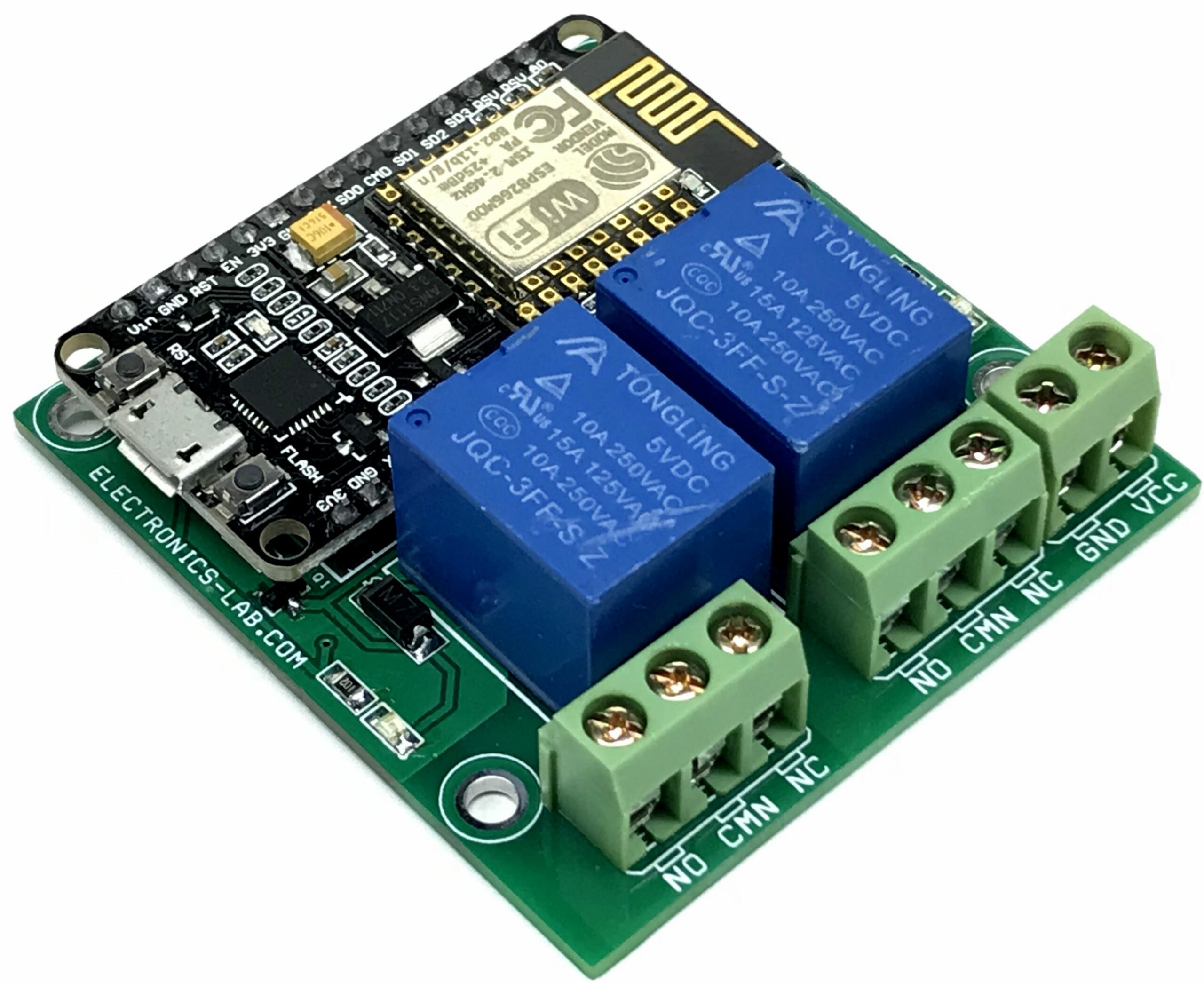

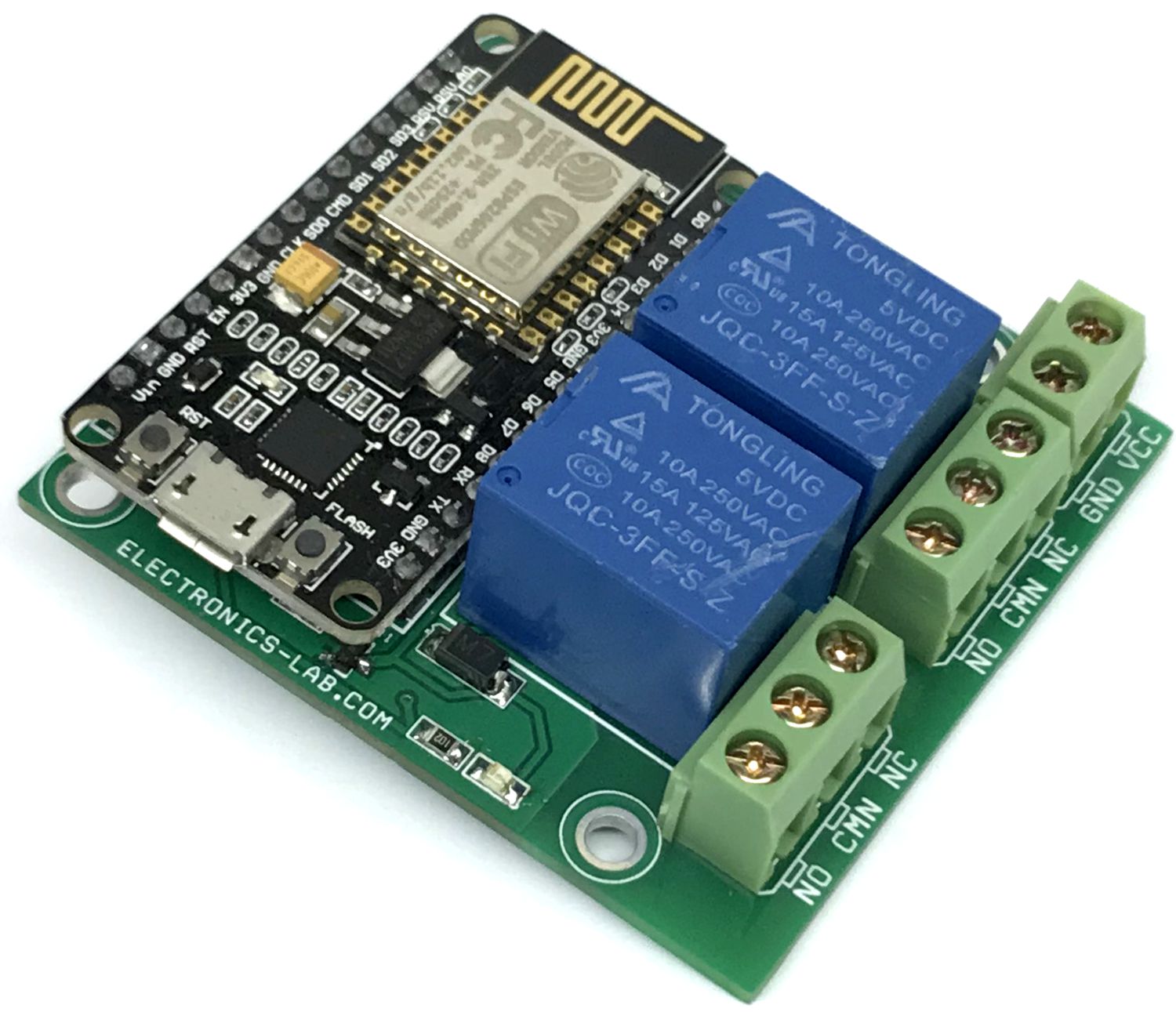

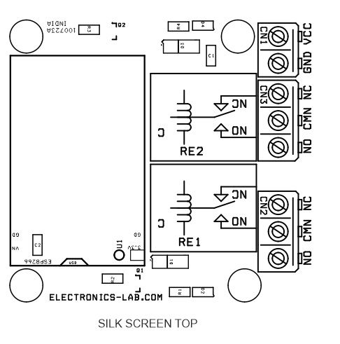

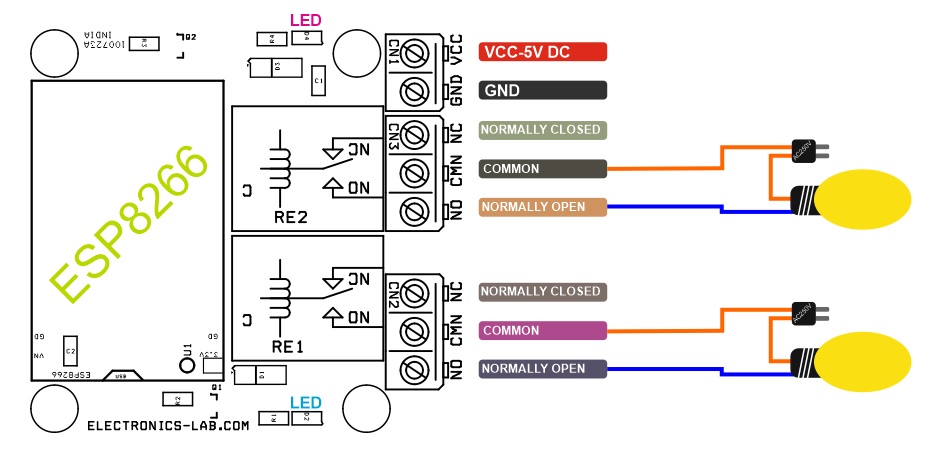

Connections and Other Details
- CN1 Power Supply: Pin 1 = 5V DC, Pin 2 = GND
- CN2: Pin 1 Normally Closed, Pin 2 = Common, Pin 3 = Normally Open (Relay 1 Contacts)
- CN3: Pin 1 Normally Closed, Pin 2 = Common, Pin 3 = Normally Open (Relay 2 Contacts)
- D2: LED for Relay 1
- D4: LED for Relay 2
Schematic

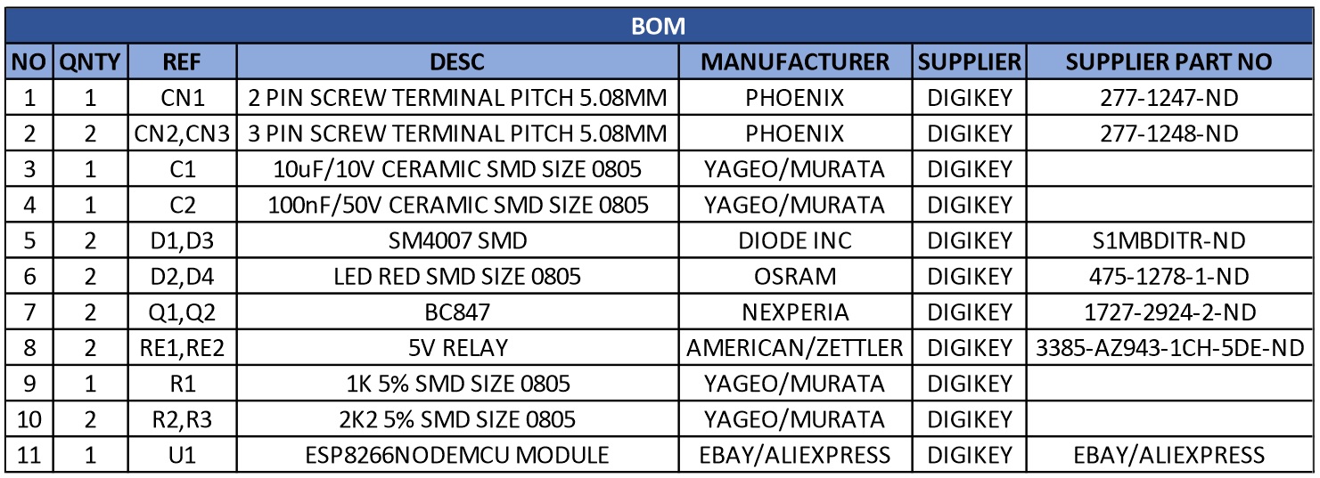

Parts List
| NO | QNTY | REF | DESC | MANUFACTURER | SUPPLIER | SUPPLIER PART NO |
| 1 | 1 | CN1 | 2 PIN SCREW TERMINAL PITCH 5.08MM | PHOENIX | DIGIKEY | 277-1247-ND |
| 2 | 2 | CN2,CN3 | 3 PIN SCREW TERMINAL PITCH 5.08MM | PHOENIX | DIGIKEY | 277-1248-ND |
| 3 | 1 | C1 | 10uF/10V CERAMIC SMD SIZE 0805 | YAGEO/MURATA | DIGIKEY | |
| 4 | 1 | C2 | 100nF/50V CERAMIC SMD SIZE 0805 | YAGEO/MURATA | DIGIKEY | |
| 5 | 2 | D1,D3 | SM4007 SMD | DIODE INC | DIGIKEY | S1MBDITR-ND |
| 6 | 2 | D2,D4 | LED RED SMD SIZE 0805 | OSRAM | DIGIKEY | 475-1278-1-ND |
| 7 | 2 | Q1,Q2 | BC847 | NEXPERIA | DIGIKEY | 1727-2924-2-ND |
| 8 | 2 | RE1,RE2 | 5V RELAY | AMERICAN/ZETTLER | DIGIKEY | 3385-AZ943-1CH-5DE-ND |
| 9 | 1 | R1 | 1K 5% SMD SIZE 0805 | YAGEO/MURATA | DIGIKEY | |
| 10 | 2 | R2,R3 | 2K2 5% SMD SIZE 0805 | YAGEO/MURATA | DIGIKEY | |
| 11 | 1 | U1 | ESP8266NODEMCU MODULE | EBAY/ALIEXPRESS | DIGIKEY | EBAY/ALIEXPRESS |
Connections
