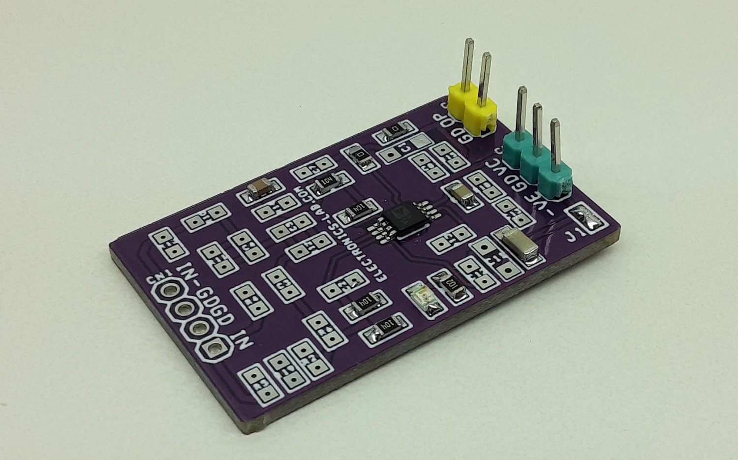

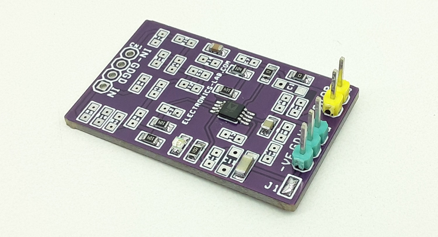

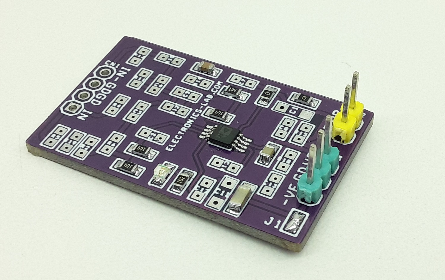

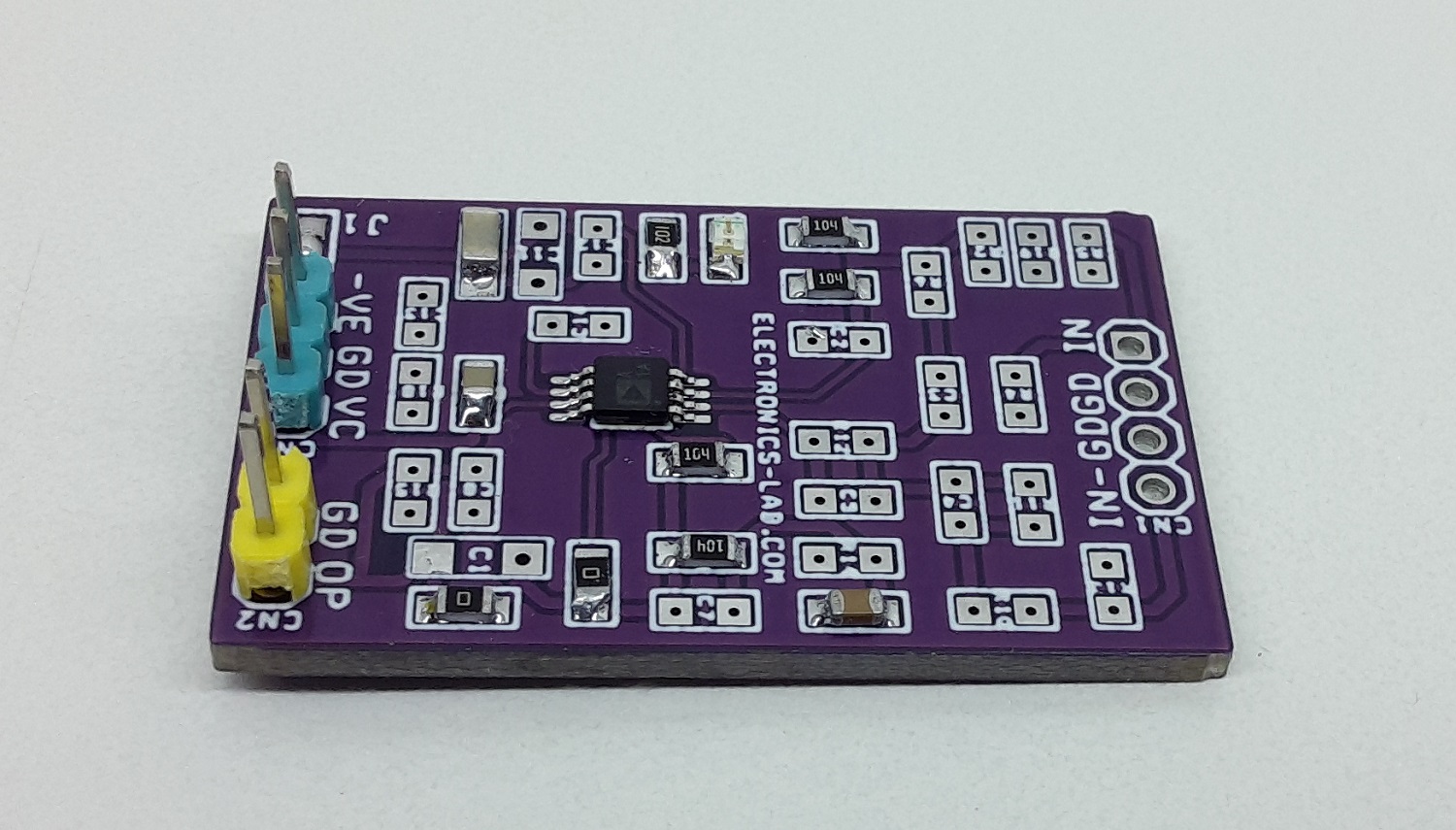

Universal OPAMP Board for SMD MSOP8 Package
This is easy to build and very useful project for hobbyists and students to learn and create OPAMP-based projects. The project accommodates a single OPAMP in the MSOP8 package.

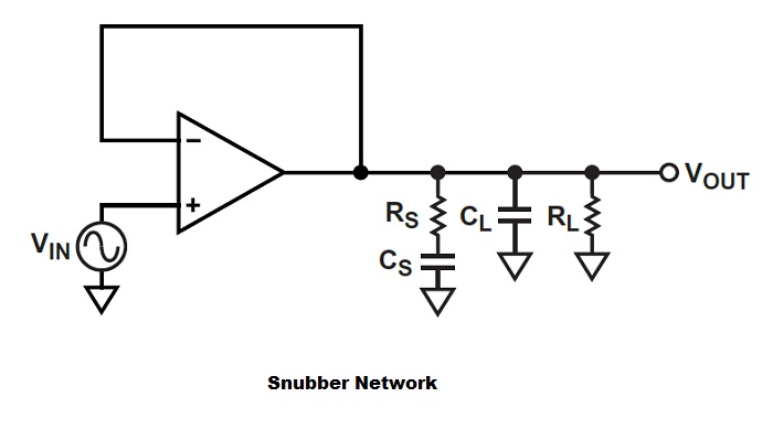

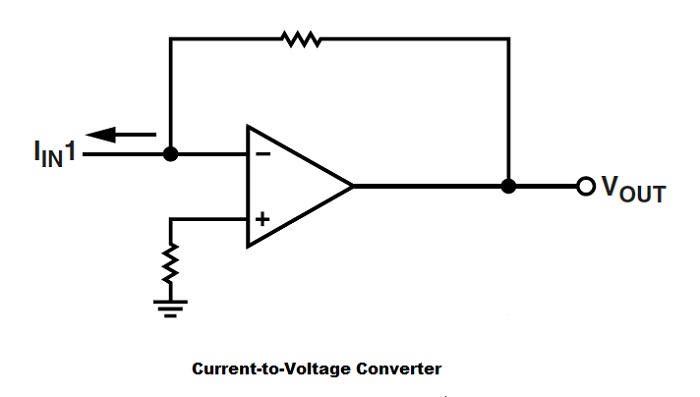

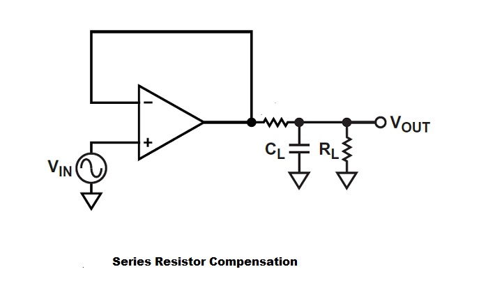

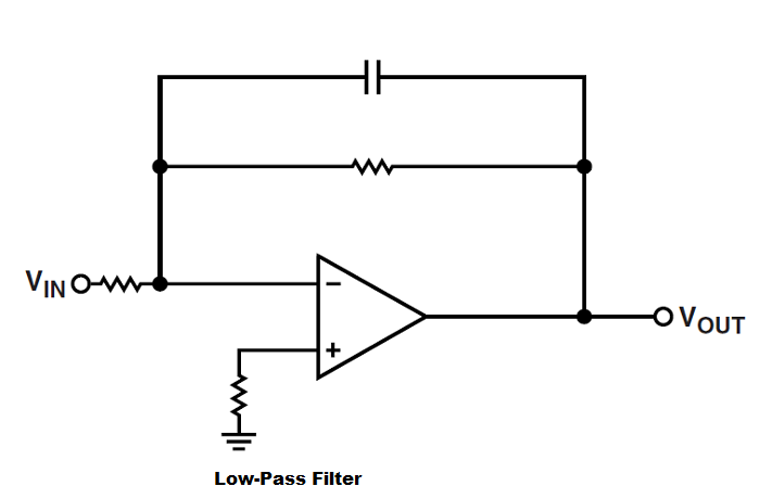

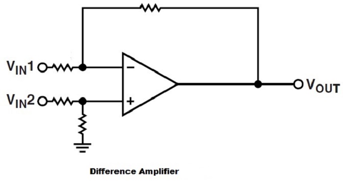

This is easy to build and very useful project for hobbyists and students to learn and create OPAMP-based projects. The project accommodates a single OPAMP in the MSOP8 package. The project provides the user with multiple choices and extensive flexibility for different applications circuits and configurations. It provides the user with many combinations for various circuit types including active filters, differential amplifiers, and external frequency compensation circuits. A few examples of application circuits are given below. OP777 op-amp is the right choice to use or any other MSOP8 op-amp with the same pin configuration as OP777 can be used. It supports dual supply or single supply, Jumper J1 is provided to use this board with a single supply, D1 is the power LED.
Credits: All example schematics are from Analog Devices application notes.

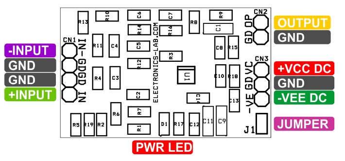

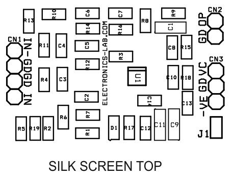

- Single or Dual Supply User-defined (Jumper)
- 4 Pin Male Header Connector for inputs
- 3 Pin Male Header for Supply input (Single or Dual)
- Jumper J1 Close for single Supply, Open for Dual Supply
- LED D1 Power LED
- Any MSOP8 Op-Amp Can be used (Pin configuration compatible OP777)

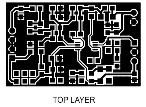

- PCB Dimensions 37.31 x 23.50 mm

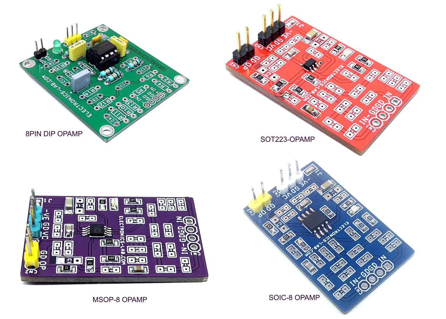

Similar Universal OPAMP boards
- Universal Op-Amp Board for SMD SOIC-8 Package
- Universal Op-Amp Board for DIP-8 Package

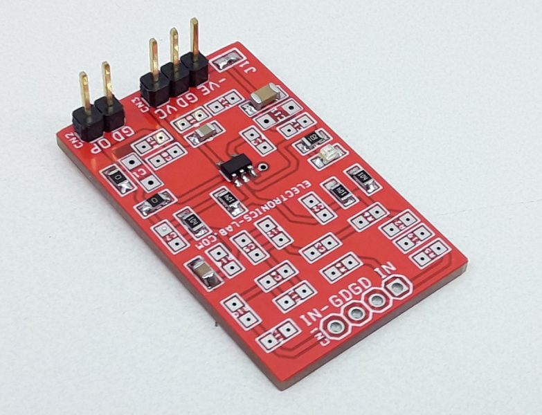

- Universal OPAMP Board for SMD SOT23-5 Package

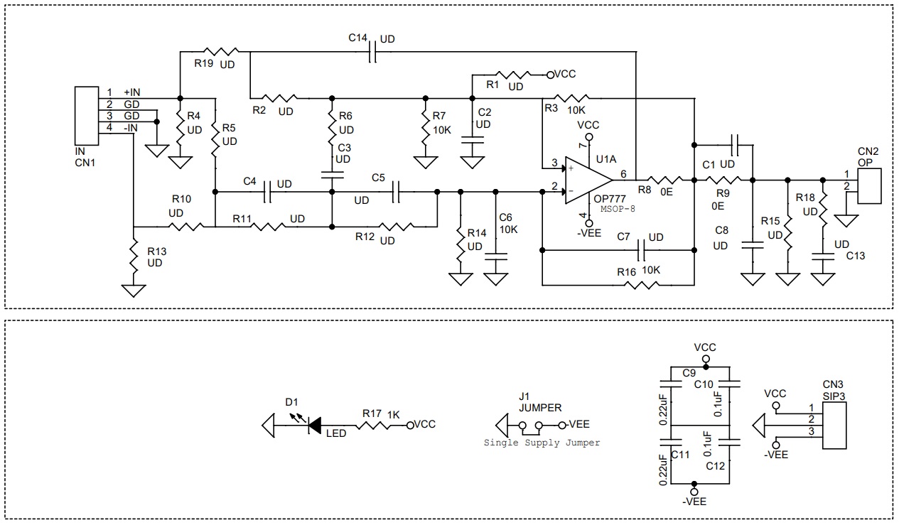

Schematic
Example Application

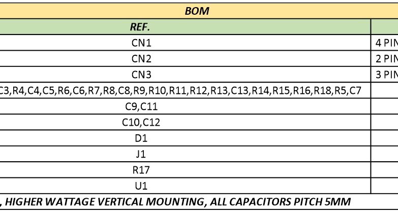

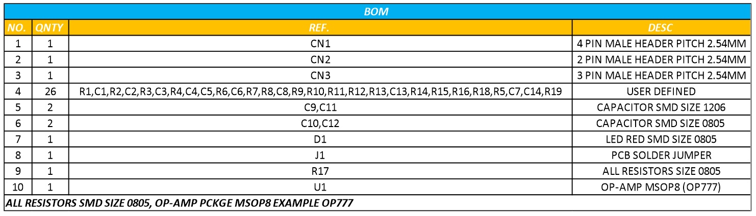

Parts List
| NO. | QNTY | REF. | DESC |
| 1 | 1 | CN1 | 4 PIN MALE HEADER PITCH 2.54MM |
| 2 | 1 | CN2 | 2 PIN MALE HEADER PITCH 2.54MM |
| 3 | 1 | CN3 | 3 PIN MALE HEADER PITCH 2.54MM |
| 4 | 26 | R1,C1,R2,C2,R3,C3, | USER DEFINED |
| ,R4,C4,C5,R6,C6,R7, | USER DEFINED | ||
| R8,C8,R9,R10,R11,R12, | USER DEFINED | ||
| R13,C13,R14,R15,R16, | USER DEFINED | ||
| R18,R5,C7,C14,R19, | USER DEFINED | ||
| 5 | 2 | C9,C11 | CAPACITOR SMD SIZE 1206 |
| 6 | 2 | C10,C12 | CAPACITOR SMD SIZE 0805 |
| 7 | 1 | D1 | LED RED SMD SIZE 0805 |
| 8 | 1 | J1 | PCB SOLDER JUMPER |
| 9 | 1 | R17 | ALL RESISTORS SIZE 0805 |
| 10 | 1 | U1 | OP-AMP MSOP8 (OP777) |
| RESISTORS SMD SIZE 0805 | PCKGE MSOP8 | EXAMPLE OP777 |

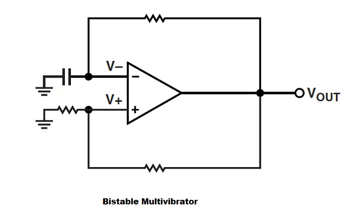

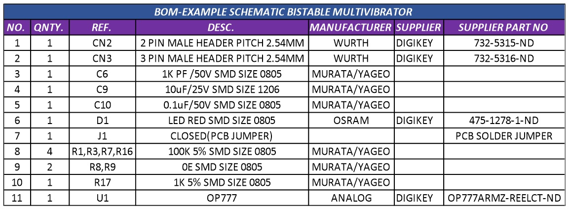

Example Application Parts List
| BISTABLE MULTIVIBRATOR | ||||||
| NO. | QNTY. | REF. | DESC. | MANUFACTURER | SUPPLIER | PART NO |
| 1 | 1 | CN2 | 2 PIN MALE HEADER PITCH 2.54MM | WURTH | DIGIKEY | 732-5315-ND |
| 2 | 1 | CN3 | 3 PIN MALE HEADER PITCH 2.54MM | WURTH | DIGIKEY | 732-5316-ND |
| 3 | 1 | C6 | 1K PF /50V SMD SIZE 0805 | MURATA/YAGEO | ||
| 4 | 1 | C9 | 10uF/25V SMD SIZE 1206 | MURATA/YAGEO | ||
| 5 | 1 | C10 | 0.1uF/50V SMD SIZE 0805 | MURATA/YAGEO | ||
| 6 | 1 | D1 | LED RED SMD SIZE 0805 | OSRAM | DIGIKEY | 475-1278-1-ND |
| 7 | 1 | J1 | CLOSED(PCB JUMPER) | PCB SOLDER JUMPER | ||
| 8 | 4 | R1,R3,R7,R16 | 100K 5% SMD SIZE 0805 | MURATA/YAGEO | ||
| 9 | 2 | R8,R9 | 0E SMD SIZE 0805 | MURATA/YAGEO | ||
| 10 | 1 | R17 | 1K 5% SMD SIZE 0805 | MURATA/YAGEO | ||
| 11 | 1 | U1 | OP777 | ANALOG | DIGIKEY | OP777ARMZ-REELCT-ND |
Connections
Example OPAMP Circuits
