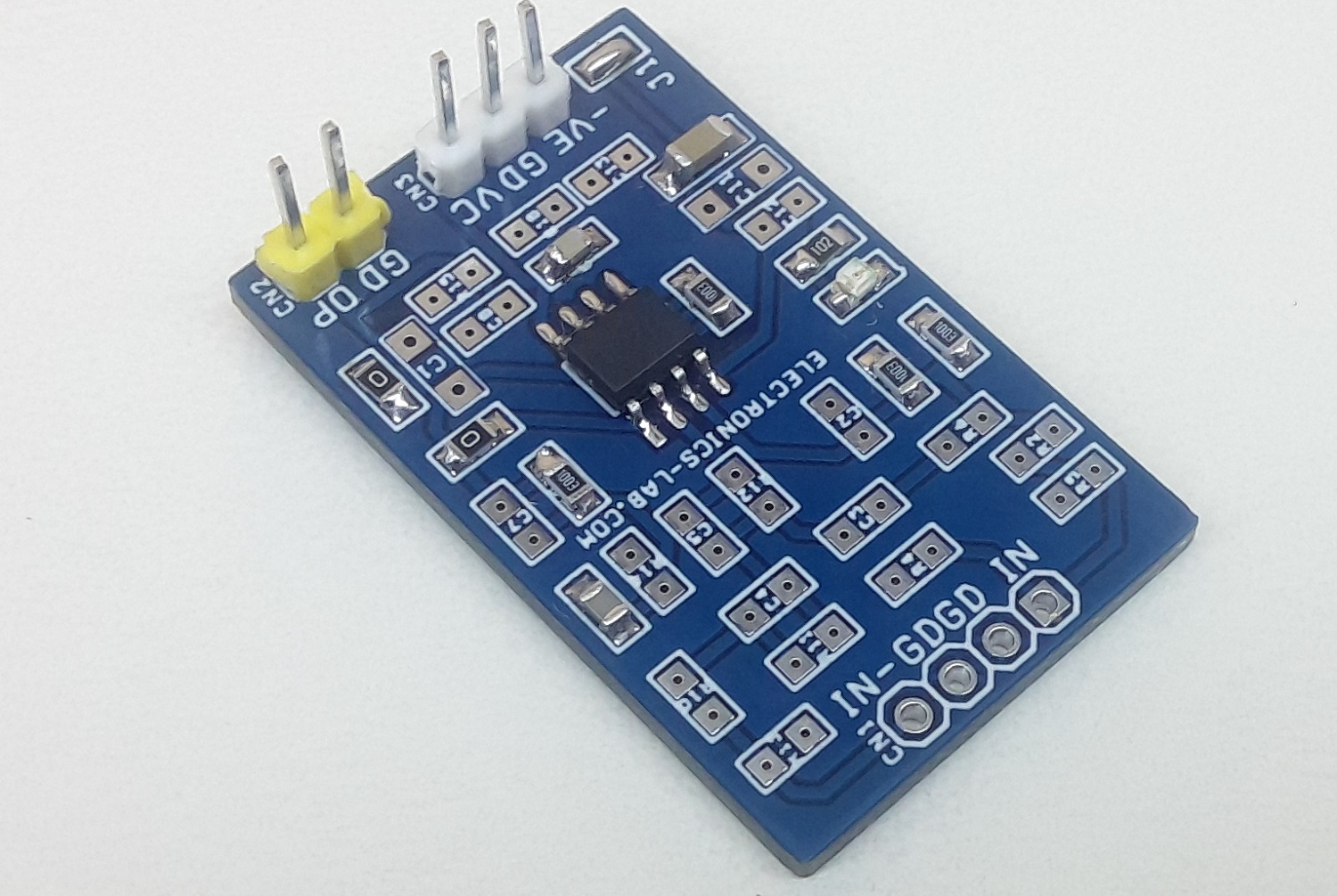

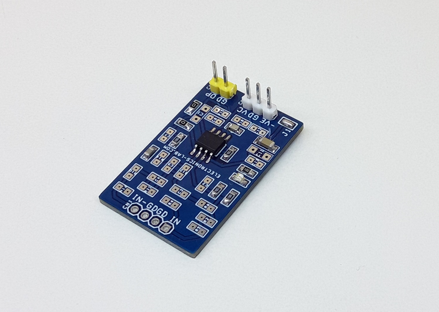

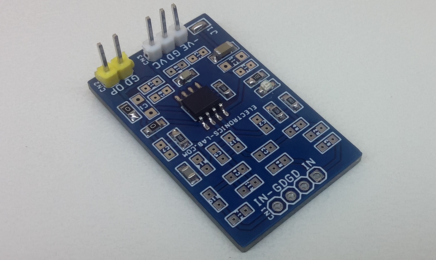

Universal Op-Amp Board for SMD SOIC-8 Package

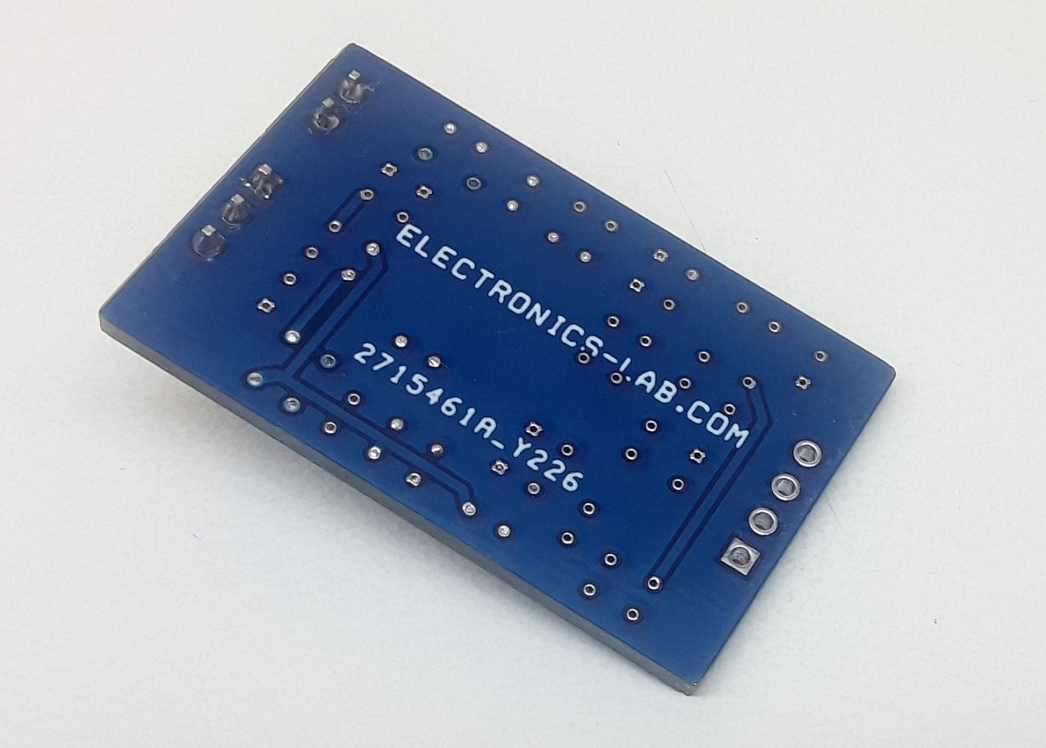

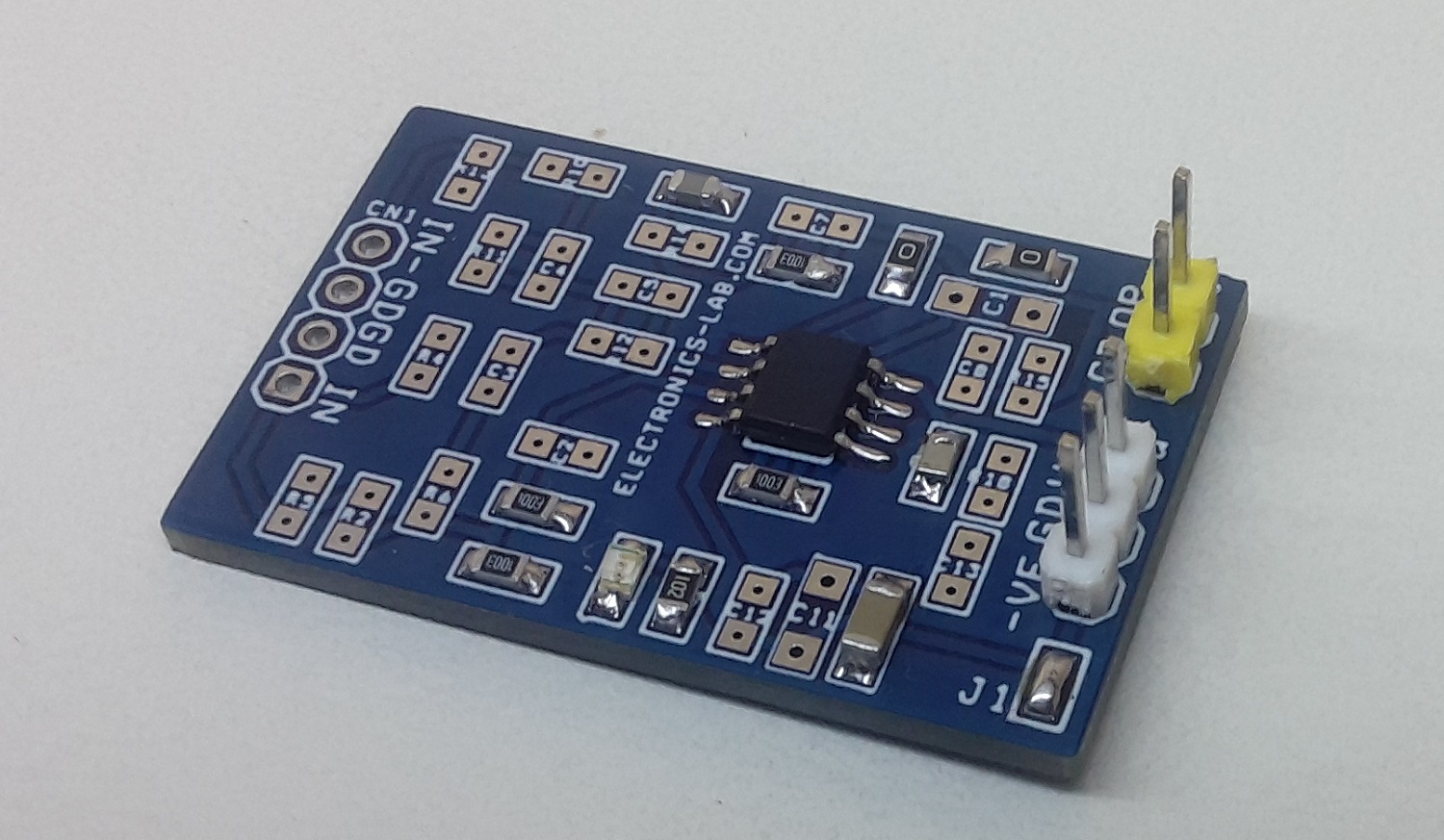

This is easy to build and very useful project for hobbyists and students to learn and create OPAMP-based projects. The project accommodates a single op-amp in a SOIC-8 package.

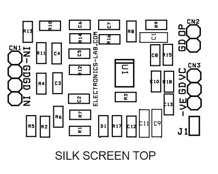

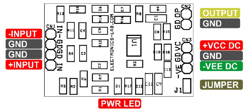

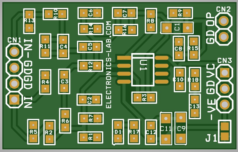

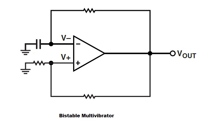

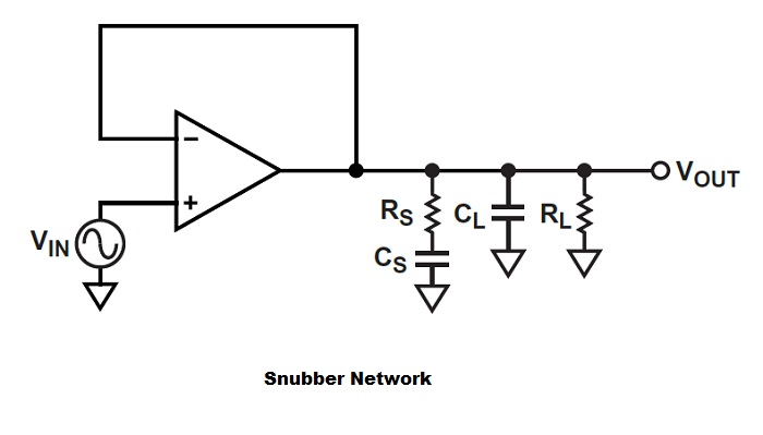

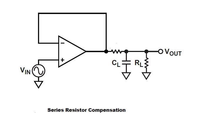

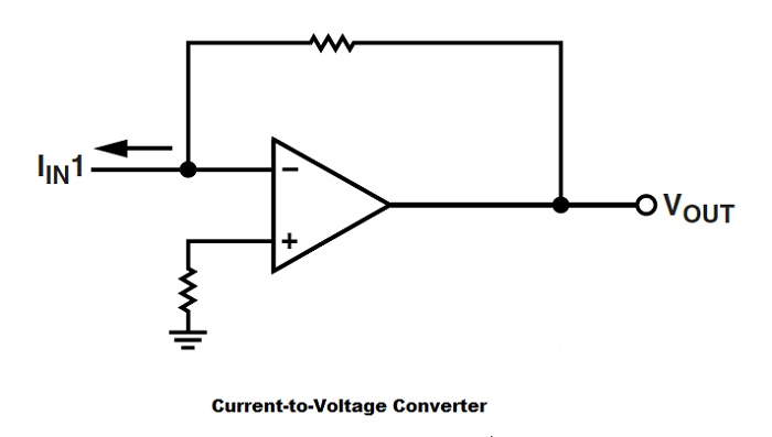

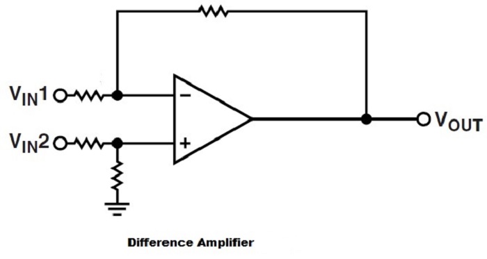

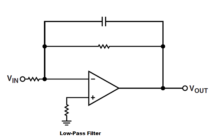

This is easy to build and very useful project for hobbyists and students to learn and create OPAMP-based projects. The project accommodates a single op-amp in a SOIC-8 package. The project provides the user with multiple choices and extensive flexibility for different applications circuits and configurations. It provides the user with many combinations for various circuit types including active filters, differential amplifiers, external frequency compensation circuits etc. A few examples of application circuits are given below. LM358 op-amp is the right choice to use but any SOIC8 OPAMP with the same pin configuration can be used. It supports dual supply or single supply, Jumper J1 is provided to use this board with a single supply, D1 is the power LED.
Credits: All example schematics are from Analog Devices application notes.
- Single or Dual Supply is User-defined (Jumper)
- 4 Pin Male Header Connector for inputs
- 3 Pin Male Header for Supply input (Single or Dual)
- Jumper J1 Close for single Supply, Open for Dual Supply
- LED D1 Power LED
- Any SOIC-8 Op-Amp Can be used Pin configuration – LM358

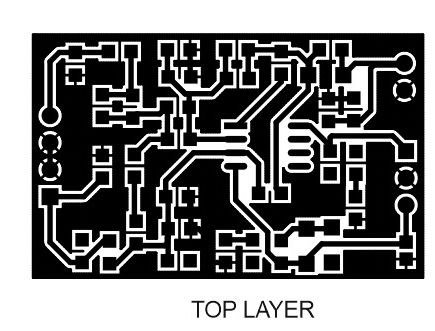

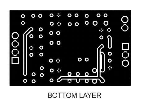

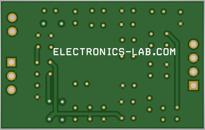

- PCB Dimensions 37.31 x 23.50 mm

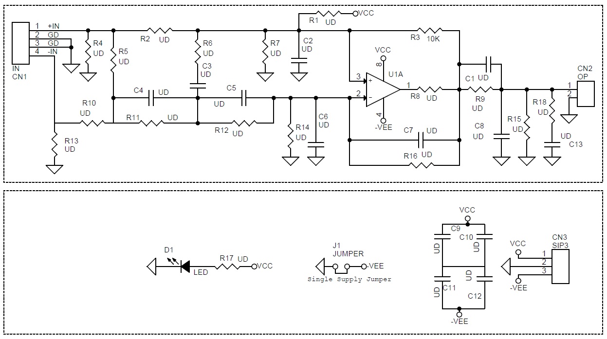

Main Schematic

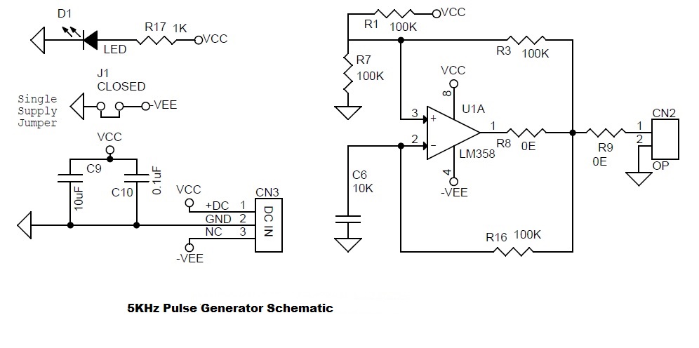

5Khz Pulse Generator Schematic

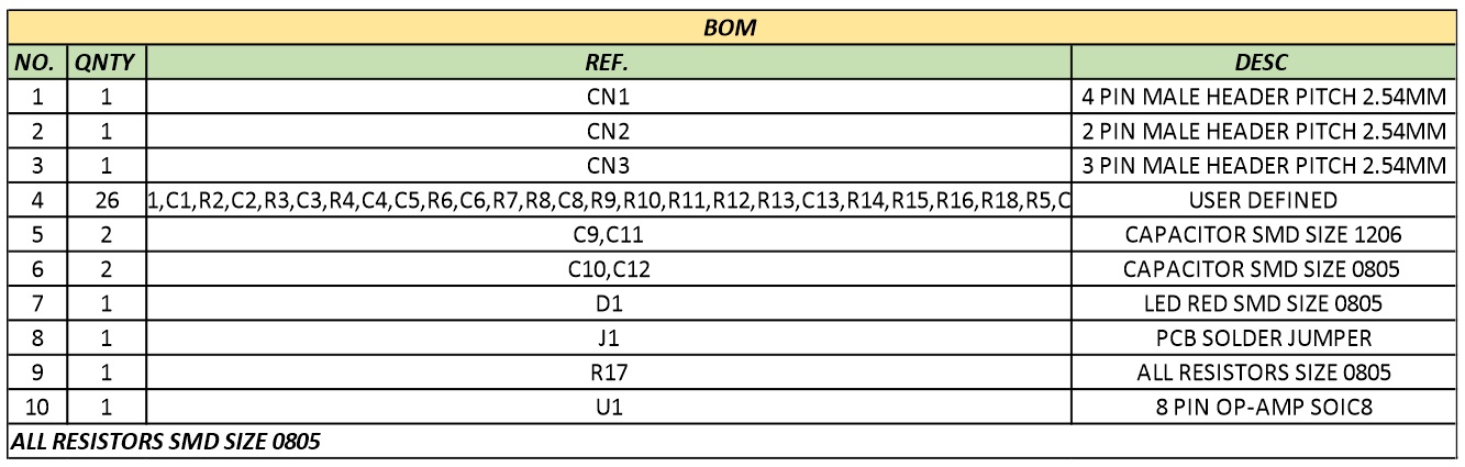

Main Parts List
| NO. | QNTY | REF. | DESC |
| 1 | 1 | CN1 | 4 PIN MALE HEADER PITCH 2.54MM |
| 2 | 1 | CN2 | 2 PIN MALE HEADER PITCH 2.54MM |
| 3 | 1 | CN3 | 3 PIN MALE HEADER PITCH 2.54MM |
| 4 | 5 | R1,C1,R2,C2,R3 | USER DEFINED |
| 6 | C3,R4,C4,C5,R6,C6 | USER DEFINED | |
| 6 | R7,R8,C8,R9,R10,R11 | USER DEFINED | |
| 5 | R12,R13,C13,R14,R15 | USER DEFINED | |
| 4 | R16,R18,R5,C7 | USER DEFINED | |
| 5 | 2 | C9,C11 | CAPACITOR SMD SIZE 1206 |
| 6 | 2 | C10,C12 | CAPACITOR SMD SIZE 0805 |
| 7 | 1 | D1 | LED RED SMD SIZE 0805 |
| 8 | 1 | J1 | PCB SOLDER JUMPER |
| 9 | 1 | R17 | ALL RESISTORS SIZE 0805 |
| 10 | 1 | U1 | 8 PIN OP-AMP SOIC8 |
| ALL RESISTORS SMD SIZE 0805 |

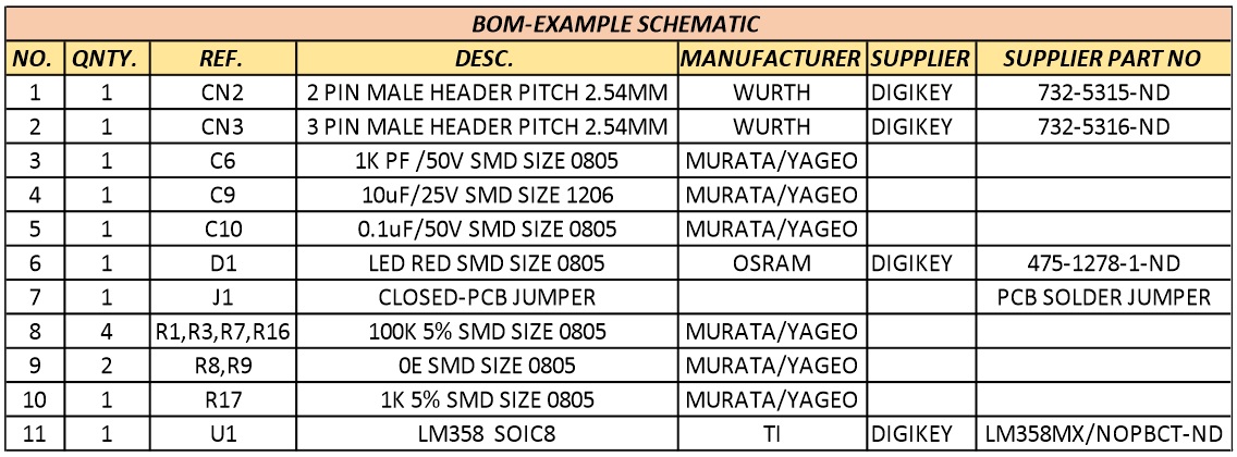

5Khz Pulse Generator Parts List
| NO. | QNTY. | REF. | DESC. | MANUFACTURER | SUPPLIER | SUPPLIER PART NO |
| 1 | 1 | CN2 | 2 PIN MALE HEADER PITCH 2.54MM | WURTH | DIGIKEY | 732-5315-ND |
| 2 | 1 | CN3 | 3 PIN MALE HEADER PITCH 2.54MM | WURTH | DIGIKEY | 732-5316-ND |
| 3 | 1 | C6 | 1K PF /50V SMD SIZE 0805 | MURATA/YAGEO | ||
| 4 | 1 | C9 | 10uF/25V SMD SIZE 1206 | MURATA/YAGEO | ||
| 5 | 1 | C10 | 0.1uF/50V SMD SIZE 0805 | MURATA/YAGEO | ||
| 6 | 1 | D1 | LED RED SMD SIZE 0805 | OSRAM | DIGIKEY | 475-1278-1-ND |
| 7 | 1 | J1 | CLOSED-PCB JUMPER | PCB SOLDER JUMPER | ||
| 8 | 4 | R1,R3,R7,R16 | 100K 5% SMD SIZE 0805 | MURATA/YAGEO | ||
| 9 | 2 | R8,R9 | 0E SMD SIZE 0805 | MURATA/YAGEO | ||
| 10 | 1 | R17 | 1K 5% SMD SIZE 0805 | MURATA/YAGEO | ||
| 11 | 1 | U1 | LM358 SOIC8 | TI | DIGIKEY | LM358MX/NOPBCT-ND |
