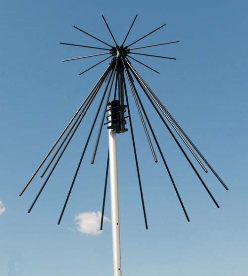

something max 2ft tall so I can attach it to my guttering.
A discone antenna is the fav wideband antenna for use with scanners
there's DIY kits on the net, also ebay sales if you want to go that way

I just read this and I see your point, I might do both, get a £40 discone for my scanner and attempt to build a array of parabolic dishes, and pair it with a cheap sdr.
