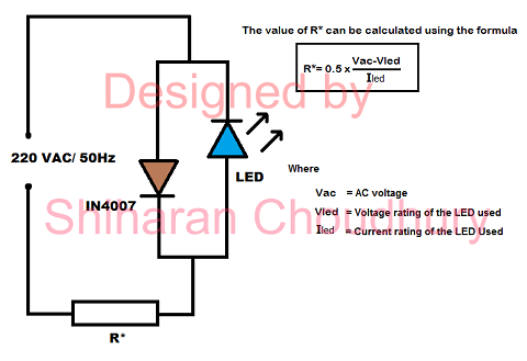

please tell me if any problem in designs
I prefer 1st one. I am going to use this for machine. reliability is very important
so please help me
which one should I choose
also cost is an factor
thanks

To use a resistor to limit the current will need about 50 times the power to be dissipated in the resistor over that dissipated in the led. This may not be a cost problem but the heat will need to be removed.
I have an aversion to electrolytics for reliability.
I would therefore go with circuit ! but remove R2 (it does nothing here) and use C1 to limit the current. There are special capacitors to run on the mains, one of these should be used.
D1 could be another led to get twice the light from the same current.
R1 is to protect from switch-on surge and should be capable of withstanding a highish voltage. Diddy 200V resistors are not suitable even if they have sufficient power capability.

thanks for your reply
so I will use 1st design
I have 1 more question
circuit 1 gives AC voltage (so led on and off at 50HZ)
circuit 2 gives DC
so is DC or AC gives maximum life for led?
and reliability?

You should also take into account that 230VAC will have a peak value of 325V if you want to make a long life circuit. The DC circuit(2) is made to supply a chain of 30 LEDs, so you need to recalculate the capacitor if you want to drive only one LED.
You should check the calculations anyway, to see if the values are correct. Normally a lower current will give a longer life.

Many led displays are multiplexed so I would think that the intermittent current should not be a problem. I have a clock at least 20 years old still working well.
You could consider keeping R2 and replacing D1 with a zener to limit the turn on current, this could be as high as 150mA if the supply is turned on at maximum voltage.

The diagram which you show is not what I recommended. The zener should be connected across R2/led1 pair. A value of 6V to 10V or so will limit the peak current on switch on.
I do not see how to protect the whole circuit from over voltage, just make sure R1 and C1 are capable of withstanding any overvoltage.
To get extra reliability you could duplicate the circuit.
Neons should be reliable but they go dim with use due to internal coating of the glass.

During normal running, the current will be controlled by C1 and R1, a voltage drop across R2 will do nothing much.
A zener across the led will either take all the current or none at all depending on the relative voltages of the zener and led. By defining the voltage across R2 and led in series, the maximum current in the led will be defined.. The zener will not conduct in its zener direction under normal running, it will only act as a diode would.
The idea of a zener is to limit the current at turn on when C1 can be considered a short circuit for the first part of the cycle.
220v has peak voltage of 311V
The current will be limited to 141mA by R1, this is high but may be OK for half a cycle.
C! will have a reactance of 14k4Ω at 50Hz.
The reactance of C! and R1 will be 14k6Ω so the running current will be 15mA but only half of this will go through the led.
If you use a 10V zener across R2 and led in series, then the current through the led will not exceed 32mA which the led should easily stand for part of a cycle.
A 0.5W zener should be all right.
R1 will dissipate about 0.5W.
You should check these calculations.
