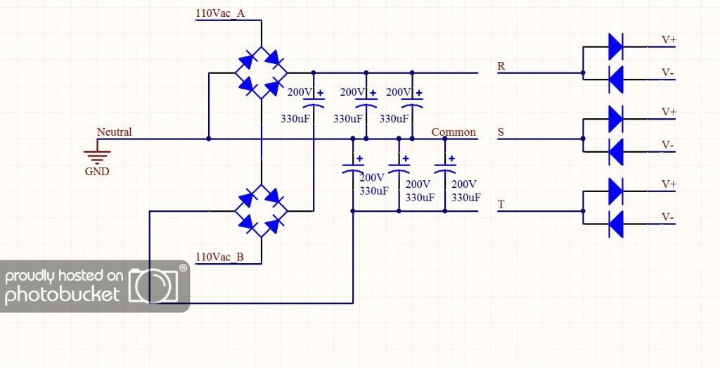

I am finishing up a CNC router build and have opted to use a "stock" 3-phase spindle rather than a DIY spindle. I have received the spindle and the VFD and am wading through the instruction manual and various forum posts about set-up, problems, etc, etc. This is the VFD: http://www.ebay.com/itm/251681093909?_trksid=p2059210.m2749.l2649&ssPageName=STRK:MEBIDX:IT
The manual states (in Chin-English) that for single phase operation two leads from a 240V breaker can be connected to any two of the R/S/T 3 phase inputs....and that neutral/ground should be connected to some hieroglyph that I assume to be "neutral" or "Supply Ground". Visual inspection inside the VFD reveals what appears to be a standard 3-Phase rectifier, and while I have NOT verified the traces, I ASS-U-ME the hieroglyph/neutral/ground is tied to the negative side of the rectifier (I do NOT have this represented in the schematic because I have NOT verified the connection) ....at the risk of over-complicating things, I thought it might meliorate the ripple on the VFD's filter capacitors to "pre-rectify" the two 120V legs of the 240V supply and add some filtering capacitors as demonstrated in the following schematic:
Everything to the right of the R/S/T labels is located inside the VFD, there are also filter capacitors inside the VFD, but I have not disassembled the VFD enough to read the values....Everything to the left of the R/S/T labels is the "proposed supply circuit" to help provide a more stable source for the VFD.
I would love some thoughts on the addition of the proposed circuit....ESPECIALLY any reasons for NOT employing it.
The Drive/VFD are rated @ 2.2kW which implies a current of slightly less than 10A under full load....I am concerned that the capacitors in the VFD simply are not large enough to "fill the valley" during the "low voltage" portion of the 60hz supply....I don't know that 6 * 330uF capacitors in series/parallel (Total effective capacitance ~495uF) are up to the job either, but I figured that was a good starting place....assuming an actual peak voltage of 339V (240V * 2^0.5) to keep the supply voltage above the 220V output voltage for 8mS @ a constant 10A drain would require a capacitor bank of at least 2000uF....and I KNOW the VFD rectifier capacitors are not that large, heck, the entire VFD isn't that large, lol.
I know for a fact that there are thousands of these VFDs working from single phase supplies with these exact spindles and NO pre-rectifier or filter Capacitors....but it seems like "an ounce of prevention" might ease some of the stresses on the VFD and the spindle....but I am more than a little out of my comfort zone here and I would love some thoughts//suggestions.

Fish,
I'm not sure I understand what your pre-rectifier+capacitor circuit is supposed to do.
I'd assume that the input circuit of the vfd has a built-in rectifier and smoothing filter. Otherwise it couldn't be operated off an AC mains. The issue here is that the inverter probably is designed to operate off a 240V mains, not 2*110V. Could you post a scan or photo of the "hieroglyph", please? It may mean ground, but we'd need to see it.

Hey Harald, Thanks for the quick response! YES the VFD has a built in rectifier/filter.....designed for 3 phase input, but the manual states it will **work** with a single phase input.....but I am concerned that the filter capacitors in the built-in rectifier circuit are NOT large enough....So, by providing 339Vdc (+169.5Vdc/-169.5Vdc) that is "pre filtered" my intent is to prevent such extreme ripple on the built-in rectifier filter capacitors....The only reason I am rectifying the two 120Vac legs separately is to allow the use of 200V capacitors I have on hand....Electrically I could have just as easily rectified the two 120Vac legs and referenced them as 240Vac and specified 3 * 165uF 400V capacitors....
(In the US, our residential mains voltage is supplied by a center-tapped transformer with two 110Vac to 120Vac legs and a "neutral" center, if you connect across both legs and do not reference "neutral", you have a single 220V to 240V supply....)
...I will see if I can find a digital copy of the Chinese character used to reference the "Supply nuetral/ground", but unless you read Chinese, I cannot see how that is going to help.
Photo?
Why are you concerned? Do you have negative experience? For starters, I'd use the VFD without any additional circuitry. See how it performs and whether there is any uncommon behavior (noise, het, smoke...). If it does what it is suposed to do, there's no need for additional circuitry, which, being connected to mains, will require special consideration and safety measures.

Thanks Harald.....my "CNC Buddy" gave me exactly the same advice, LOL! But we have had company @ the house since my Spindle & VFD arrived, I had to work all weekend...blah, blah, blah, and so I have not been able to actually do anything except "create problems" and attempt to solve them.....Perhaps I will call off work today and just focus on setting the VFD up like the manual suggests w/o attempting to implement solutions to problems I haven't had yet......**Note to Self: "Take a deep breath......AND your ADD meds...."** LOL!

There are several forums on the Web that cater to Chinese VFD three-phase inverters and Chinese air-cooled and water-cooled three-phase spindles. Here is one that you might find interesting. I find it even more interesting that the price on E-bay for what appear to be identical VFD drives ranges from US$123.00 to US$1116.50! These must all be brute-force DC rectifier/filters, operating directly off the line voltage, driving a three-phase inverter of some ilk. They probably do not produce very good sine-wave outputs, but maybe the spindle motor doesn't care.
One poster on one of the forums I visited had nothing good to say about Huanyang VFD, calling them a POS VFD. But they do seem to be popular with others. Others have had problems with the spindle overheating and smoking because of incorrect setup parameters, related to setting a minimum frequency that will allow the cooling fan (on air-cooled spindles) to work, while others have problems with an error code popping up after weeks of apparently successful operation. It appears to me that there are plenty of problems just getting the Huanyang VFD programmed to operate without adding an external rectifier/filter to the mix.
Maybe after you get yours working you can consider adding a pre-rectifier/filter to improve performance. Make sure your electrolytic capacitors have a working-voltage specification well above the peak line voltage if you go that route. I would be conservative and use 400 WVDC or more; 200 WVDC is within the peak voltage of 110 VAC, but dangerously close to the minumum necessary if the line voltage surges to 130 VAC. And isn't there a connection "dot" missing on your schematic to connect the lower bridge rectifier cathodes to "common"?

Yes, I have read many, many of the horror-stories on various forums....but MOST of those are in the 2008-2010 era...I haven't found many recent posts about "smoking failures....doesn't mean there haven't been any....perhaps Huanyang fixed the issues before they went to the 2-year warranty....OR....maybe the two year warranty is only for units that still have all of the magic smoke in them...lol.....In any case mine currently works and I have NOT added any "pre rectifier" circuit to it.
As to the "dot" in question....as stated above, the capacitors, as drawn in the schematic, are connected to the "Center" of a "Center Tapped" AC supply...so with reference to ground (the center) there are essentially two 120Vac Rectifiers and the 200V capacitors from the "top half" are essentially connected in "series" with the 200v Capacitors in the "bottom half"....From one perspective each rail of the supply is filtered with respect to AC ground which is also referenced as 0Vdc....the top rail would then be +170Vdc and the bottom rail would be -170Vdc....If connected to two of the VFD Line inputs these rails would feed directly to a three phase rectifier, one rail would conduct through one diode in the 3-phase rectifier and the other rail would connect through an opposing diode in the three phase rectifier and the 0Vdc//AC Ground would still be connected to the "Earth/Ground" terminal of the VFD....
EDIT: Just looked at the schematic again.....the "missing DOT" is a quirk in the schematic capture software.....it won't let me add or delete "DOTs"...it makes the decision and stands steadfastly by it!
....Anyway all of this is really kind of moot at this juncture....it seems the VFD does, in fact, have enough capacitance in the input rectifier to source the output with a reasonable facsimile of a three-phase sine-wave output....I would think the motor's inductance would help to smooth the waveform toward a sine wave, but I have NOT verified the theory on a scope....I will say that there is certainly a "ringing" noise in the motor that I suspect can be traced back to some harmonic of the PWM frequency.....nothing earplugs won't mute ;-)

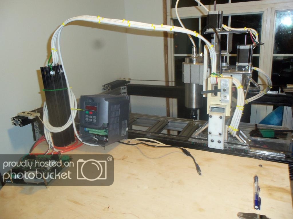

Here is a quick picture of where I am in my new build:
Still have a long way to go, lol, but not nearly as far as I had back in the Spring....I am trying a lot of different things all at once in this new build....some of the ideas have worked really nicely...others have had numerous "revisions"....some still need revising, lol....There are currently still several critical parts "mocked up" in HDPE that will eventually be replaced with machined aluminum....but for now I am focused on moving to the "initial testing phase"....each axis has been carefully tested as a standalone device, but w/o the spindle there just wasn't much else to test....Hopefully some time today I will get an MDF table "mocked up" and attempt some "first cuts"...
DIY CNC Routers are primarily designed for wood and plastics...some machines can make occasional light cuts in aluminum but beyond that, cutting metals requires fundamentally different machines....While the pictured build likely weighs in @ >>300lbs, a machine designed to mill metals with a similar work envelope would likely weigh ~ 2 orders of magnitude more....cutting metal is all about rigidity....and the larger the work envelope the more mass you have to add to achieve rigidity....Even a classic design like the Bridgeport has relatively limited travel in the Y-Axis and Z-Axis to achieve the requisite rigidity and those girls are heavy! (~2500lbs)...to increase the Y-Axis travel on a Bridgeport class machine to 30" of travel would require a completely different design approach that would make that build REALLY HEAVY!
On the list of things that make a CNC router different from a metal cutting machine are travel speed and spindle speed....on the machine pictured above I am currently able to "jog" the X-Axis and Y-Axis @ ~600ipm with anticipated cutting speeds of ~200ipm....the spindle is designed to be effective from 6krpm to 24krpm....obviously these feeds and speeds are not suited for metal cutting...even if the machine had the requisite rigidity....
