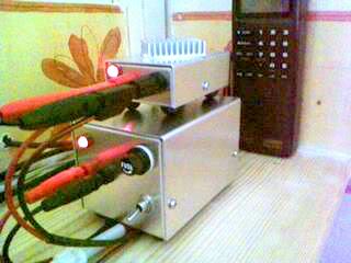

Life of a capacitor
Hi all.
just a small picture of the box the 35 volt 2200uf capacitor i had concerns of it life lives in, the small unit on top, 13.5 volts 2 amps i doubt it could reach that before thermal shut down, but it might, it only drives i radio, RX 350ma TX 1.2 amps. Dave. :)
The lower box is the transformer, 30 VA 15-0-15 air cooled 40mm axial fan run at 5.2 volts. cooling due to max transformers current draw, the transformer has 130 degrees C thermal fuse non reset, so the enclosure is tight very little room hence air cooling.
