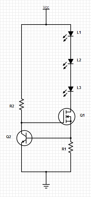

I think you should start at the beginning with respect to the current limit calculations.
Your calculations for base current are way off.
Your calculation of the the resistor value to provide this current is wrong. Or at least the value you get is out by a factor of maybe 1000.
Your method of current limiting seems to be based on minimum component count, which is not the best point to start from. Why not individually current limit each string?
You have not done any power dissipation calculations. How hot will those resistors and transistors get?

I would use something like this on each string, with the added protection of a 15V zener diode connected between the mosfet's gate and source.
current1-png.12782
R1 is a value which will drop 0.6V at the rated current, and R2 can be between 10k and 100k. Q2 is any general purpose NPN transistor.
Keeping each string independent means that if something bad happens to your current limiting only one string will bite the dust.

Thanks Steve,
If I can ask a few questions to understand this better.
What Mosfet would you use?
Is the Mosfet a more robust choice, I could look up a Data Sheet to learn more.
Assuming the Zenner after R2 just protects the Mosfet gate from to much voltage?
Q2 Pulls the Gate low, but it is not all clear to me.

I would select a MOSFET based on the current, max voltage, and max power dissipation. It is not particularly critical.
Yes the zener is required to protect the gate when the supply voltage exceeds about 20V.
The transistor is turned on by the current sense resistor which lowers the gate voltage. This ensures the gate voltage is set to the value which keeps the transistor just turned on. This point is where the voltage dropes across the current sense resistor is about 0.7V.
This circuit is not intended as a variable current source. If you just want to trim the current to get all strings the same then you either select resistors or as additional large value resistors in parallel to increase the current for strings with lower current.
The most efficient way to make the circuit dim the LEDs is to use PWM. This is a new requirement...
Take a look at the LED resource to see a variant of the circuit I have you which can be used for PWM control.
The circuit is capable of handling long strings but ensure the MOSFET is rated for something in excess of the full supply voltage since failure of the MOSFET will take out your LEDs.

The LED resource is here. Section 3 is the part you're after. The circuits you've found are a reasonable source of the PWM to drive the constant current circuit. You probably don't want to drive the circuit I've given you at more than a few kHz and the choice of gate resistor is important to ensure the mosfet turns on and off promptly but without overloading the transistor used to reduce the gate voltage. A value of 1k is probably OK for driving the circuit at a couple of kHz.

So a 555 oscillator connected to the final figure 3.5 in Section 3 - Driving a single high power LED.
I meant to mention that the LED's are rated at 2A which I am told is very conservative in Cree Specs.
This was another advantage in two long strings at 1050mA, if one string faults open the LED's are going to have no problems at 2.1A before being switched off and problem fixed.
So no problems with run away current, additionally only one half of each board need be in each string.
Not that it would mater, but the remaining LED's would also have double the Heatsink area.
yeah, figure 3.5, but driving your string of LEDs.
That's not a good way to go. One string may draw more current than the other if they are in parallel.

If you pulse an LED at a high speed with a very high current but have the average current low enough that the LED does not overheat then it is not super bright, instead it looks like its average current because our vision is slow and does not see the peak brightness of the pulse. That is how PWM dimming works.

It's even worse than that. LED efficiency decreases with increasing current, so all other things being equal, for the same average forward current a LED will have a slightly lower average brightness as the duty cycle decreases.
I would like to continue this discussion to ascertain where and to what degree it applies.
I do not have a strong conclusion either way and see a few possible caveats. Can we qualify this further?
Starting with Multiple batches of LED's with different trends, we have no control. So putting this aside!
I believe that it would be very difficult or require an extraordinary event to damage LED's in this design from thermal runaway, given the LED specification and the maximum available current.
Might be wrong, but lets start from this position and just look at the specific design for mismatch!
How would you describe the process that would lead to mismatched currents and how great could it get.
There seems to be some different answers for the actual application, perhaps within certain LED types?
if you take 100 LED's with Voltage Characteristics within a range around 3v, each lead contributes 1% of the total.
Unless you receive LED's from multiple batches the trend might be positive, negative or neutral but the net variation between 2 strings of 50 should be low just from the numbers involved.
In two strings each LED contributes 2% to an Average Total of around 150v, so the difference in voltage is divide by a larger sum. If you look at the same logic over a few LED's at low voltage the change can be a very high percentage of the total in comparison.
I am not looking to skimp on circuitry, but am wondering if the subject needs more nuance.
PWM is a must do, if there are no problems it is to simple not to include.
You mention the Mosfet will take out LED's if it goes and should be well rated.
What is the process that would take the LED's out, is it likely and could it be fail safed with a standard fuse?
Have seen and used many 555 circuits, so familiar with modified oscillators and PWM.
Keen to apply the 555 PWM circuit to the 2 string single power supply described.
Removing LED's as required to match the end design is no problem at all.
My goal would be to work with little head room for the Maximum Power Utilization.
I will certainly understand and do what I can, but might need some assistance with the final component values.
Often in Timer/Drive circuits I would have problems with power sharing and just insert diodes and capacitors until it worked. If the circuit got to complex with need of separate power supply, it could warrant another path.
Do we need some consideration for the 555 and power sharing?
