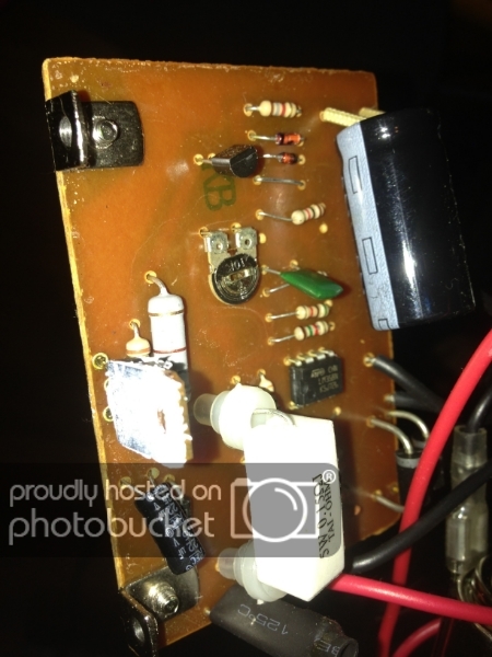

hi,
just looking at the spec's of the PSU, it may not have enough grunt to power the HID's, It would be struggling to power 1 let alone 2 of them.
if the PSU is now faulty. We would need to see internal Sharp and Well Lit pics of it.... component side and track side to see if any obvious failures can be identified

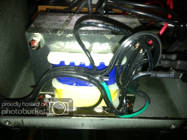

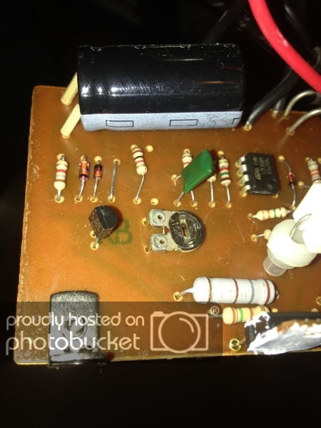

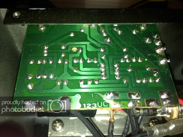

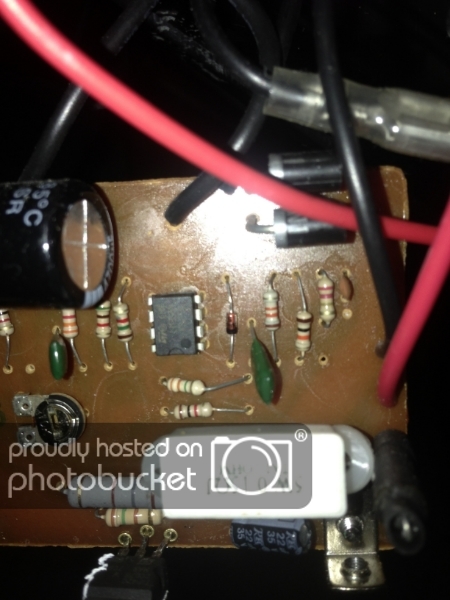

Here are some pics of the internals. From what I can see, there doesn't seem to be any burns or anything. Only sloppy workmaship :)
