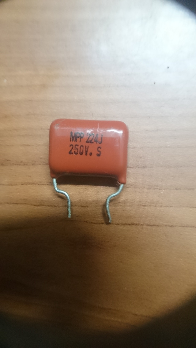

i would like to know what is the advantage and disadvantage of such circuit if it will be used to power on 12v fan

1. It outputs 9V not ±9V so the 12V fan will run slow.
2. The output is not isolated so will give a shock if touched.
3. Very reliable high voltage components will be necessary. The input capacitor should be 1000V of the type which fails open circuit, not short circuit.
4. It is small, light and cheap.
That's can be controlled by the zener diode
Sure I'll isolate it
Can you give me link for such one
The one that used ia ceramic capacitor 400V that run on 220 ac source

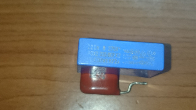

i wonder how to calculate the voltage after the ceramic capacitor

You would want a Class Y safety capacitor. Example: https://www.digikey.com/product-detail/en/kemet/PHE850ED6100MD18R06L2/399-5422-ND/1927367 .
The output voltage is going to be almost totally dependent on the load, including the load supplied by the Zener diode. With the input capacitive reactance, and the 10K resistor, you have more of a current source than a voltage source.
With the components shown the circuit can probably source around 10 mA.

1) Do not, never, use this type of "power supply". This is a cheap technique intended to be used in fully isolated housings at best. As soon as there is the slightest risk of exposure of one of the output leads to human touch there is also a risk of a potentially deadly shock. You obviously lack the experience to judge this circuit. Therefore it is mandatory that you use a save power supply.
2) Once you have gained some more experience and still want to use this design (in an isolated, closed housing, of course), consider the impedance of the high voltage capacitor (as per X = 1/(2 × f × C) as a current limiting resistor. This will allow you to make the necessary calculations.
Why do I think you lack the experience? You're getting your units all wrong:
  • 1 mΩ is a short circuit. The original design you copied surely calls for 1 MΩ - case matters: m = milli, M = mega.
  • The unit of capacitance is F, so it is not 220 µf but 220 µF.
  • The output is + 9 V vs. 0 V or 0 V vs. -9 V, but not +. 9 V (as others have mentioned before)
You may think this is nitpicking, but it is not. Electronic design is an engineering trade and requires precise descriptions.

Reactance of 0.1 uF capacitor at 60 Hz
Xc = 1/(2piFC) = 1/(2pi*60*0.1e-6) = 26526 ohms
That 10K resistor is also in series, so total source impedance:
Zs = √(10,000² + 26526²) = 28348 ohms.
With a 220 vac source, short circuit current will be:
I = E/Z = 220/28348 = 7.76 mA
Any load voltage will reduce that maximum current capability. With a 12 volt load:
I = E/Z = 208/28348 = 7.33 mA
