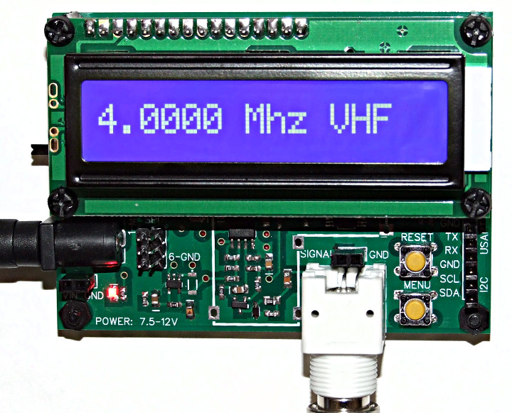

I have been working on an Arduino based frequency counter for a while. It is working well but I probably have to improve the design. In fact I designed it for myself as a hobby, then I thought about industrializing it. Here is the project log

The picture is just an illustration of a measurement @4Mhz. The upper frequency is above 70 Mhz and I hope to reach 100 Mhz.
Yes, the circuit is relatively complex as compared to simpler frequency counters. The reason is obvious: simple frequency counters don't offer a proper isolation of the circuit. Often they don't even have high input impedance, for example when the signal is fed to a single transistor. The other reason for a simpler architecture is that they don't offer what Arduino offers: the possibility to program the board, to connect I2C peripherals, to use SPI etc... if they have any connector at all.
