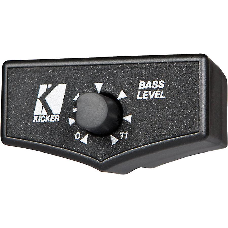

Hey all i am trying to find a way in order to turn an car amp's bass level knob left and right using an arduino's Digital PWM pin. I am thinking that a stepper motor would be the correct motor to use in order to do this or no?
Also, would there be a better fitting motor to do what i am looking to do without much needed modifications to the bass level knob in order to attach it to the motor to turn it?
The bass knob looks like this:
Any insight would be great!

It is possible to get motorised pots. It's possibly an expensive choice.

Perhaps you could replace the pot with a digital pot.

Or, if you really want to get creative: wire the existing pot up as a voltage divider and feed an A/D pin on the Arduino, then replace that pot in the original circuit with a digital pot controlled by the Arduino. Then you can control the level directly using the knob or through whatever means the Arduino is providing you to adjust your bass volume.
