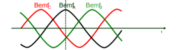

This is the back emf waveform from motor data sheet
I can understand the back emf as A, B and C. But what does C+ A-, A+ B-, B+ C- mean?

When a motor rotates, each winding generates a voltage known as Back emf. Back emf equation is
this voltage back emf opposes the main voltage applied on the windings.

Hold on I'm working on it I'm going to give you a visual representation of what it's doing. As you know a magnetic field is created when current is applied in a coil think of the magnetic field as a bubble. There's no current in the coil the bubble collapses. "But what does C+ A-, A+ B-, B+ C- mean?" It is showing you the relationship of the three phases with respect to one another when face c is positive and phase a is negative that 120° separation between phase is the point where the controller applies current which is zero crossing of the waveform my freaking phone he's not cooperating.

Also look closely at the hall waveform. S1 S2 S3 the colors used in particular.
compare those two BEMF waveforms the colors b+ c-on the bottom corresponds to the waveform S1 for the hall waveform is on top.
They are inversely proportional to each other. My arrows are incorrect it's just showing you the zero crossing or at what point the current is applied by the controller is applied. is applied. Horrible explanation good tonight kiddo :eek:

Ok, is it correct to think that C+ A-, A+ B-, B+ C- are the line - line voltages? and the below waveform from other document
are the phase voltages A, B, C (with respect to Neutral point)?
