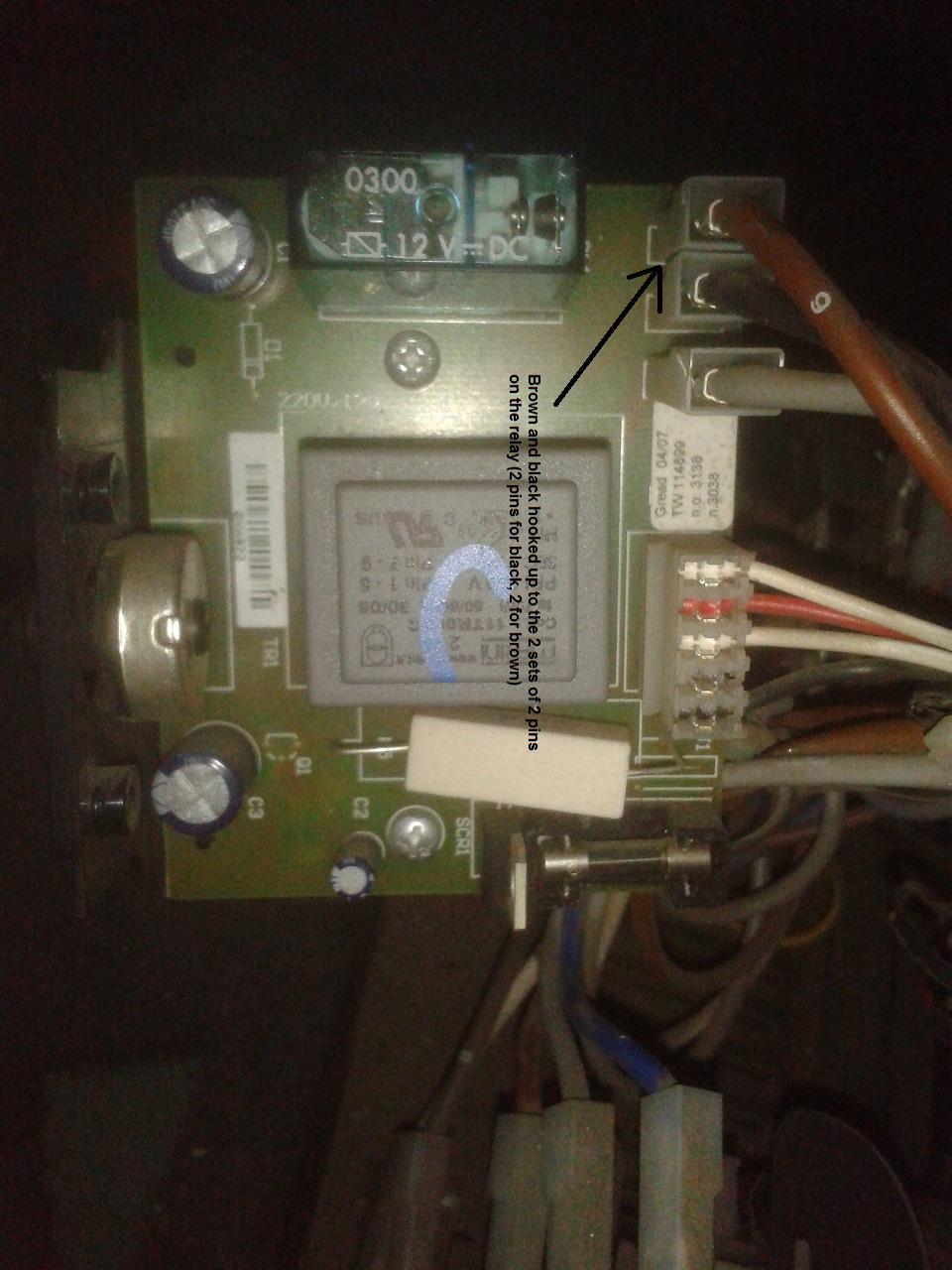

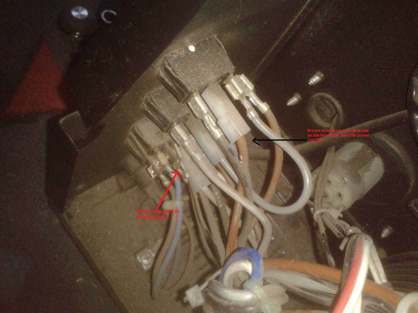

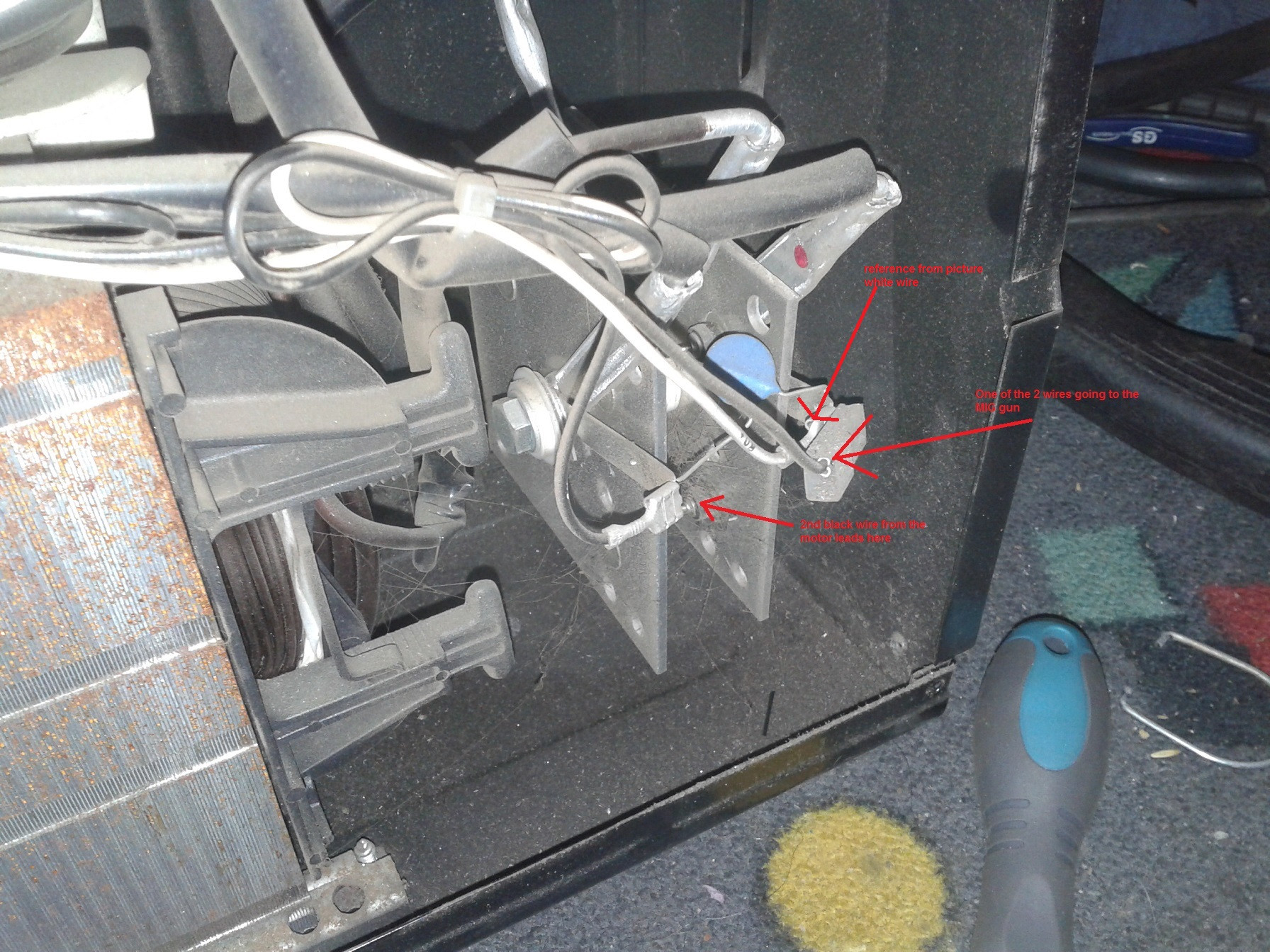

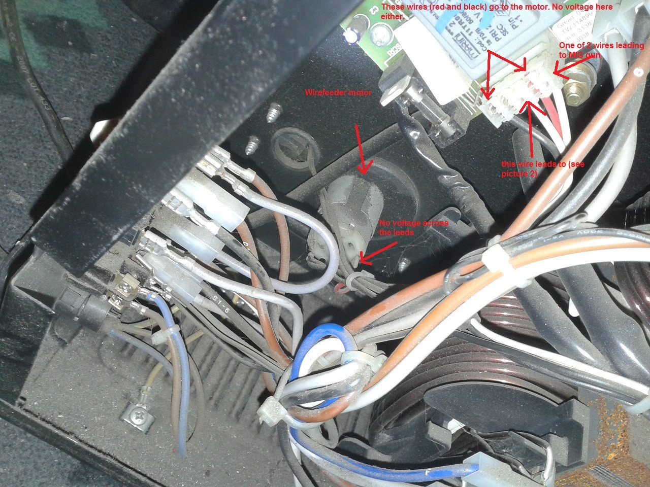

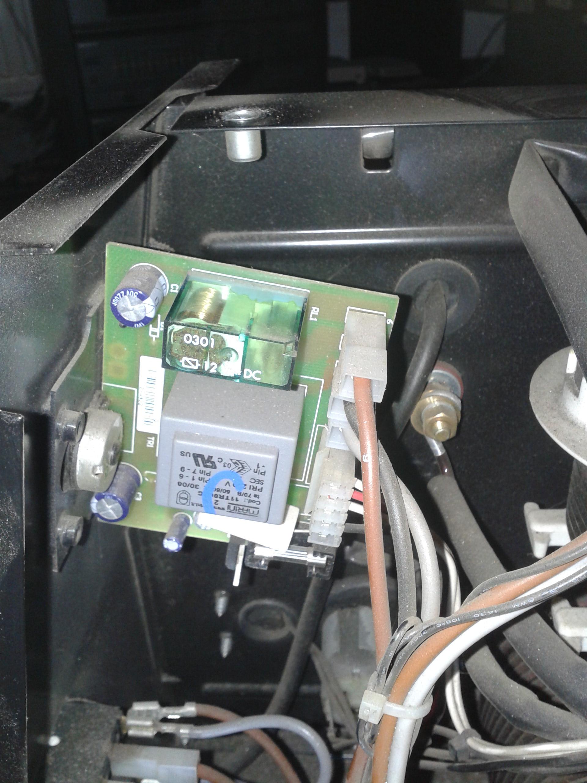

Not a great week. Yesterday I blew up two anglegrinders in a row and today I fried my welder. The wirefeeder is dead. The torch is fine, it reads 20.8 volts but when I measure the motor that controlls the wire feeder there's no voltage at all. I made a couple of pictures with some clarification here and there. Is there anyone that knows a thing or 2 about electrics or welders? It's a Bimax 123
This is the front of the welder
Rear of the welder
Better look of the pcb at the front of the welder

First thing I would suspect is the trigger. Is there a way that you can jumper the trigger connections inside the welder, to see if the motor runs?

The trigger is fine. I opend up the MIG gun to see if anything obvious was broken there. The trigger is nothing more than a piece of plastic that pushes 2 strips of metal together. There's 20 volts across the 2 strips of metal and they connect just fine.

Good, at least we can rule out the trigger. Can you check the voltage across the trigger, and see that it drops to zero when the trigger is pushed? That will rule out the cabling.
Additionally, there is a relay that is energized when you push the trigger; might look at that and see if the contacts appear burnt. Does the relay pull in when the trigger is pushed?

The voltage across the leads indeed drops to zero when the switch is pressed. The relay (translucent housing, 0301 written on it?) solder points look fine, no corossion or cracks, but when I press the switch, nothing noticable happens. No sounds, clicks or any mechanical movements inside.

I checked the relay (finder 40.61 0301). When the welder is turned on, 2 pins read 230V, just normal ac. The other side of the realy reads zero until is press the MIG gun switch, then it reads about 27V, slowly decreasing back to zero at a rate of about 0.1V every 0.5 seconds

It would appear the relay is bad. I would try replacing that first.

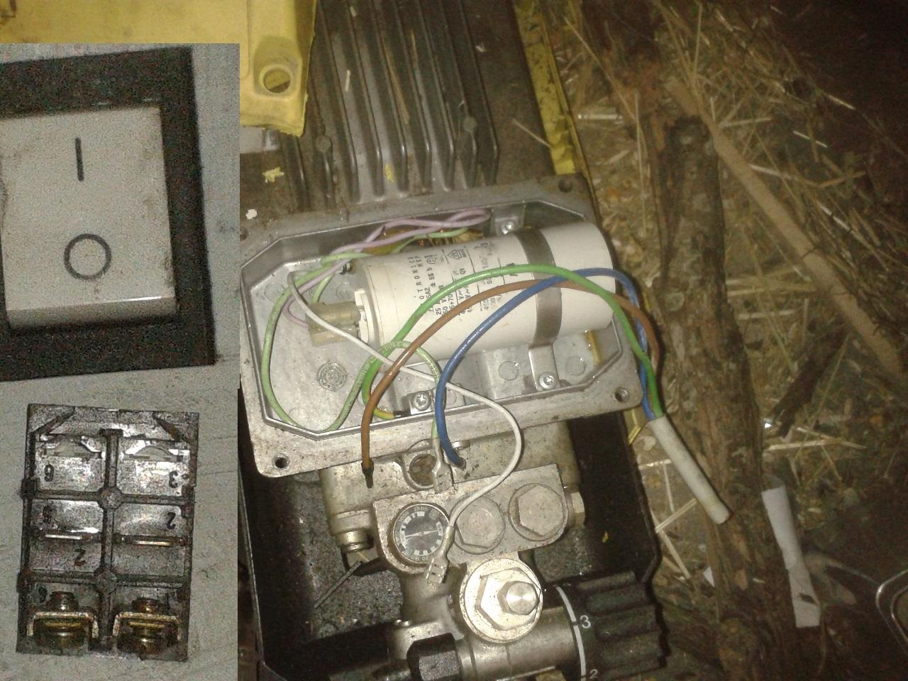

In the meantime I have a different problem. I disconnected a 4 prong rocker switch from a pressure washer pump to get the pump out of its housing. I made a picture of the wiring before doing so but the picture got deleted before I had a chance to upload it. Does anyone kow how to wire this thing back up?
The blue, white, light-green and green wire with the tabs attached need to go on the switch. Back and front of the switch are on the left.

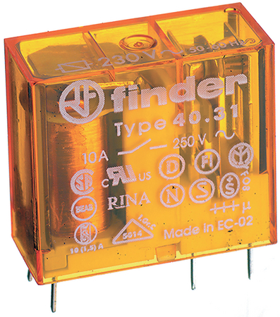

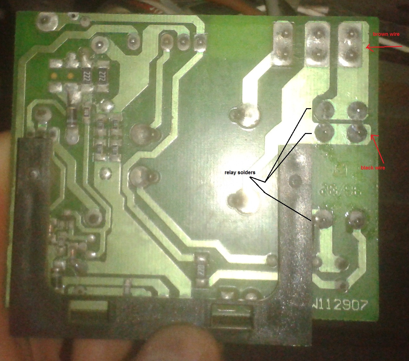

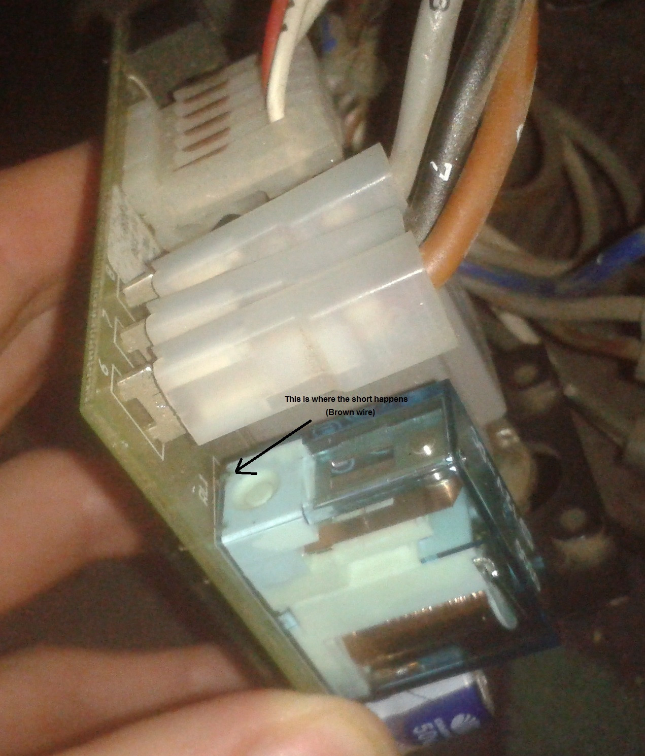

Alright the relay FINALLY came in. I promptly solderd it to the board and turned on the welder, only to be greated by sparking right at the edge where the relay meets the pcb and partly inside the relay, between the most right pin and its opposing twin on the other side of this image. (image not the actual relay, but same pinout) I double-checked the solderjob and it's immaculate, indistinguishable from the other solders. What's going on here...

It's possible that either:
a) the pins on the relay are connected differently to the original
b) you have another fault somewhere.
The first thing to do is to compare the original and the new (and now deceased) relay to determine if (a) is the problem.

The new relay is supposedly only different in that it isn't waterproof. The original is (probably, doesn't say the full part nr, because that would be silly!) a finder 40.61.7.012.0301, the new replacement is a 40.61.7.012.0300, where the zero at the end only indicate waterproofing. On further inspection, the new relay says 40.61s

I'm not so much concerned right now with the specs for the relay. My concern is that it has a different pinout and that this caused a short, and that caused the fireworks.
If that is not the case, then you have another fault somewhere. Perhaps the wirefeed motor is shorted?

How would I test a shorted wirefeed motor? As for the sparks: if I turn on my welder again, the sparks happilly continue. the part where the short happens is hooked up to 230v I think, and the other half of the relay is "isolated" from the rest of the board since it doesn't close (haven't tried the trigger obviously)

OK, if it sparks before you use the trigger then we really need to see pictures. Something is badly wrong.

Ok here are a couple of pictures
PCB and relay
Short point
Solder points
Where the wires lead
