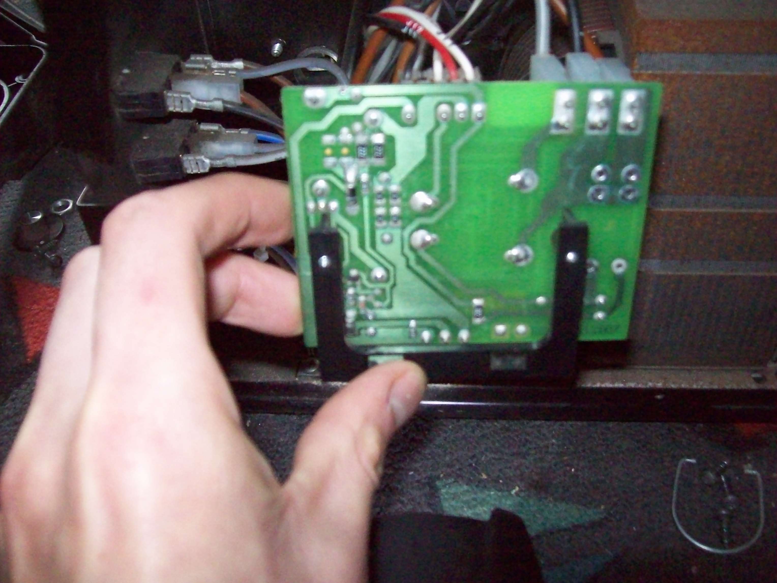

That's a weird place for it to spark.
What I want you to do is to remove the wire connecting to the corner of the board (you have it marked as "brown wire", but it looks more orange to me).
Then power up the device and you should not have sparking -- tell me if you do (and go no further).
Then try operating the feed motor. I believe it should not operate as I imagine the brown/orange wire is either connected to the motor or it is the power for it. You should be able to see and hear the relay operating. Tell me if you do.
And where does the black wire (labelled 7) go to?

Hey Steve, thanks for your continued support :)
I did as you said and removed the brown/ orange wire. When I turn on the welder, the sparking's gone. When I try the trigger on the mig gun, the relay indeed closes.
The black wire labeld 7 goes to the on/ off button. It's a 6 pin rocker switch with 2 wires for 230V, 2 wires for the fan, brown and white going to the transformer and white (labeld 8) and black (7) going to the PCB

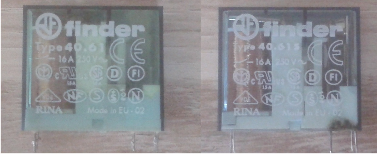

I desolderd the relay and tried again: it's definitely the relay. The terminals read infinite (after thoroughly cleaning them) and the pins on the relay give roughly the same value ( approx. 48kohm)
You can clearly see the short now that the relay is removed (new, shorted relay on right)
*edit* how about only soldering the 2 pins opposing to the shorted pins to the board? Both sets of 2 pins hook up to the same piece of metal inside the relay so the additional pins are only for support/ symetry/ redundancy?

The $64 question is why did this happen.
Was it something on the board, a relay fault, or something else.
The extra pins are there for current carrying capability too. In any case, the plastic is in contact with them, and this burnt plastic is probably where that 48k is coming from.
Now that the relay is removed, I would check with power on once more to ensure that there's no sparking.
Then I'd get another relay.
However a question I have is that if this relay turns on whatever is needed to cause an arc, why is this stopping the wirefeeder? Are we even looking at your original fault?

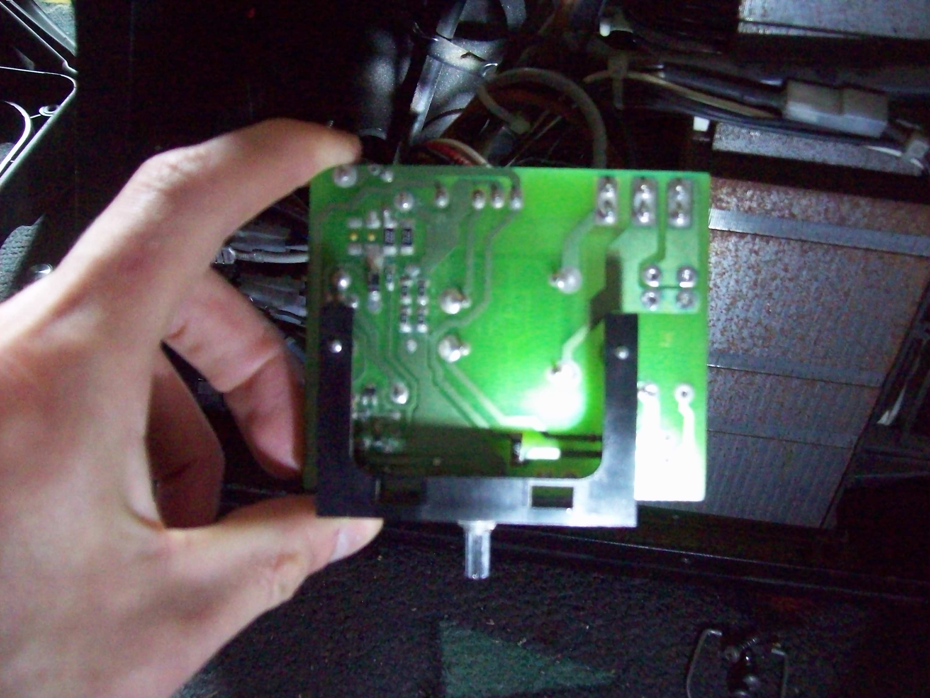

They also seemed incomplete. Metiz, it might be good for you to post images of both sides of the board so I can draw up a partial schematic. It will help me even if you don't understand it :)

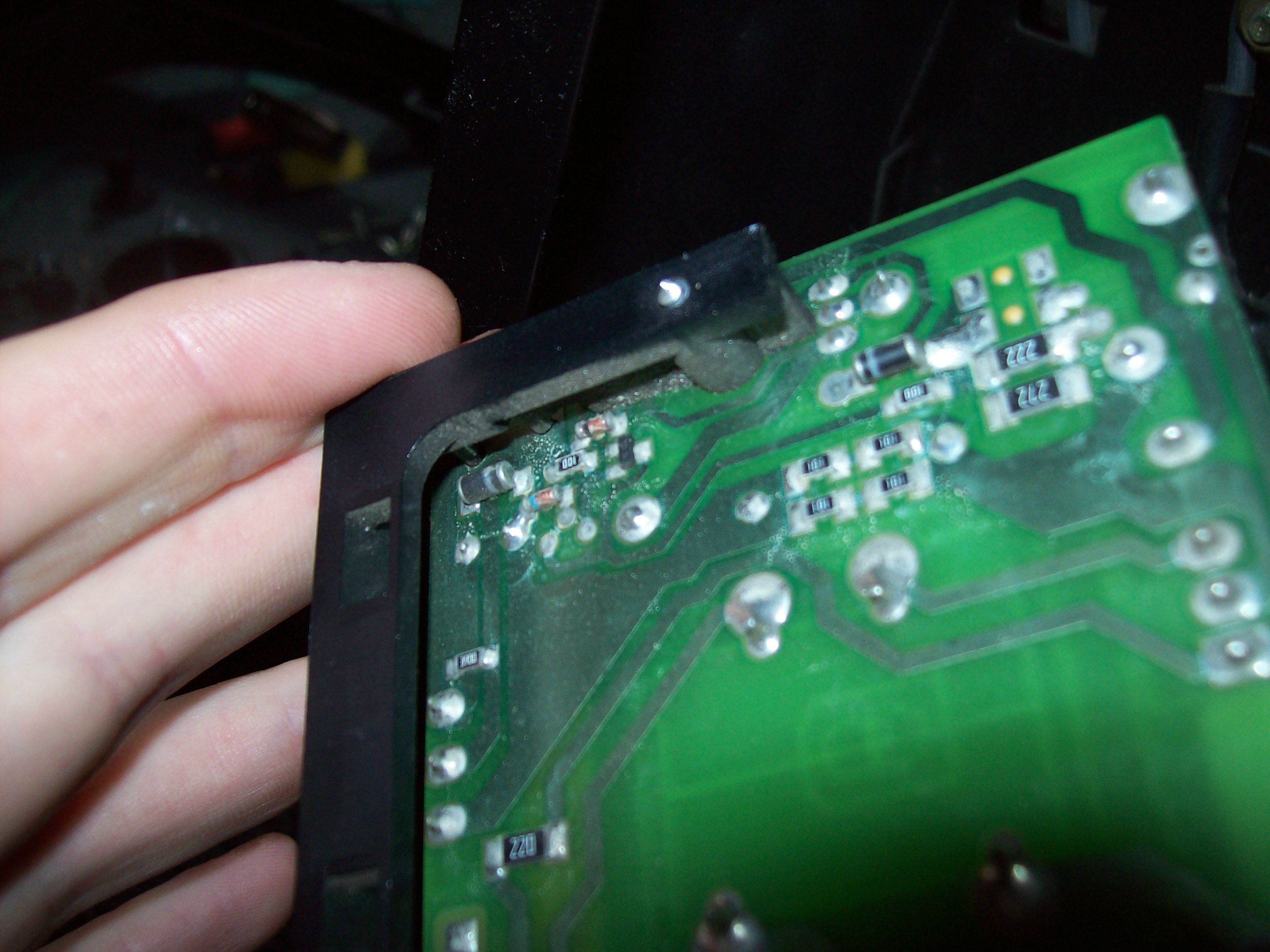

Hooked the wires back up, powerd on the welder and tried the trigger. No sparking. There's a piece of plastic that holds the variable resistor in place that obscures the traces and some components somewhat,
In this picture, the clusters of 4 black...things has "101" written on them. The one just to the top right of these 4 has "100" and the 2 to the right, from top to bottom: 222 and 272. Far left: 3900. top left: 100

I was getting kinda fed up with this whole relay business so I decided to "f*ck around" a bit. I removed the plastic housing from the relay and cut away the 2 shorting pins. I then resolderd it to the board and just tried it...and it works. No short, the relay closes and the wirefeed motor operates like it should! This isn't a permanent solution of course, but at least now I know it was indeed just the relay that died. I wonder what made this thing short. It works fine with 2 pins so the specifiactions are ok too I guess.
So now I need a new relay, and just a new relay. Someone on a different forum suggested a Digikey # Z2839-ND, but this relay works on 380V and only 10 amps. Does anyone have another (digikey) suggestion?

Well done.
It would be nice to find something with a higher current rating.
That relay is a SPDT relay. From what I saw, the original is SPST, Normally open.
This would be my choice.
Here is a list of potentially useful relays. Note that the case style is important, not all of these will fit onto your board (I don't even know if the one I suggested will).
