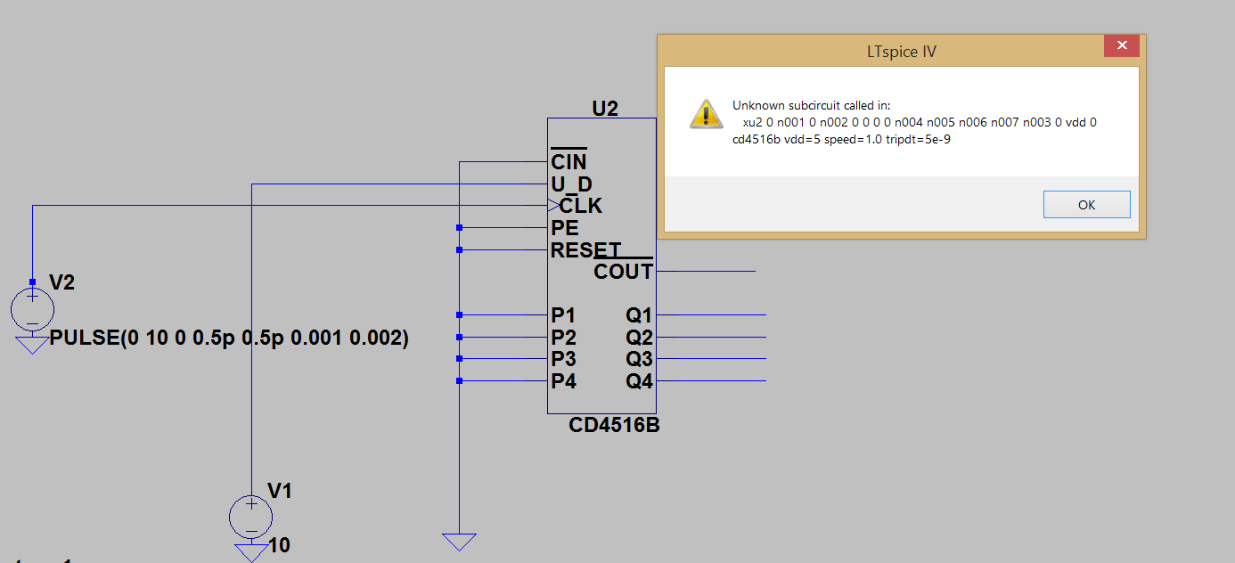

Hello!
Stuck with the simulations again. I'm trying to simulate a binary counter using CD4516. I get an error upon trying to run the simulation, can you guys please help me find the issue?

It seems that you don't have a model (subcircuit) for the CD4516B. As far as I know, LTSPICE doesn't include this model. You need to find one or create it on your own.

I downloaded a large model library from here: http://ltwiki.org/?title=Components_Library_and_Circuits
I tried using 74HC-something counter, but got a similar error. I have no idea how to even start creating my own models. How can I know if a model that is searchable through LTspice will work? Maybe I have a different counter.
EDIT:
http://i.imgur.com/Vk0rFEF.png
I can edit this component through LTspice, doesn't this mean I have the model?

The data your screeenshot shows doesn't make sense. I do not want to download the full library. Can you extract the model for the 4516 from the library andupload it as text file here? I could then have a look at it.

I have two of those

Sorry, these are only the descriptions for the graphic symbol. These are required for drawing the schematic, but not for the simulation.
I should have made myself more clear. What you are looking for (and hopefully will find) is something that looks like:

This is the functional description (here for an NE555) that can be simulated. Such a description for the CMOS counter is required.

Um... I don't really know what I'm looking for, sorry. All I have in the LTspice libraries are symbol files. I can't find anything other than that for *4516 (or *4538 for that matter, that's a monostable vibrator, but this model I can simulate). What is the format of the file I'm supposed to find?
EDIT I guess the file type is .sub? But I can't find .sub's for half the stuff I have already simulated... I'm kinda lost here. Why are simulation programs so god damn not user-friendly?

LTSPICE names these fils *.sub, but that is not mandatory. These are simple text files and can have any extension - as long as you tell LTSPICE the full filename+extension.
If there is a subcircuit for the 4516 in one of the libraries, then you should find it by using the search function of your operating system or simply loading the library files into a text editor and using the editor's search function.

I tried searching using the regular windows search function, I came up only with symbol files. But the thing is, I simulated 4538 a couple of weeks ago, I tried searching for this and still haven't found any sub files, so how the hell did I simulate it?

PS: Found a PSpice model library sitting in LTspice, it has 4516 in it. Doesn't help though... I tried simulating 4516 in PSpice with this library, it says "Undefined" model. Fing great.
D4516B DUAL UP-COUNTERS
