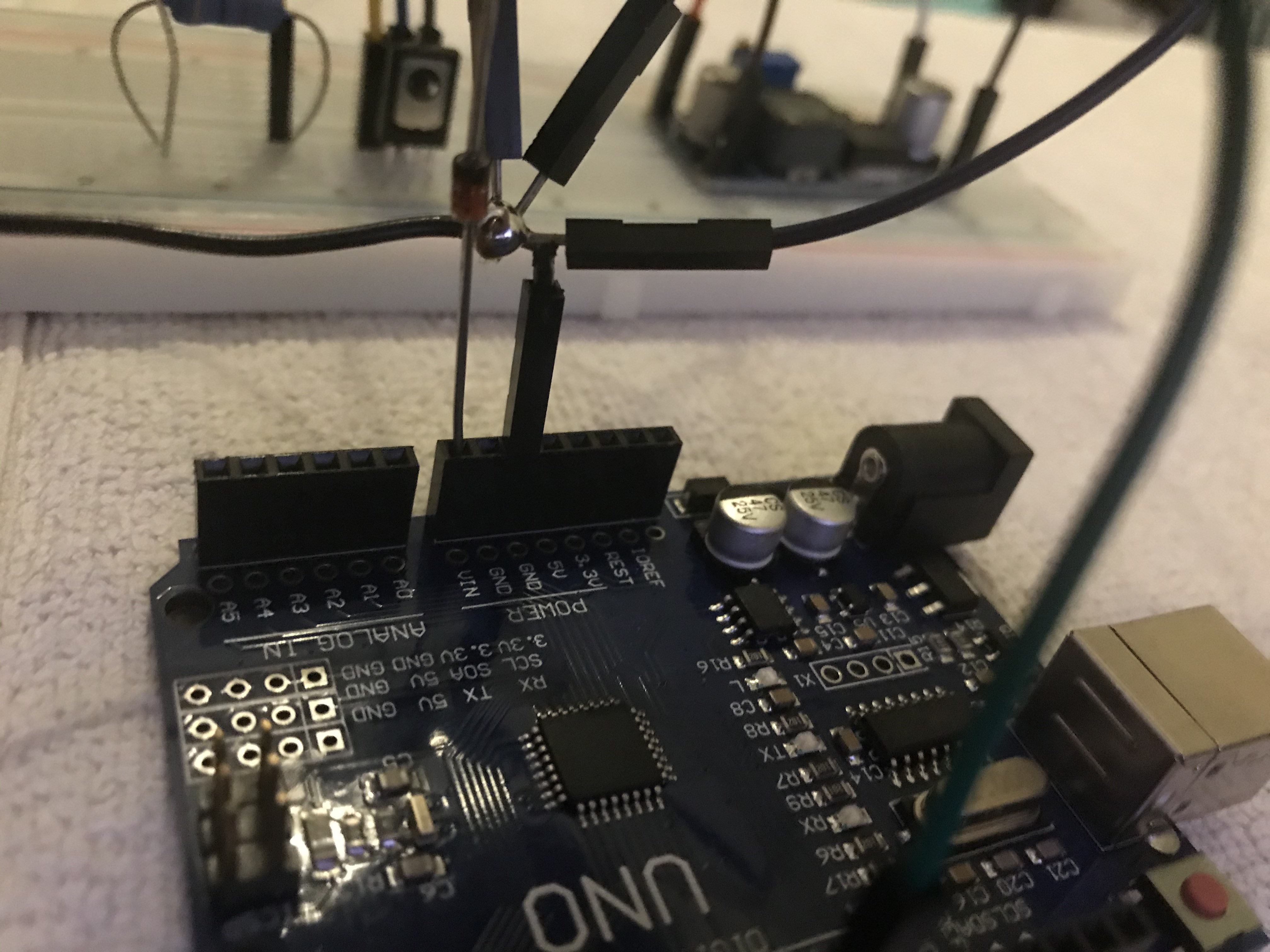

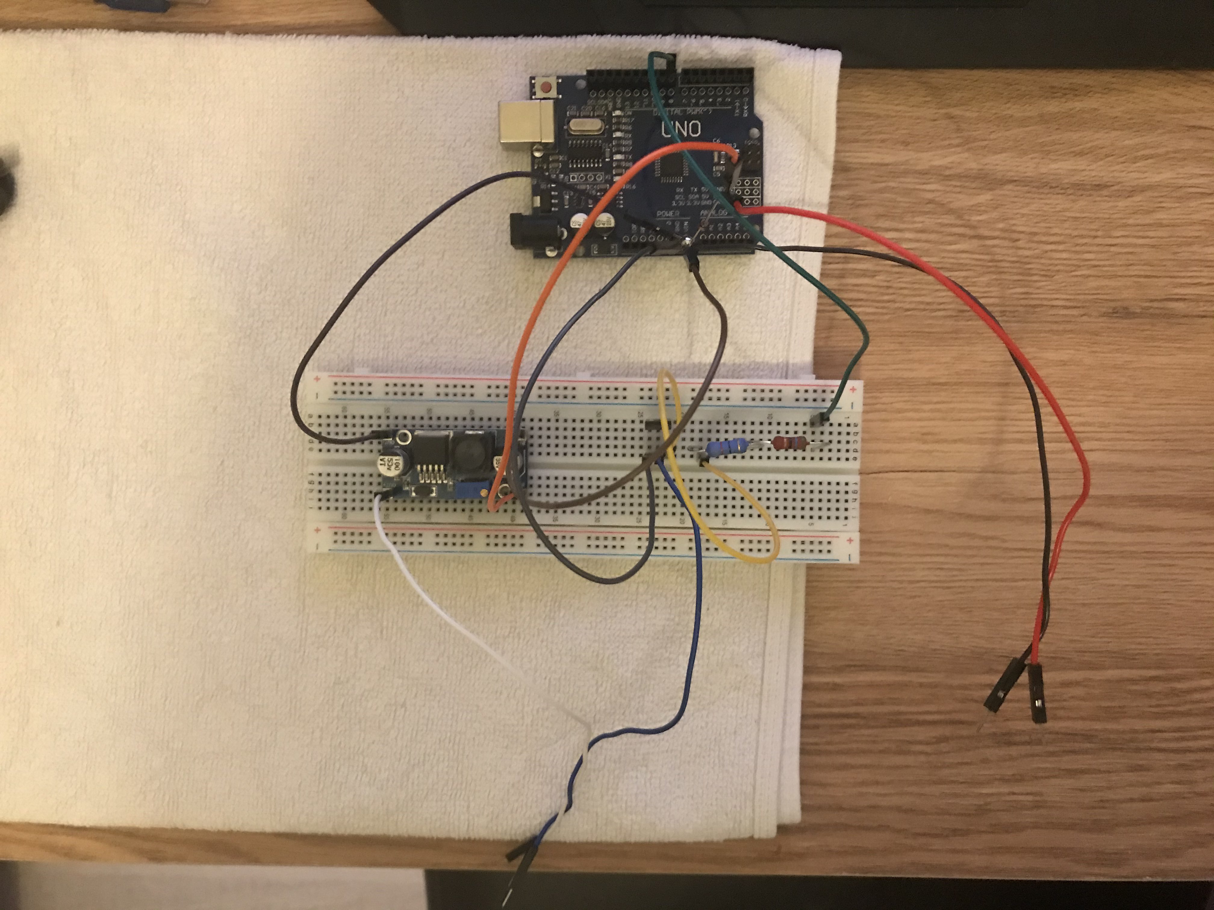

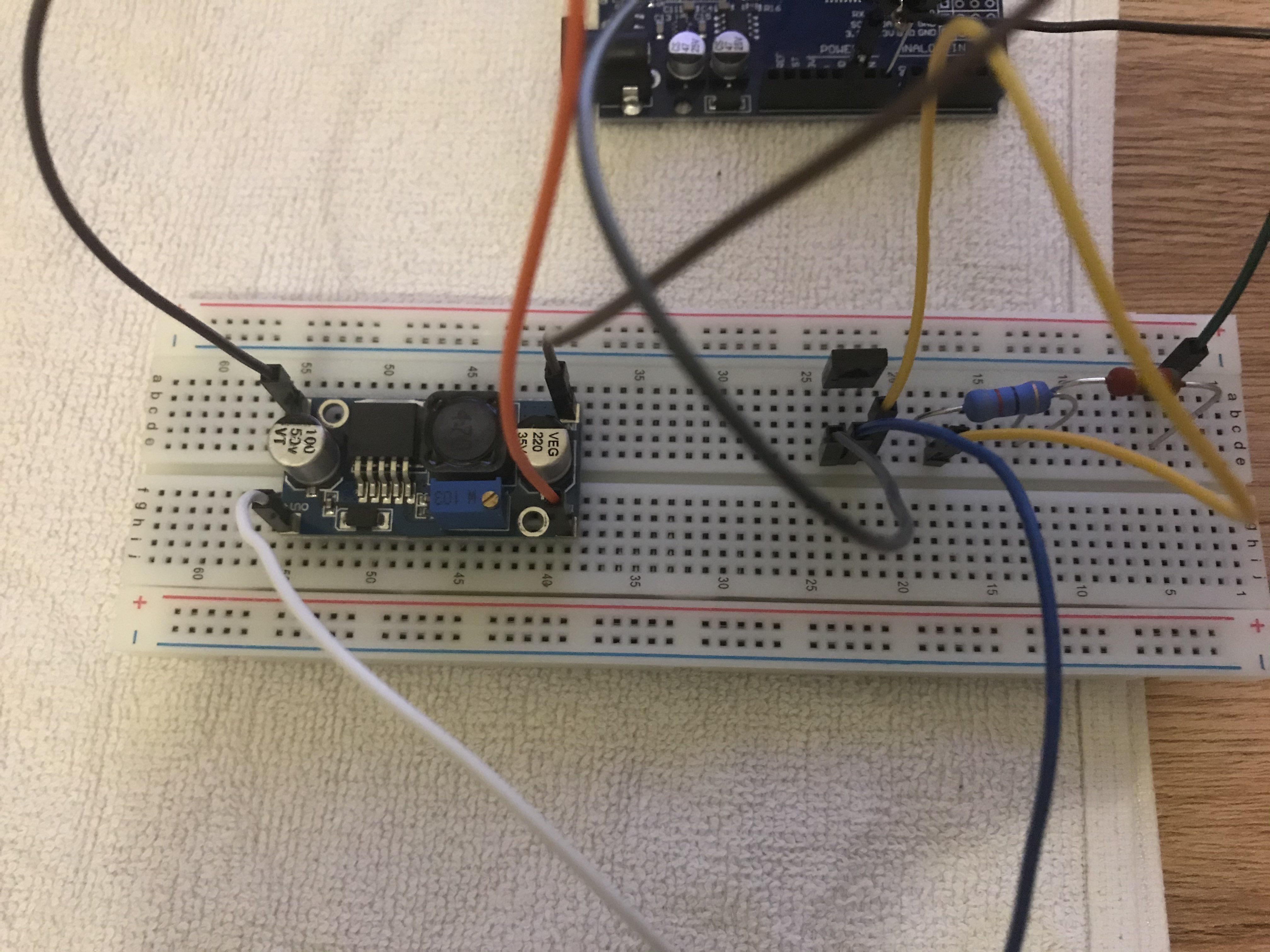

@Harald Kapp Hello. My order has arrived yesterday. I connected everything today. 10-15 sec after the boot, voltage regulator exploded and gray smoke came out. I should have double checked. I falsely connected Ground pin to +in slot of the voltage regulator and Vin to -in slot. :D
I will order a new voltage regulator today.
I can't post the photos. Website says "There was a problem uploading your file.". So I will post the links:
https://cdn.discordapp.com/attachments/929757506266353684/931116754950815804/IMG_1352.jpg
https://cdn.discordapp.com/attachments/929757506266353684/931116753658982430/IMG_1354.jpg
https://cdn.discordapp.com/attachments/929757506266353684/931116754099380224/IMG_1356.jpg
Maxouishere
Dec 29, 2021
78
Dec 29, 2021
78

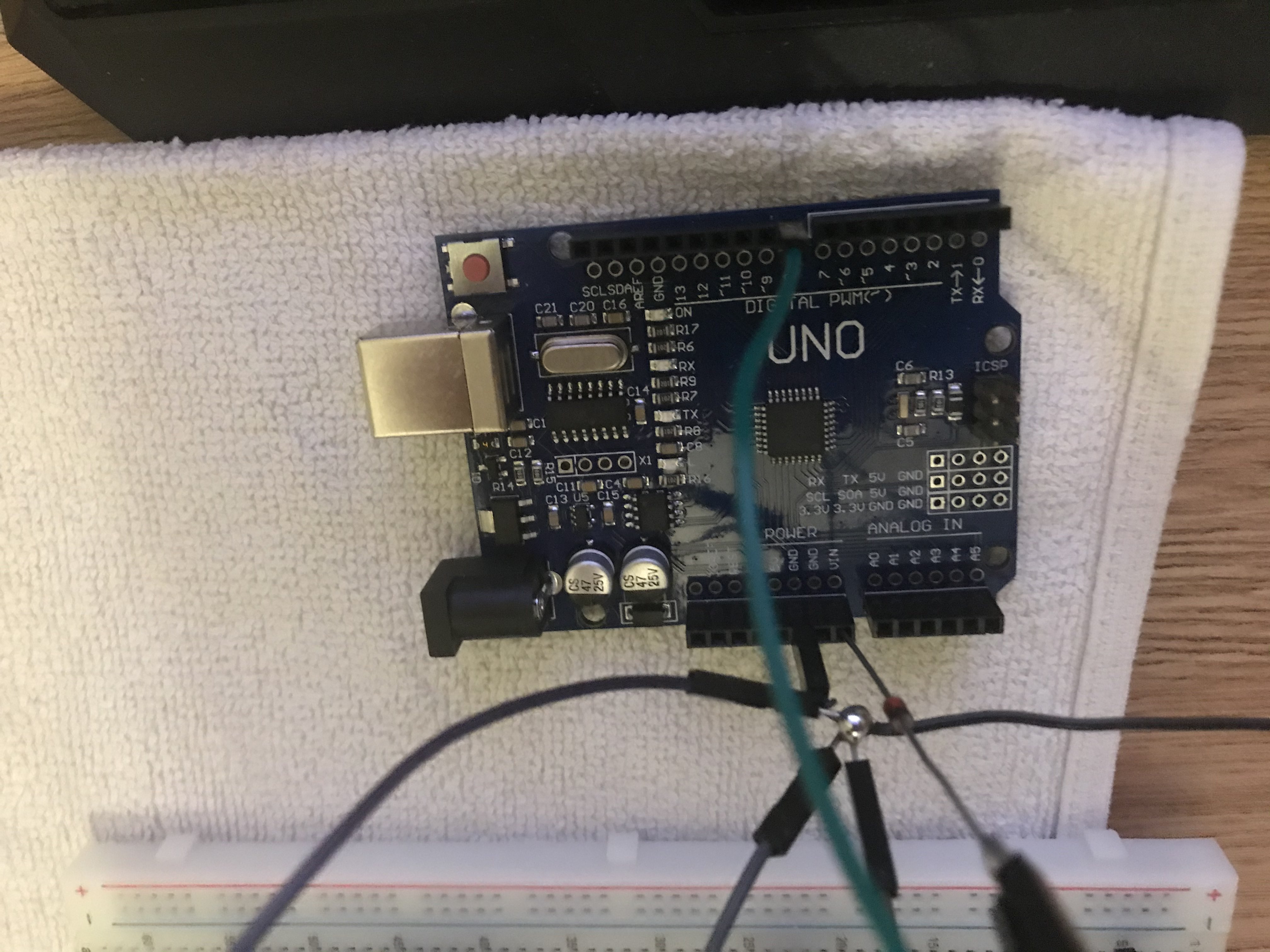

@Harald Kapp Hi. I just tried again with the new voltage regulator. Arduino booted, I read the voltage 0 on multimeter. I remove the cables from battery then tried again. Arduino did not boot this time. There were no smoke or anything. It just stopped working. I think zener diode is burnt because I read 0V on the anode side. But no problem at cathode side of the zener diode. Also Arduino boots If I directly connect It to the battery via Vin. I will order zener diodes now.
I connected everything the same as in post #32 except I connected +in and -in of the voltage regulator correctly this time. (I added photos below.) Why do you think it burnt? This might be a side effect of what had happened yesterday (explotion of voltage regulator)?
I will also order TIP120 but I can't find one. I found TIP122. Is it OK?
BTW, zener diode was 4.7V and It was advertised as good up to 1W.

Can you post a schematic drawing of yur circuit? Hard to read from the actual setup (although your photos are good quality, this is not the issue).

Hello,
What is the type number of the zener diode?
It more looks like an 400 mW version.
