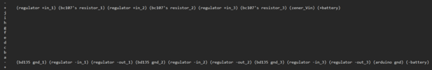

Thanks. Current is fine. Only problem(?) is non zero voltage when off. I thought it was a problem because 4 outputs show 0V when off and only one of them shows 0.8V now. Can it be a problem due to wiring order? Yesterday It was the same problem with my 1 output demo system where I test components. Then I changed the random wiring order like the image below (breadboard) It then showed 0V when off.
Wiring order matters? If so, let's say for 3 outputs, image below is OK?

Current is fine.
What do you mean by that?
No, not a problem. As soon as you start drawing current from a logic chip's output, the voltage rises above 0 V (for low level) or goes below Vcc (for high level). This is due to the finite output resistance of the chip. THis is why you need a driver for higher output currents.
Your images I don't understand. I see only black boxes with text. Please provide a schematic drawing.

I tried to draw the schematic with breadboard. Same transistor-resistor-voltage_regulator setup is also applied to pin,3,4,5 and 6. So that means 5 outputs total. I didn't add them on the image below because it becomes too complicated to draw.
Now I measured again the voltage at the end of the blue lines. I made 2x setup with 5 outputs each just to see if they differ. On first setup, one output is measured 350mV when pin is set to LOW and other four are measured 0V when set to LOW. On the second setup all five outputs are measured 150-250mV when set to LOW. (But 24hr ago all of them were 0V when off.) I also measured the voltage from the arduino pins directly, It drops to 0V when set to LOW. And bases of both transistors voltage also drop to 0V when set to LOW and around 1.8V when set to HIGH. If it is not related to wiring order (for example at above image, for negative terminal it is connected from right to left, -12v,-in,-out,arduino_gnd,bd135_gnd), I suspect it is something to do with the voltage regulators' internal circuitry.

@Harald Kapp I built one more, on this one when Arduino's pins set to low, 4 of them show 6.8V, one shows 12.2V. Please check my above schematic and tell me what I am doing wrong. I couldn't figure it out.

It's an effort to decipher a circuit from the wiring, especially as the symbols for BC107 and BD135 don't match the physical appearance of these components.
It will be much easier for us when you present your circuit as a schematic diagram.
Also, in case you can't draw a schematic as requested, at least use red for positive supply wires, blue for negative supply wires (gnd), otehr colors for signals. Also label any signal/wire that you reference in your text. It is much easier for us to follw e.g. a signal named "output" than to fin a signal that "connects to the collector of the second NPN transistor" - just an example).
For the time being: check the correct placement and assignment of the transistors and their pins (E, B, C).
Please be more specific. Ideally mark the measuring points in the diagram with lables and reference these lables in your text. The blue wire (in fact any wire) has 2 ends. Which one do you mean?
12 V on an Arduino output? Your poor microcontroller sure is fried. Check your zener diode, is it correctly oriented (cathode to +12 V)? Check your ground connections.

@Harald Kapp I find the problem, transistors are fried due to reverse connection of +in and-in. (mistake :))
In your post you said i need a driver. Does my current setup (only difference is 138 ohm res value is increased and is conencted to 12V, and same setup for 5 pins) is OK? I don't want high current. Only high voltage (around 30V). Is it OK, if I leave it like that?

Ohh. I thought I should have to add a diode like in the link. Alright then, It looks fine.
