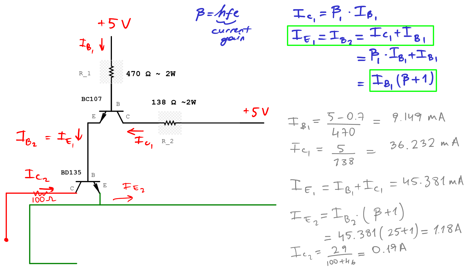

place a series resistor between the collector of the BD135 and the grid, e.g. 100 Ω to protect the transistor from overcurrent.
Would doing this also reduce the current on the grids? and is 100Ω ~20W overkill?

Hello,
What is the supply voltage for the BD135?
At 29 Volts, the current with the 100 Ohms resistor will be 29 Volts / 100 Ohms = 0.29 Amp.
The power in the resistor will be 0.29 Amp X 29 Volts = 8.41 Watts.
Hello. Judging from the schematic in the post #82, I think It looks like 5V but I'm not sure. It looks like 5V signals comes from pin_8 of Arduino through BC107 to BD135. But I'm no expert :)
Should I also add the grid's resistance? 100Ω resistor will be connected in series to a grid system which is made by resistance wires, 2nd schematic in post #83. 29V / (100+46)Ω = 0.19A where 46Ω is the R_eq of the grid system. Therefore P = 0.19A * 29V = 5.51W, right?
The calculations can be done with this wheel:
Thank you for this and excel file above. Very useful.
@Harald Kapp If I want to keep the current same or even more after adding that 100 Ω~8W resistor at the collector end of the BD135, should I reduce the 138Ω resistor's value which is at BC107's collector end? Also, If I make the wires around the frame so tight, so that they won't be able to make + and - touch each other, do I still need that 100Ω resistor?
I tried to follow a Youtube tutorial to calculate the values at the ends of transistors but It doesn't seem correct:

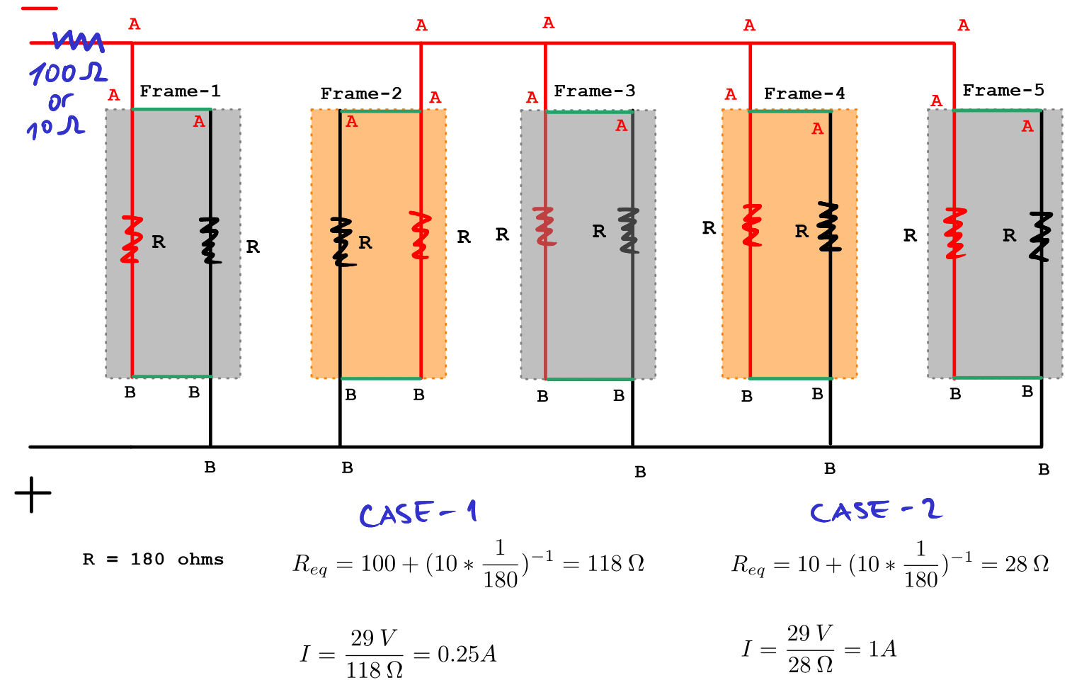

In datasheet of BD135 it says that max collector current is 1.5A What should I do to achieve at least 1-1.2A current? I assume I need a heatsink at that level of current. I built a new grid system. now each wire (10x) has 180Ω resistance and all connected parallel as below schematic:
@Harald Kapp You told me to add 100Ω resistor. Can I connect 10Ω 8W resistor instead of 100Ω 8W to keep the current above 1A or is there another way?

In case of a short circuit the worst case is that only the current limiting resistor is in the circuit. You will then have 29 V across this resistor Rlimit. IF you want 1.2 A through that resistor, you have
Rlimit = 29 V / 1.2 A = 24 Ω (rounded).
Power dissipation in the resistor can then be as high as
P = V²/R = (29 V)²/24 Ω = 35 W.
With 10 Ω the max. current in case of a short circuit is 29 V / 10 Ω = 2.9A which is almost twice as much as the rating of the transistor says.
Thank you so much for the clarification. I was making a huge mistake by summing R_eq of the grid and 100Ω.

When you use the DB135 as a switch, power dissipation will be low:
Assumin a max. ICE of 1.25 A (the limit of the transistor), the collector-emitter saturation voltage VCEsat will be 0.25 V worst case (datasheet).
The power dissipation is then PCE = ICE × VCEsat = 1.5 A × 0.25 V = 0.375 W.
Add the power dissipatin from the base-emitter junction PBE = VBE × IBE = 1 V × 0.03 A = 0.03 W.
The total power dissipation is then 0.4 W worst case (rounded).
The thermal resistance junction-ambient of the transistor is 100 ° /W. A power dissipation of 0.4 W will therefore increase the junction temperature over ambient by delta-T = 100 ° /W × 0.4 W = 40 °. Even when the transistor is operated in a hot environemnt, say + 40 °C, the junction temperature will be at max. 80 °C, way below the allowed 150 °C (max). Therefore no heat sink is necessary.
The heat sink you propose has a thermal resistance of 30 °/W. Add the thermal resistance junction-case of the BD135 you get a total of 40 °/W. The temperature rise from the dissipated power is then only delta-T = 40 °/W × 0.4 W = 16 °. This heatsink is absolutely sufficient in this switching application.

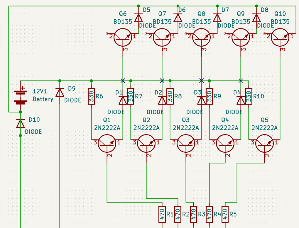

@Harald Kapp Hello. I was reading about diodes and I wonder If I need them on the build with multiple outputs as below. Or is it not necessery in my case?:
I couldn't make it work with only one but this does not mean device is not working. I better test it with at least on 5 unit at the same time of day, simultaneously, to see if the problem is device or not.
Harald Kapp
Nov 17, 2011
14,317
Nov 17, 2011
14,317
I see no diodes in your schematic. What are you talking about?
