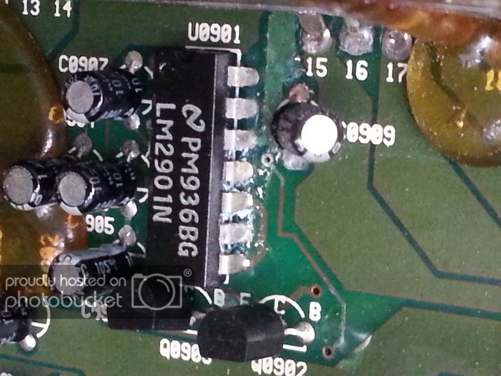

I found oxidation on what I assume is the power amplifier board by a 14 pin quad comparator LM2901N - the corrosion was found underneath and what seems to be a burnt out diode?
Should I attempt to replace the diode and IC?

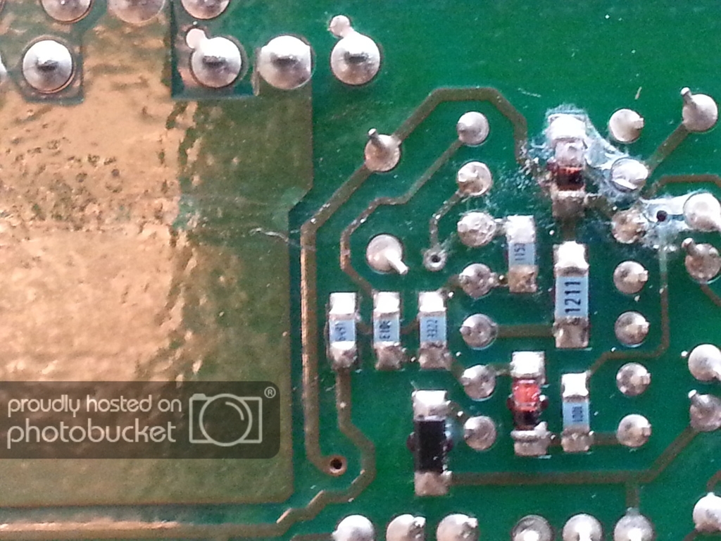

This pict. is directly under the IC - the 'burnt' diode is top right. It looks like it was a red glass barrel type smt diode, similar to the lower one.

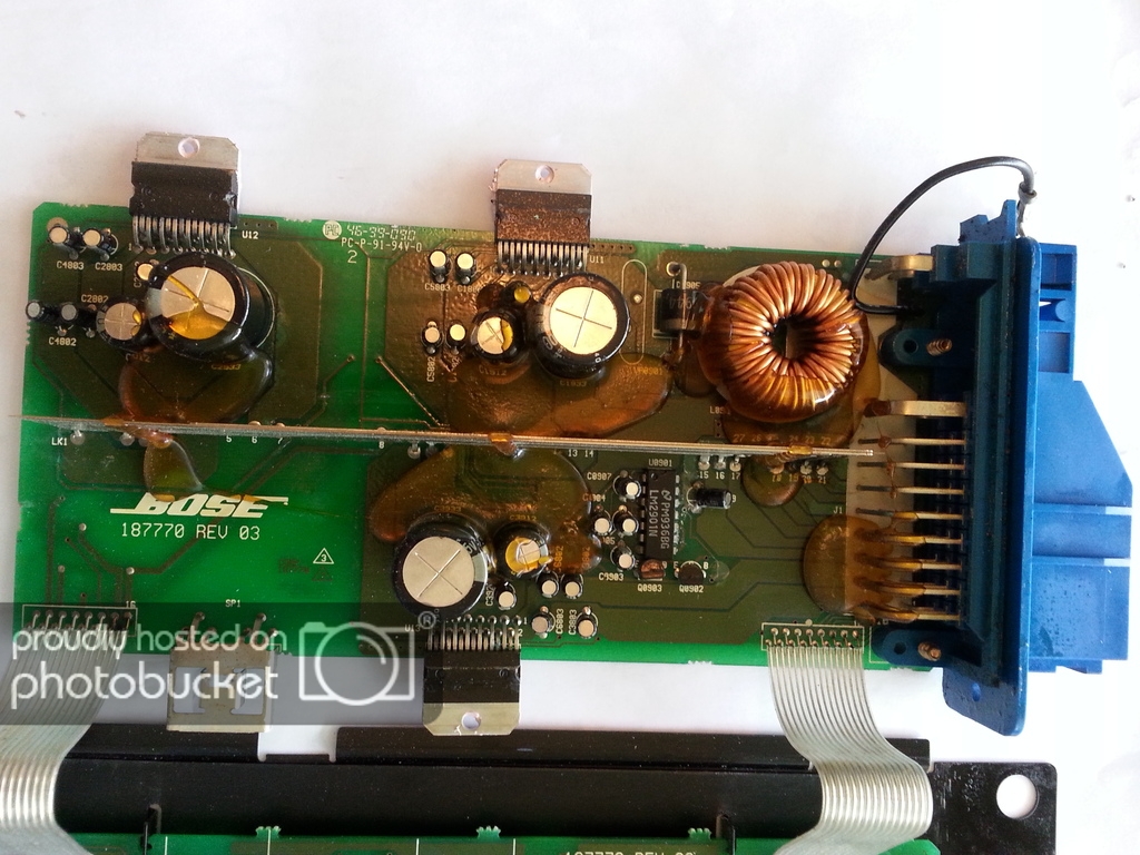

Here is a complete shot of the 'power' board

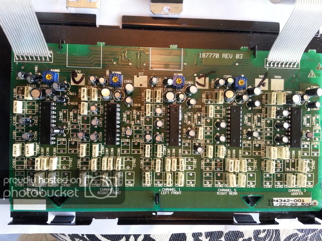

Here is the board that is attached by those thin wire ribbons - I assume it is the audio processing board, as there are 5 IC's and there are 5 channels to this system.

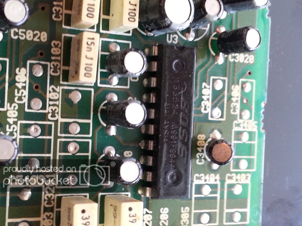

A close up of the above IC is marked Bose.

Hi John
I would have a little clean first with some PCB cleaner. Might not be anything wrong with the IC or diode. Then have a look and replace if you feel it needs it.

Thanks Adam, I did test the diode that I thought was faulty on the back side, it measured the same as the other diodes nearby, about .5 V in one direction. Good advice, it may just be the corrosion causing the issue!
