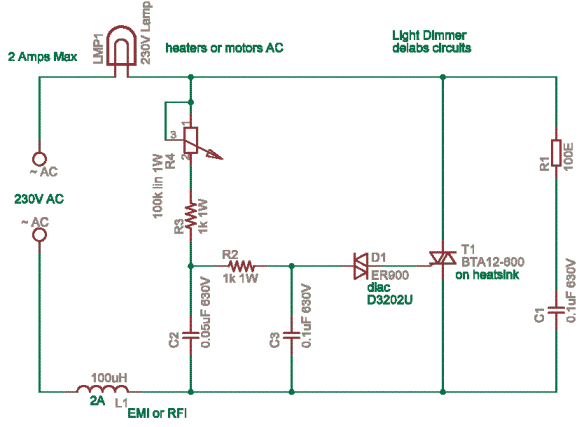

Would this schematic work for motor speed contol ?

That circuit employs a Triac and even Triac control finds limited use as I've described. What are the motors driving?
