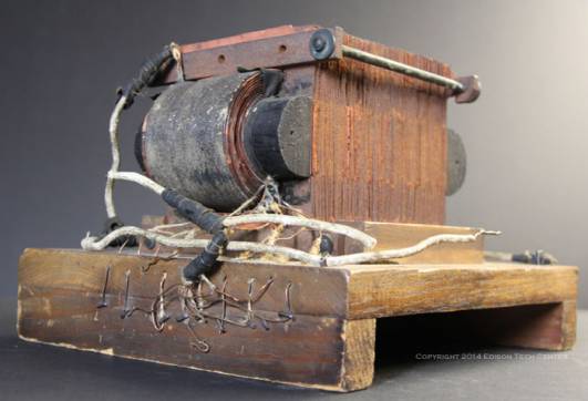

Build my own step up transformer 1800s style to power tesla coil ?

I would like to build a transformer with a power output greater then what I would get from a typical neon sign transformer 30ma instead 300ma or 1kva would be cool .
Looks so easy, just put a bunch of turns on one side then more on the other but its not. My attempts just got real hot and transformed little.
I had the electricity bug bad as kid and still do but as you can tell by my posts I really just know the basics, where to start ?
